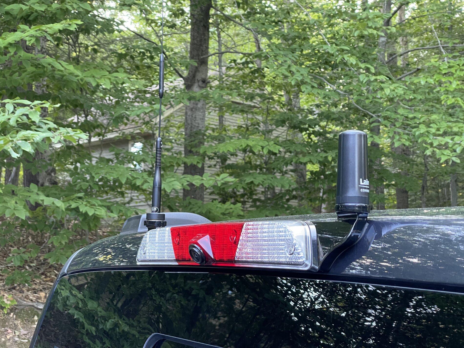

I'm installing an Icom F5061 (Part 90 VHF) in my rig. I'm a volunteer firefighter and sheriff's dept search and rescue volunteer.
Plan so far: (* need advice on last two items)
Comet no-drilling Front fender bracket FO4ANTNCG
Diamond NMO mount C213S-NMO
Comet 16" small NMO VHF/UHF antenna (going a bit for stealth vs range) SBB-1NMO
These are installed and I painted the bracket black.
Builtright Pro dash top mount, for radio faceplate (no balls, mounted direct)
3D print a right angle extension bracket for the mic-holder to fit the dash top mount next to the faceplate.
Radio brick under/behind one of the seats *
Power from not sure where yet*

I am planning a very similar build. Currently waiting for parts to arrive:
NCG FO4ANTNCG mount [Same as yours]
Comet CK-3NMO
Comet CA-2X4SRNMO antenna
+ NMO-5 cap
For the radio brick, I am planning just to use some velcro to put it under the driver's side seat.
For the power part, I am going to use a 25W max radio, so I can safely use the cigarette lighter (7A). But your rig is 14A max; I will draw power from the battery directly with a low-voltage shutoff, just in case.
Have you tested your antenna setup? My main concern during my research is the isolation between metal vs. grounding. Did you use any additional coating/plastic washer during you mount installation?

I also have a couple of the 2X4SR antennas, they are great. I'll probably keep on in the rig just in case.
re grounding, this is very interesting. The FO4ANTNCG is designed for the F-150 and has a layer of insulation (clear tape of some kind) under the bracket to prevent bi-metallic corrosion, as recommended by Ford. But it does also ground the bracket via the bolt from the fender, to the TOP side of the bracket.
I do need to put a meter on it and check the ground.
The NMO mount I used on the bracket does ground directly to the bracket via a big star washer.

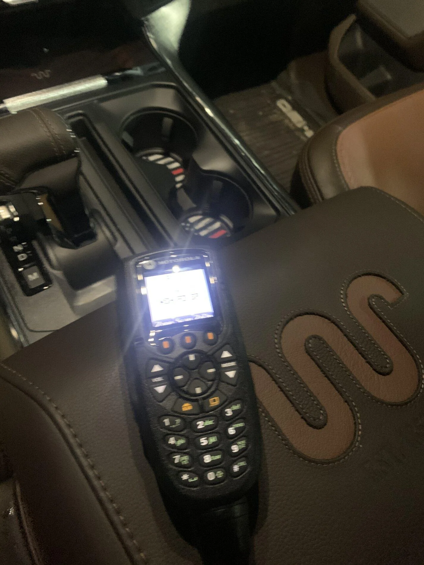

I'm overdue for posting an update.
I installed the Builtright Pro - I use modelling clay to mark where to drill the hole (instead of using painters tape, so was a lot more accurate, otherwise follow their video.
I got a longer cable for the detached head unit and mounted the head unit on the Builtright Pro, put a notch in the console top trim (2nd and 3rd pic) and ran the separation cable down the console and along the left side, need to figure out to get down and under the rear carpet to behind/under the rear seat to mount the main radio box there.
Still need to punch through a firewall harness grommet near pedals to run power and antenna cable.
Big thing I did was 3D print a PETG mounting block to keep the mic holder up and out of the way, only to discover that on a hot day the interior temp of an F150 is above the glass transitient temp of PETG, so it drooped. I'm going to reprint the mic bracket in ASA.

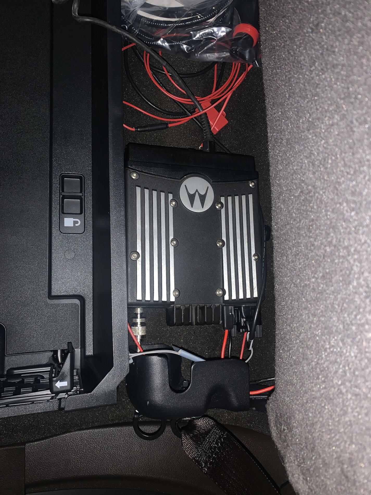

Have I been going slow on this!
But here's an update. I designed and 3D printed a bracket to fit behind the underseat storage box and take the radio. Green color is just a draft print, final will be in ASA.
Got the power and antenna wiring as far as B pillar, stillneed to get remote head cable from the console to the back seat. The center console is difficult to deal with!

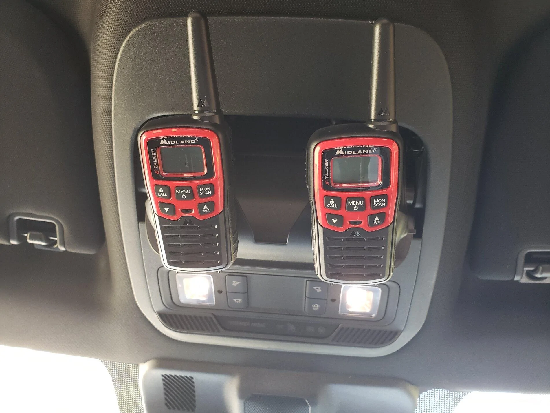

Doubt I will need or use a radio much in this truck but I wanted the option to easily carry one for road trips so I did this.
