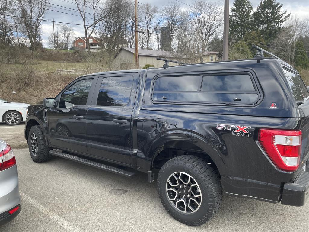

Update....cap was replaced under warranty and the new cap also leaked. My dealer went above and beyond trying to make it right. He wanted to give me a full refund and send the second cap back. This would have left me looking for a new manufacturer and dealing with new lead times, invest more of my time driving around for install, etc. So, I decided to keep the second cap and fix the leak myself.
If anyone has a Leer with a windoor slider; the slider rail is not sealed on the ends where it attaches to the window frame. This means if you are parked on any slope the water will not drain via the weep holes in the frame and water will come into the cap/bed. I solved the issue with some butyl and fixed 90% of my problem. The weep holes are not at the extreme ends of the frame so water can pool up and drip into the bed.
My advice to anyone looking for a fiberglass cap, stay away from Leer. My dealer is actually dropping them since he's tired of dealing with issue after issue from them. Low quality control. Second thing I've learned talking to dealers of ARE and Jeraco, the overall quality in the industry is low. We're paying $3500 for caps with too high of expectations I was basically told. Fisheyes in paint, uneven gaps, some leaking water, and even poor fitment are all par for the course for the industry. The ARE dealer actually told me the company only expects the paint finish to be acceptable for the areas of the cap you see when standing on the ground. So the roof could be full of fisheyes, dirt, fingerprints, etc and ARE would consider that acceptable. I was stunned.
Overall, the cap looks great but the experience was very, very poor.

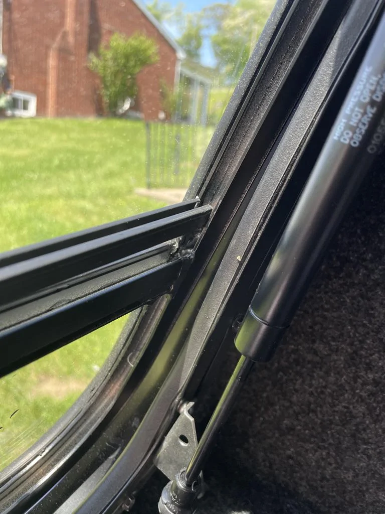

The issue I found is the track for the sliding windoor window is not sealed to the ends. So, instead of water using the weep holes in the track it prefers the ends where it flows down to the channel of the window frame. The leak is most noticable inside the cap when truck not parked level. As a fix, I opened the weep holes in the sliding window track (the plastic liner), added some butyl to seal the end of the track and finally drilled a hole in each corner of the windoor frame. It seems the weep holes in the slider are not close enough to the ends so water pools up in that channel and runs over into the frame even with the ends sealed.
After drilling the holes I have not seen any further water getting inside.
