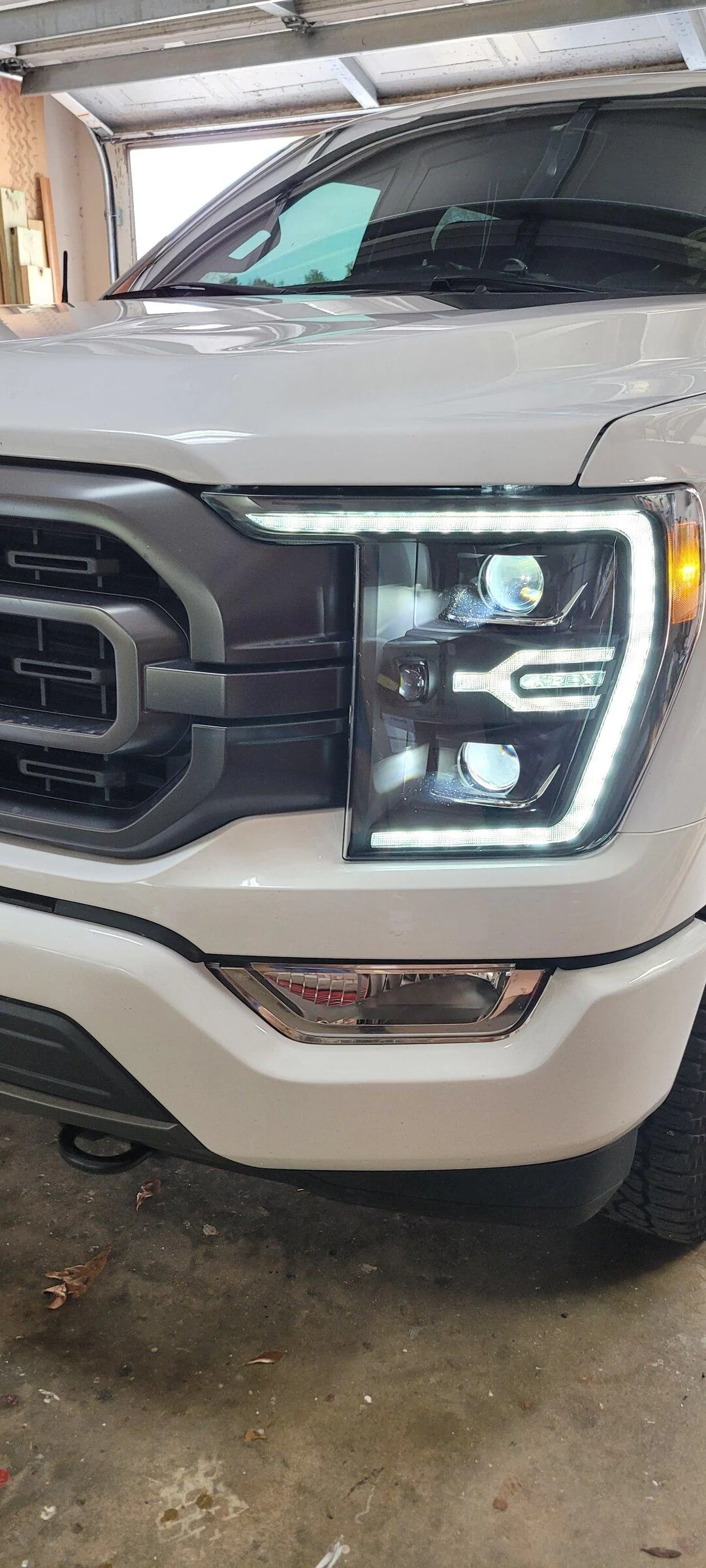

Finally some pictures of the LUXX headlights mounted on a truck. These have the light activation feature when unlocking.
Pro model does not have activation feature and the NOVAs haven't been released yet. I placed my order last night for the LUXX and they'll be here this Friday.

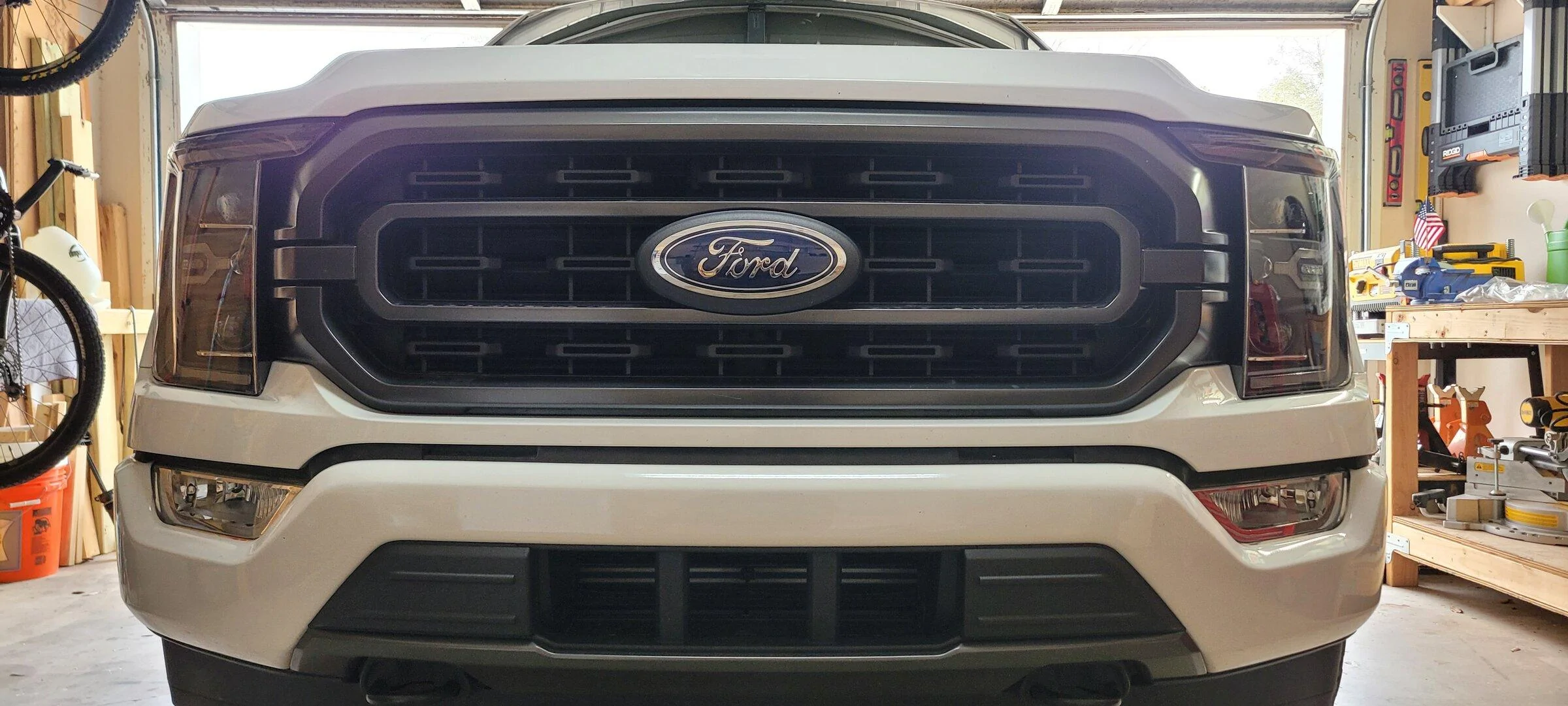

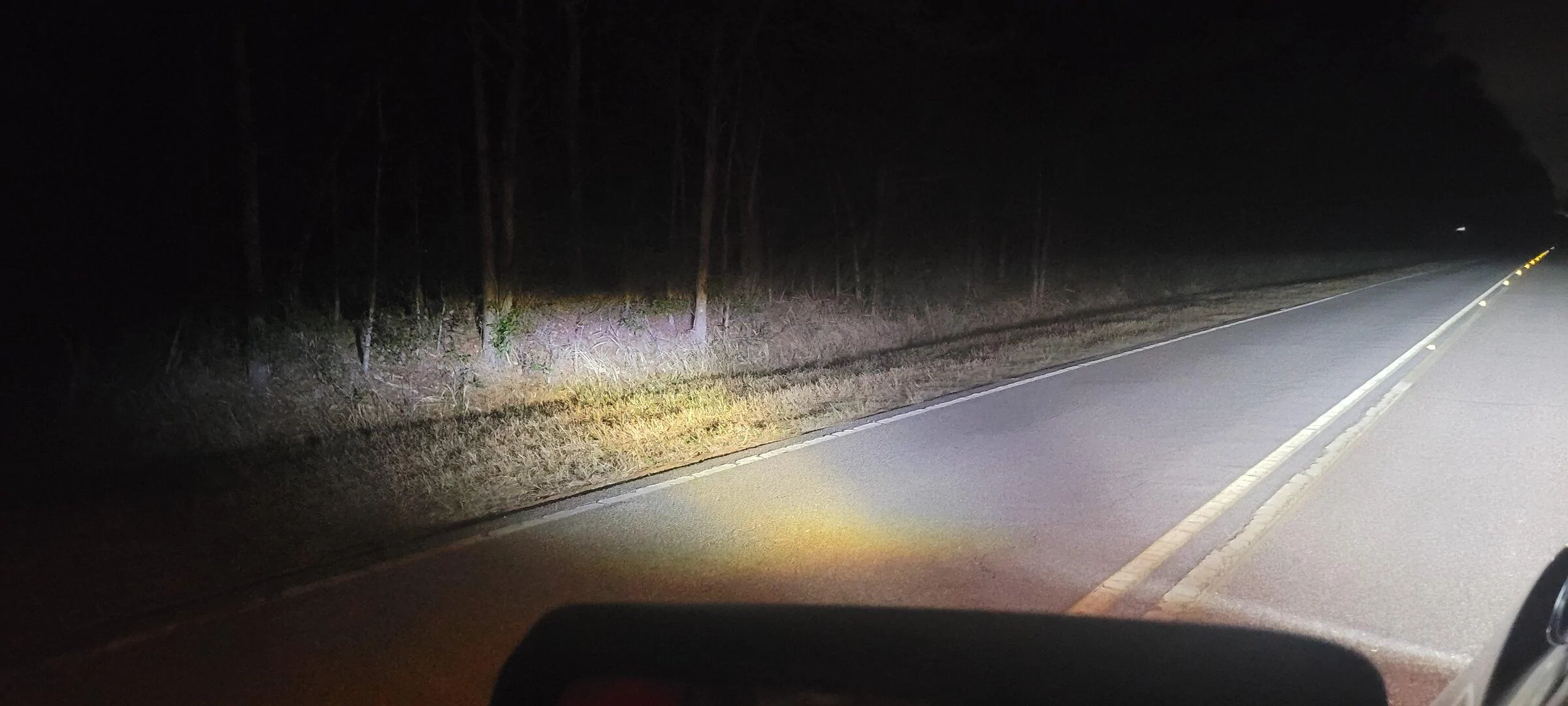

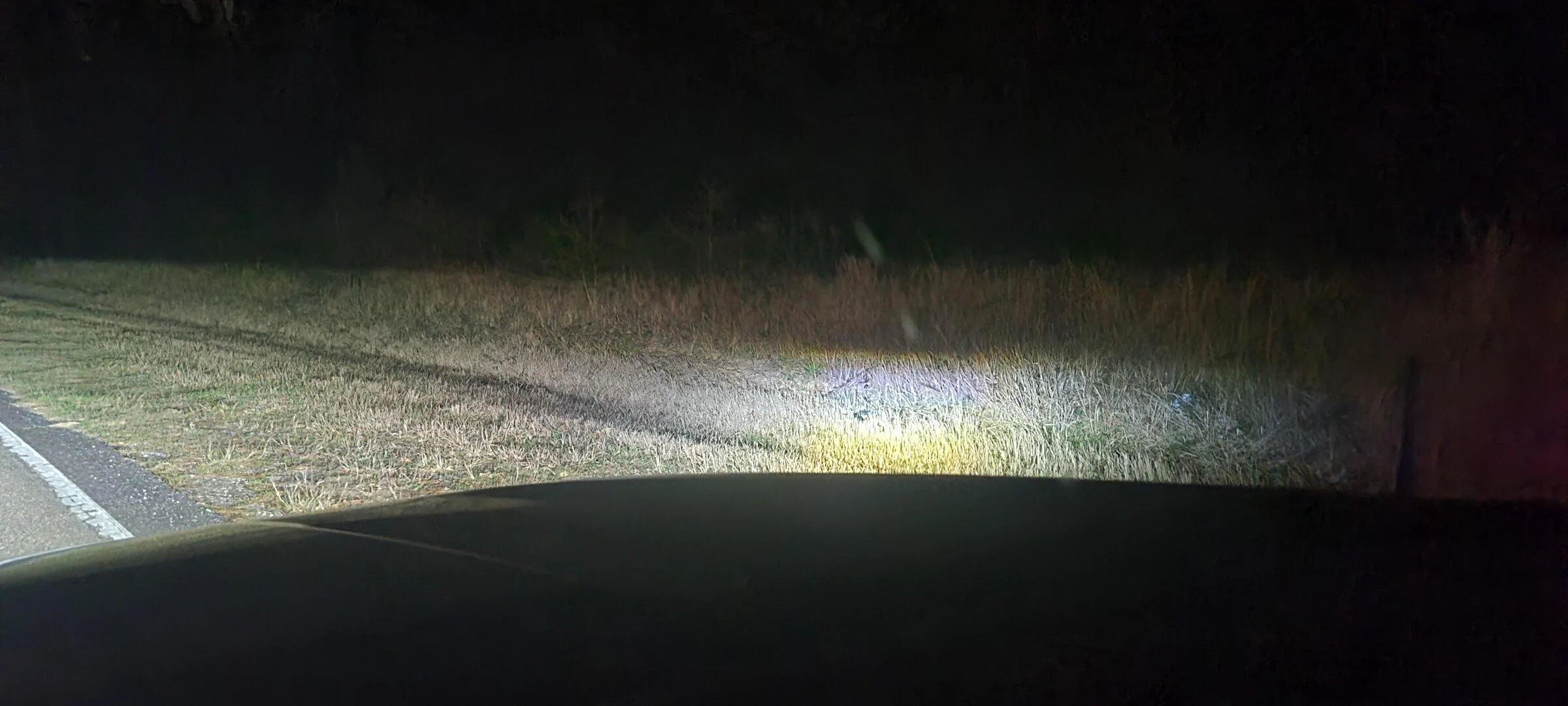

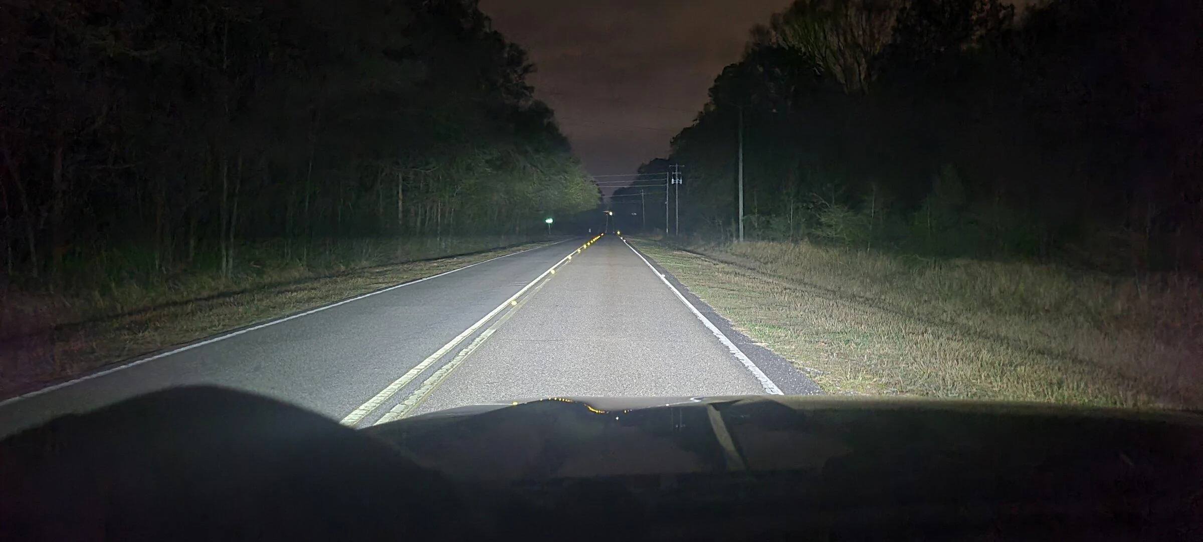

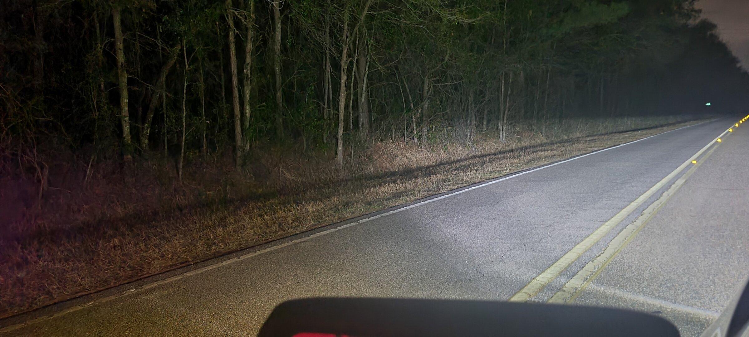

Cutoff line..sitting about 25' back off the wall. When driving they seem just a tad low so I'm going to raise them a little. If I start to get flashed by other drivers I'll bring them back down a bit.
Cutoff line
Ford F-150 AlphaRex LUXX Headlights 20220226_210837
Lows w/ fogs
Ford F-150 AlphaRex LUXX Headlights 20220226_204643
Lows/Highs no fogs
Ford F-150 AlphaRex LUXX Headlights 20220226_204638

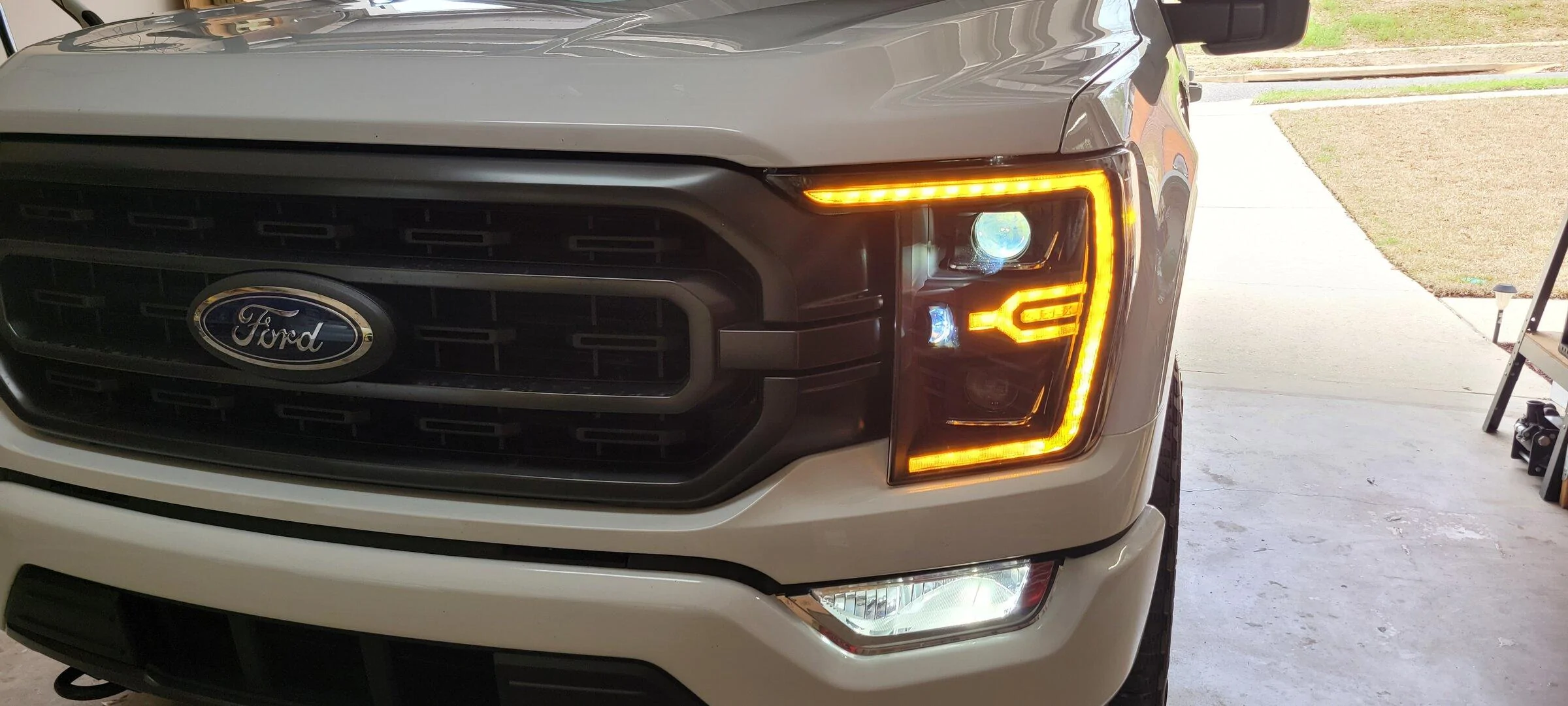

No turn signal light assistant (driver side)
Ford F-150 AlphaRex LUXX Headlights 20220226_204702
Turn signal light assistant (driver side)
Ford F-150 AlphaRex LUXX Headlights 20220226_204709
Turn signal assistant (passenger side)
Ford F-150 AlphaRex LUXX Headlights 20220226_204732

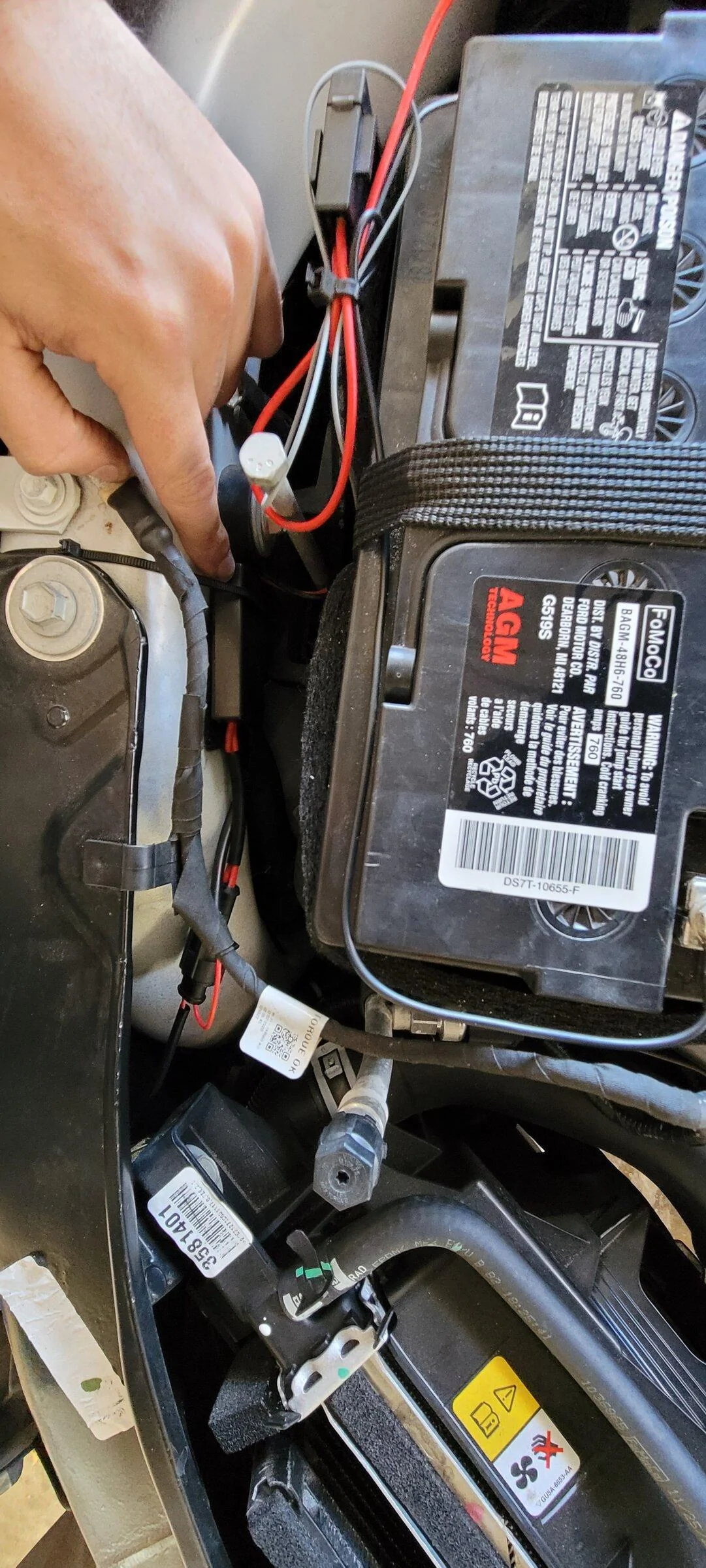

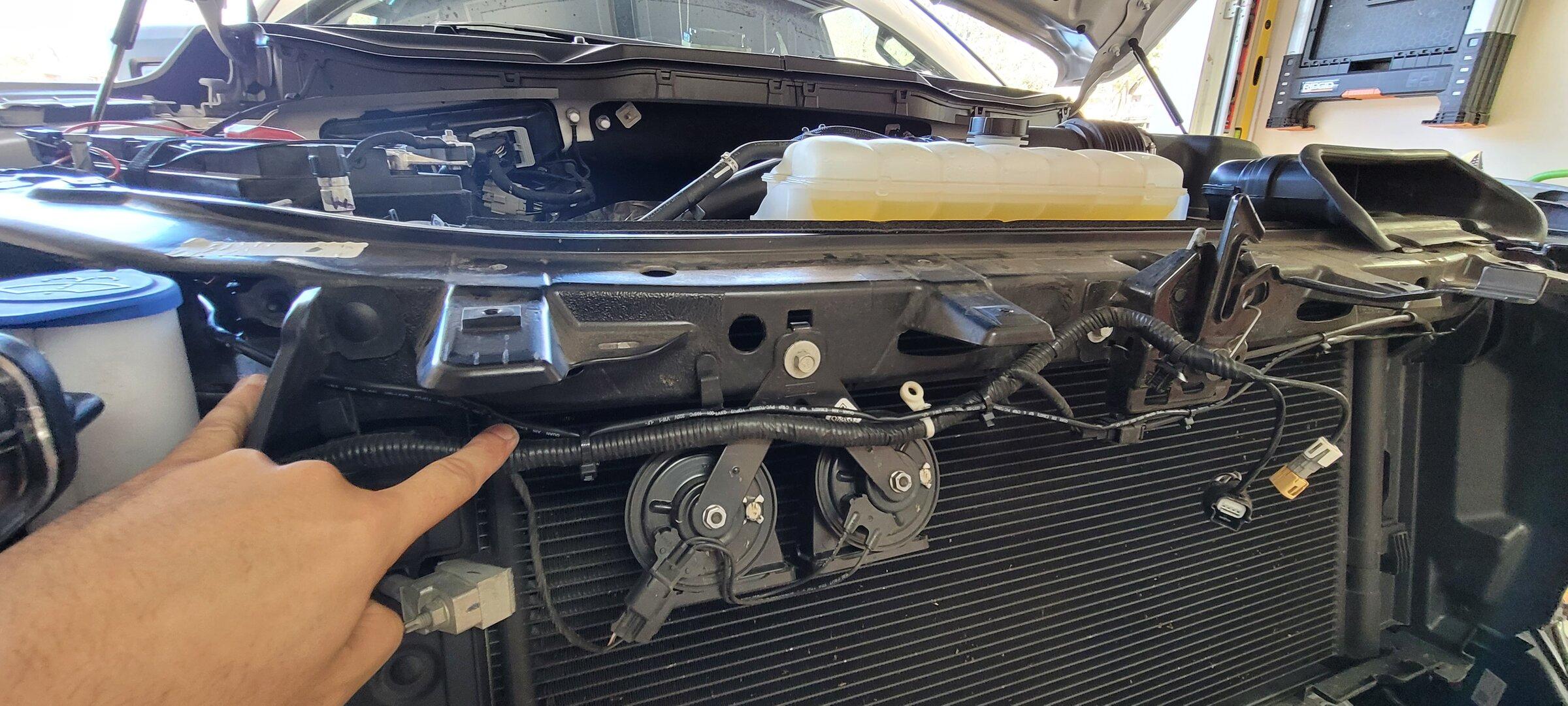

Okay so the DRL Harness is in and the fuse tap was put into #21 and good to go. The DRLs now stay on with low beams when the light switch is in "Auto" during day light hours. Once sunset hits the DRLs, low beams and fogs will be on. The DRLs are noticeably brighter with the harness. Light activation feature when unlocking works and all functions of the lights.
Fuse box with fuse tap into #21
Ford F-150 AlphaRex LUXX Headlights 20220228_141208
DRL Harness attached to inside of frame (put velcro on backside and threw two long zip ties around it)
Ford F-150 AlphaRex LUXX Headlights 20220228_141230
Snaked wire harness through little hole by my fingers and zip tied along another wiring harness.
Ford F-150 AlphaRex LUXX Headlights 20220228_141257
Snaked through frame on driver side and plugged in good to go.
Ford F-150 AlphaRex LUXX Headlights 20220228_141307
