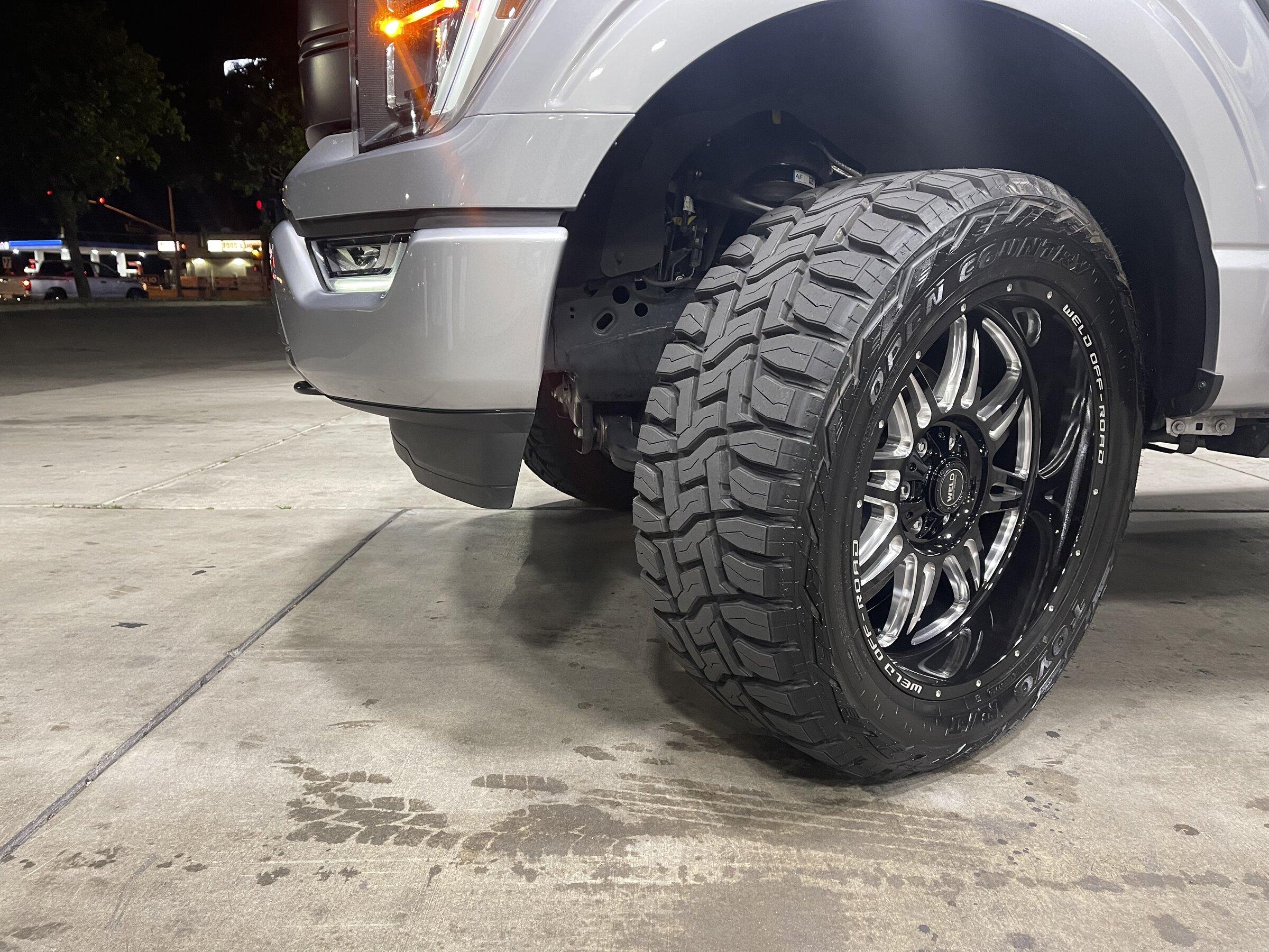

I custom ordered my 2021 F150 Lariat Sport with the 6.5’ bed and tow mirrors. It is a PowerBost and it really lives up to the name. Tons of power and torque. It will throw you back in the seat if you want or it can get 25+ MPG! I’ve had the truck for almost 6 months and I couldn’t be happier. I have done some tasteful modifications to make my truck stand out from the rest.
- BackFlip MX4 bed cover
- Ceramic window tint 5% all around 35% full windshield

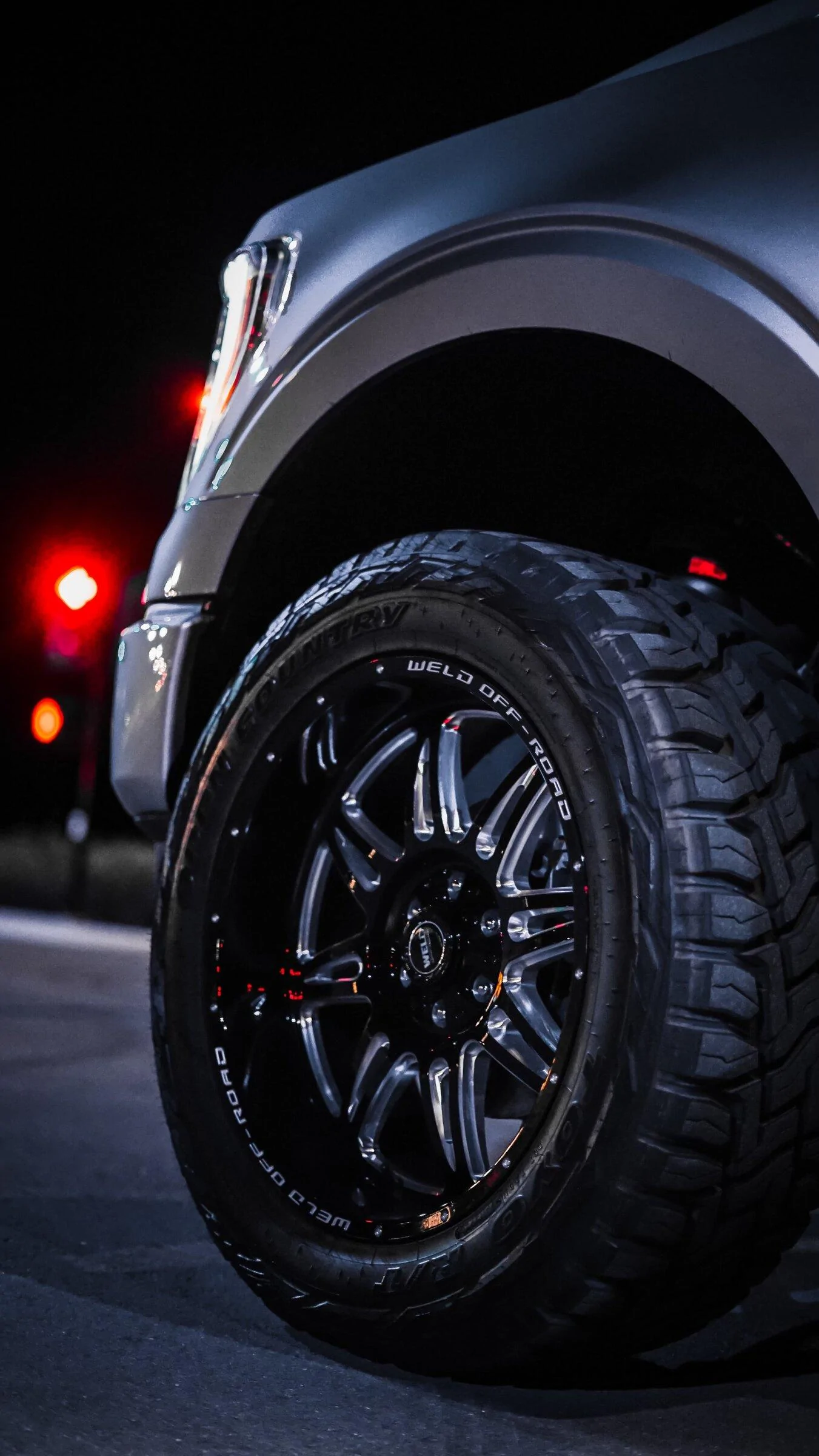

- 3.5” Readylift SST kit. Only installed front. Left rear stock
- 22x10 -18 Weld Cheyenne
- 35x12.50 Toyo RT

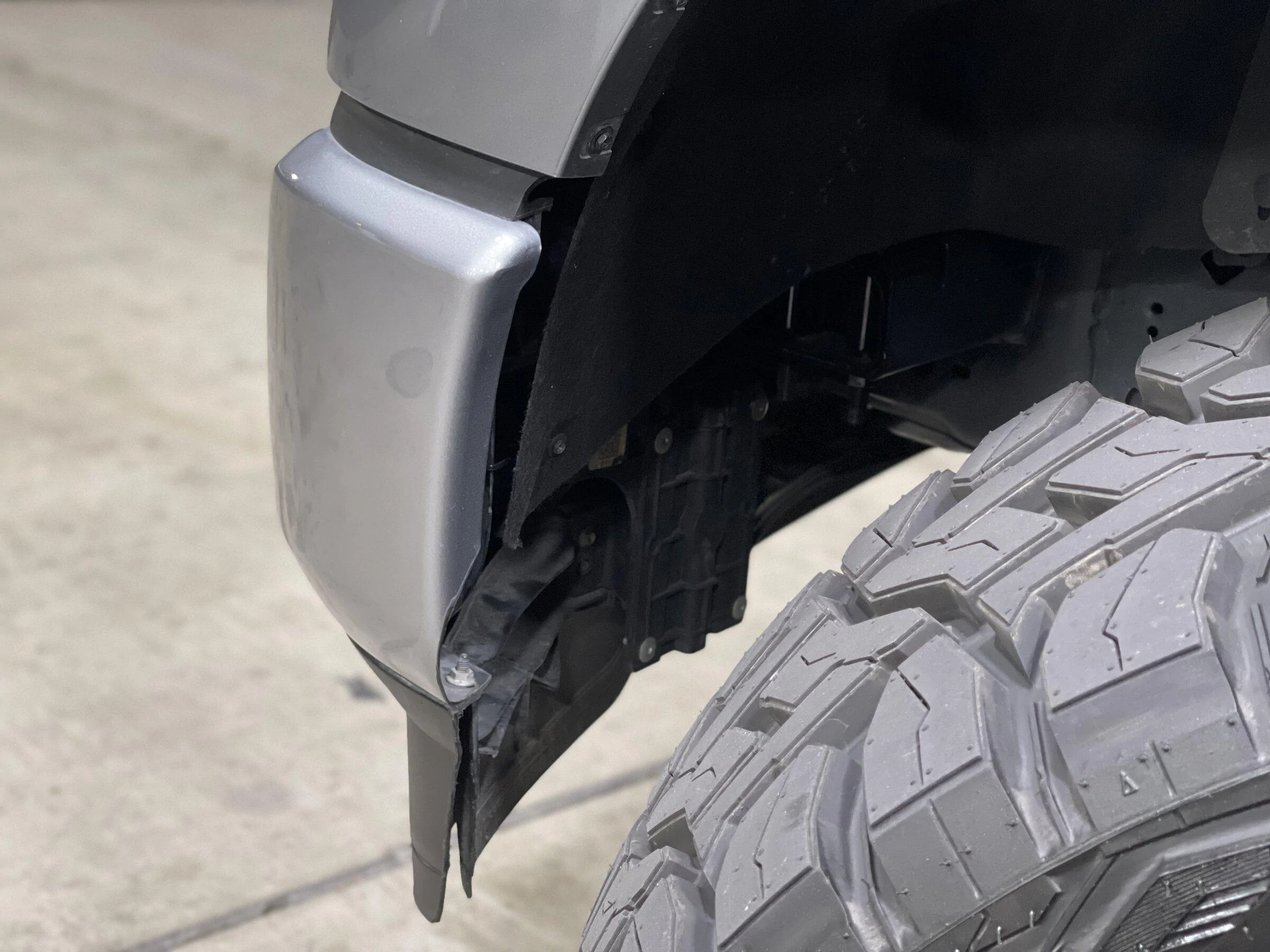

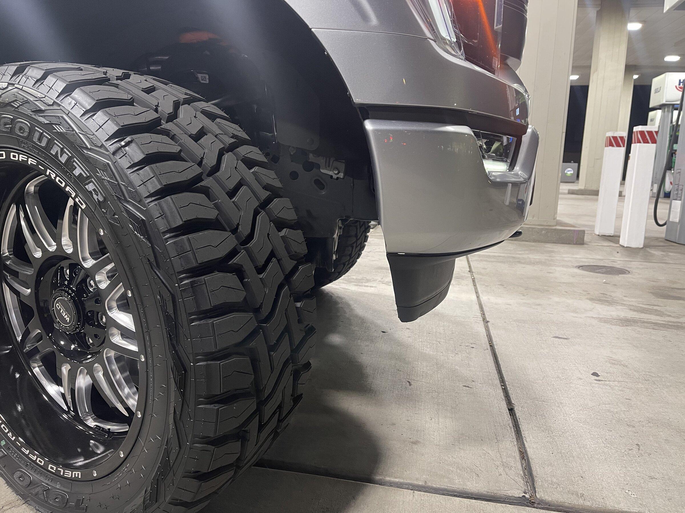

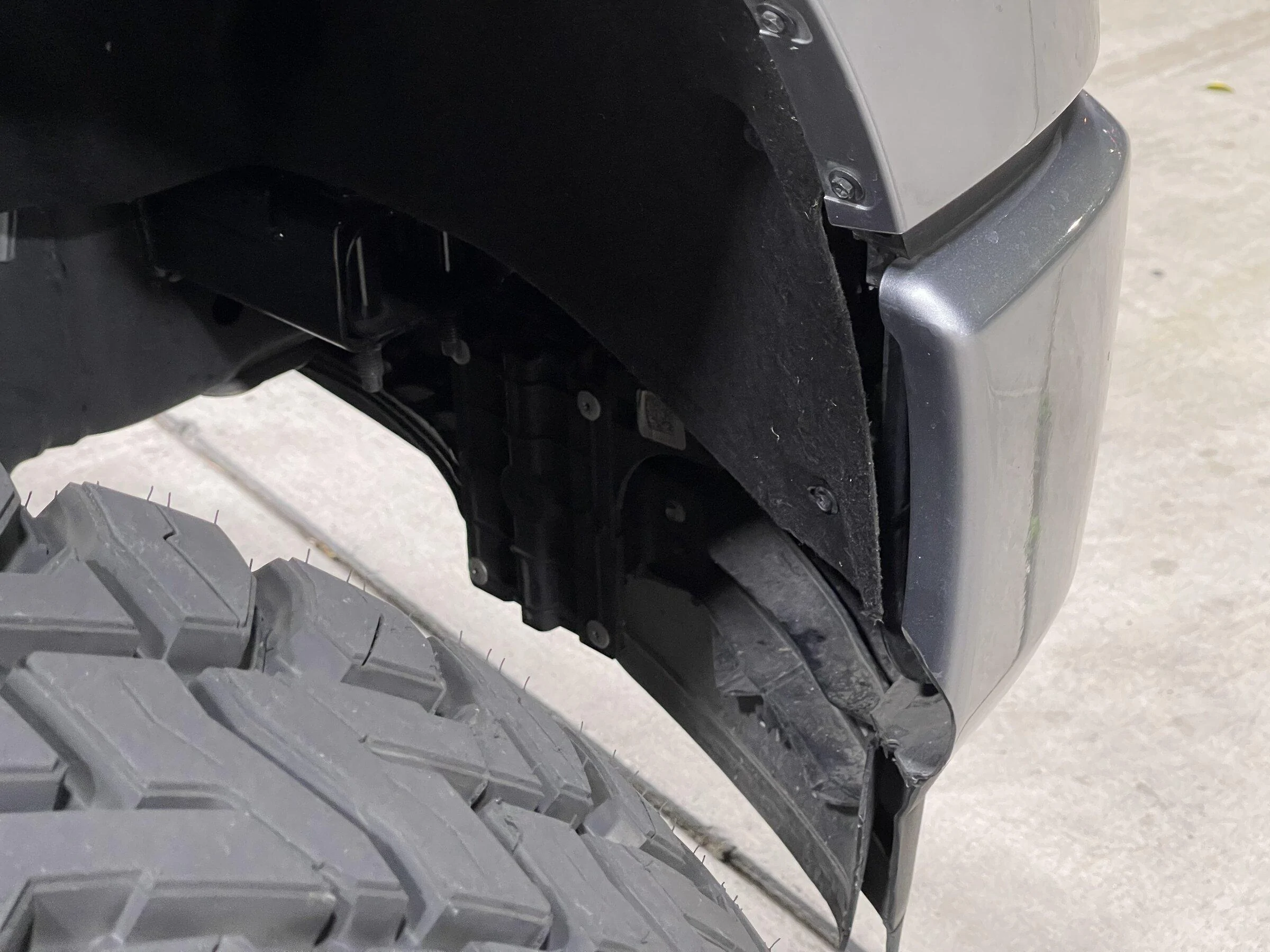

*MAJOR METAL TRIMMING is REQUIRED to fit this wheels and tire setup with NO rubbing! Crash bars, bumper, air dams, and right behind the tire there is a plastic trim Piece that needed to be trimmed along with what is behind the plastic and felt. It is all able to be cut with a grinder and sawzall.*
DRIVER SIDE TRIMMING:
PASSENGER SIDE TRIMMING:
