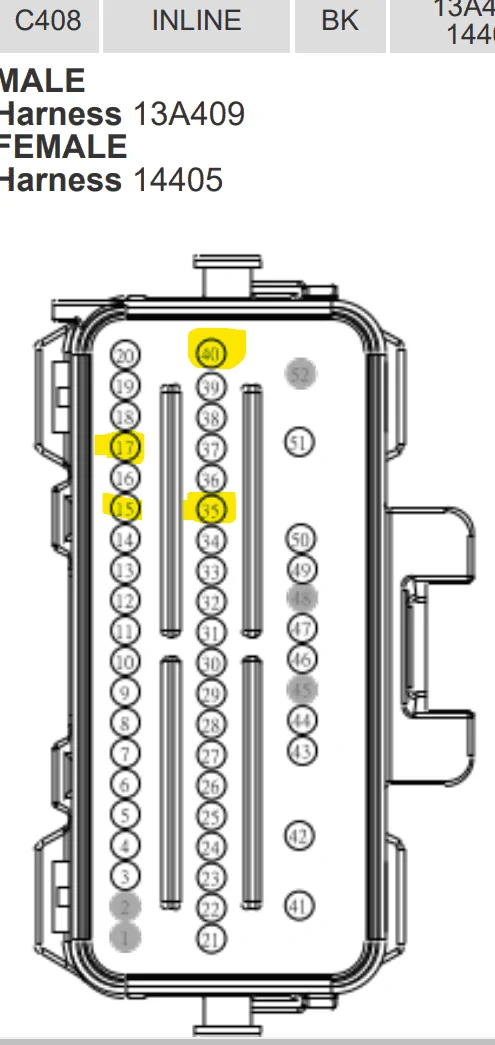

I installed the rear harness for BLIS (ML3T-13A409-HAE) with bed lights and BLIS . did all the forscan changes and BLIS still isn’t working. Is this the wrong harness or is it maybe a change in forscan that I’m missing? Bed lights aren’t working either but the taillights do have power. Any have similar issue?

Im gonna make my own harness. One thing I found weird though... why does only the LEFT radar have 2 GNDs (pin 5 and pin 9). The right radar just has 1 GND pin, no. 5.
