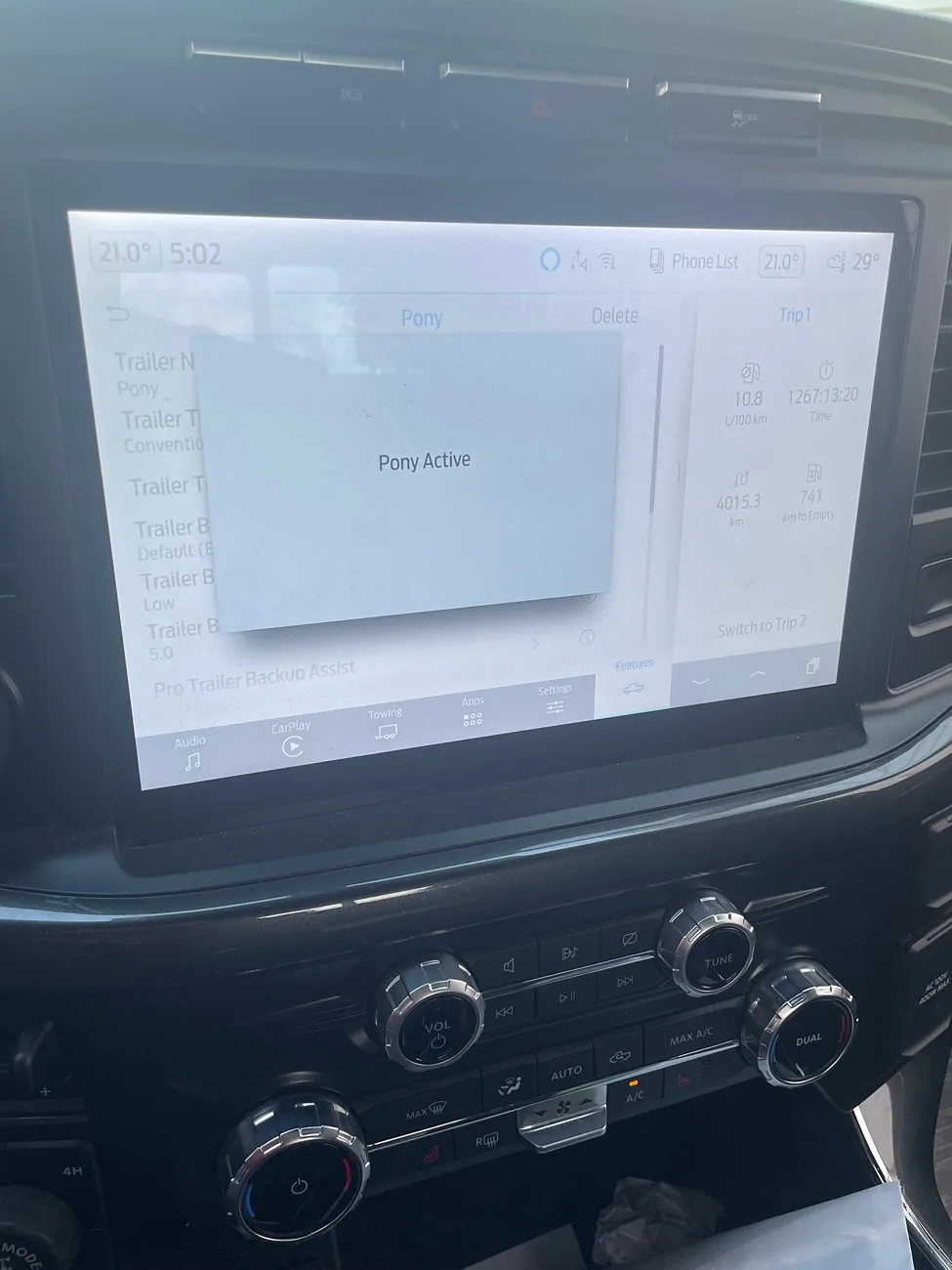

I connect trailer and plug in 7 pin , jump in truck and get message Cross Traffic Alert Deactivated Trailer Attached and I hit Ok truck then tells me to select trailer and I select Pony and when I attempt to setup brake gain I get message Trailer Disconnected.

I agree 100% it’s looking like a problem with the trailer , I know the previous owner owned the trailer for 12 years and never used the electric brakes and she said the owner that bought it new in 2010 had never used the electric brakes but did have the option included.
Did a few more tests today, I connected truck to trailer with just the 7pin connection and pulled the wire out for the emergency disconnect and gave the trailer a push my hand and no change in resistance with the trailer brakes. I changed the gain in the truck to 10 and clicked Ok to the message Trailer disconnected and message went away I then applied the trailer brake slider in the truck to full and taped it in the full position and again attempted to move the trailer by hand and no difference. I also with the truck running and connected to 7 pin tested voltage at the connected 12 volt battery that’s on the tongue and it showed 13.6 with truck connected and 13.1 volts when I disconnected the 7 pin from truck. I think I’m going to have to pull the wheels on the trailer and see what’s going on in there. There must be a way of checking the functionality of the electric brakes sending power to them?
