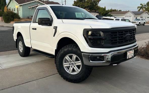

Close - 35x11.50 / 17. On 2” level with coil overs.

No but the RCSB do not have the front crash bar. Only the rear.

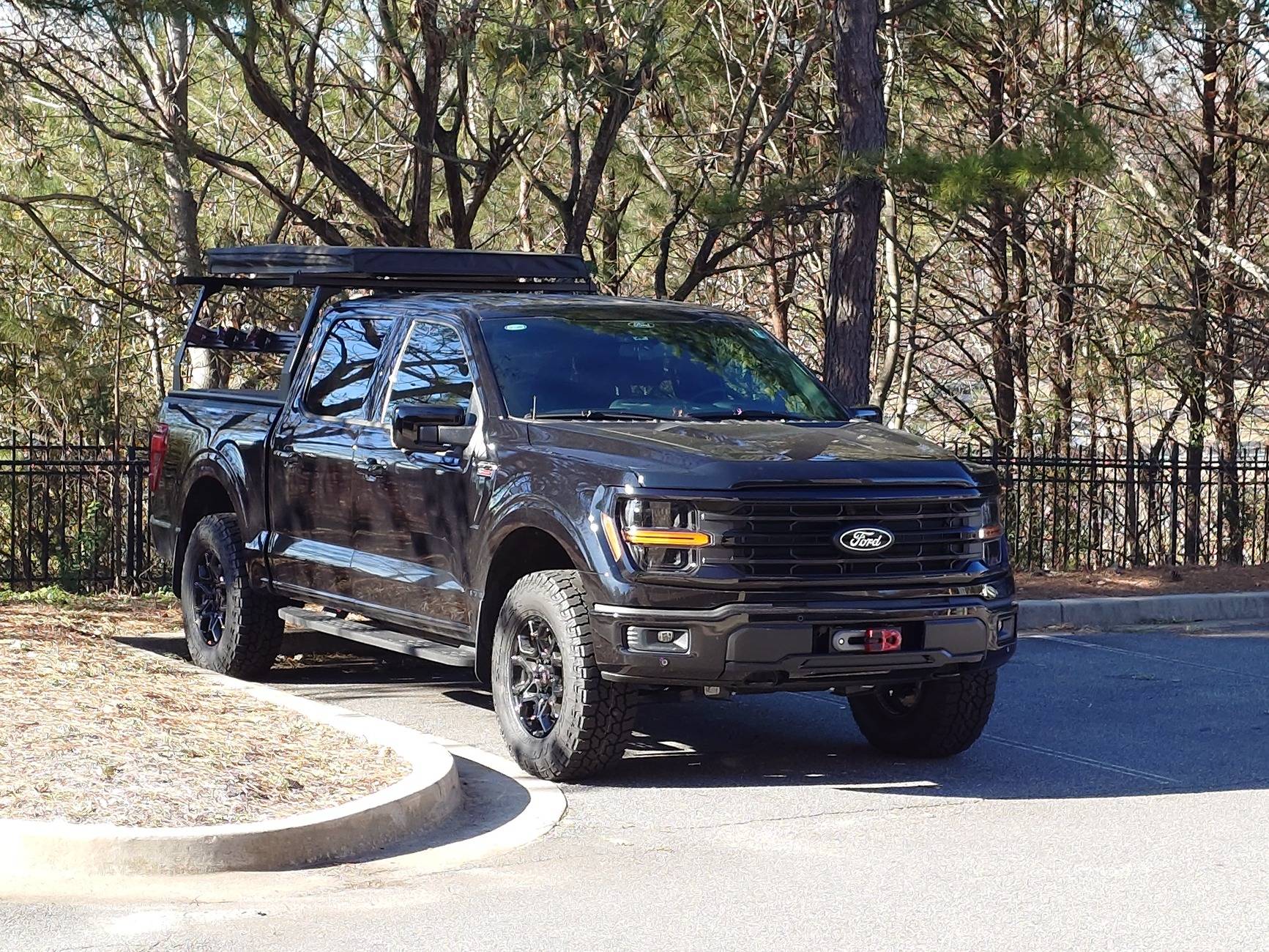

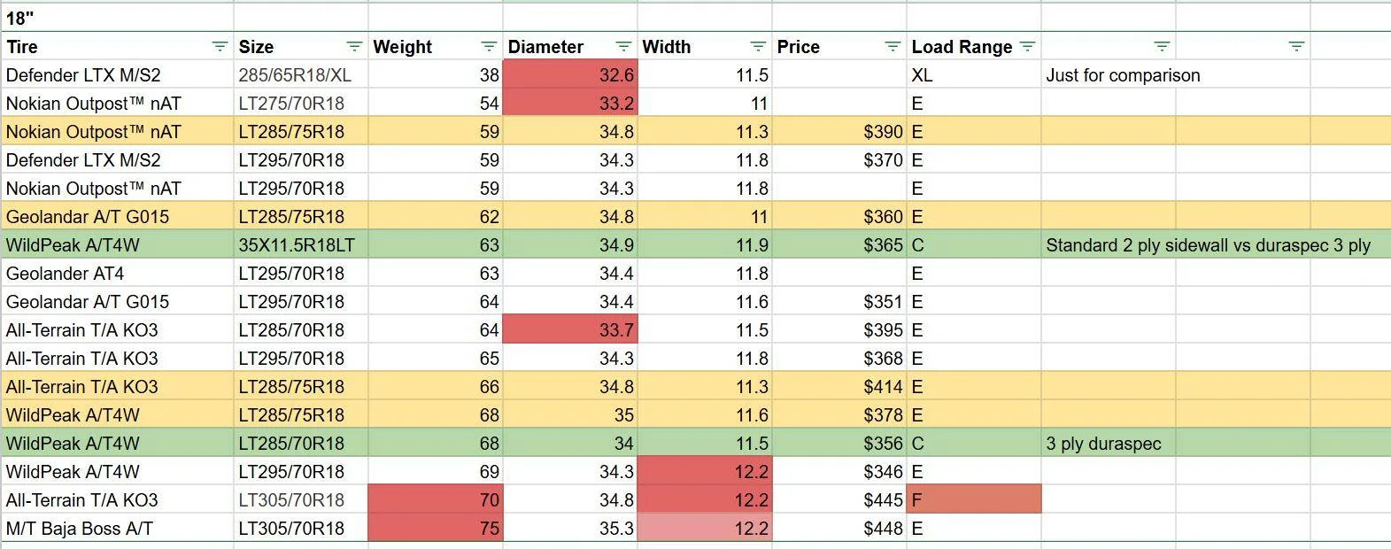

OP any pictures of your setup? What did you end up going with. Thank you for the excellent comparison, I was about to make my own
I went with the 285/70/18s, aka 34x11.5 measured.

What make you go with that size vs the 35’s. I see they cost a little less, but also weighed about 5 lbs more per wheel. Also in general how is the load range C feel?
C feels excellent, not as smooth as my stock Goodyears, but still good ride quality.
These have a beefier sidewall than the 35s.
34s are also a better compromise for driveability.

Haha how about the crash bars still intact or removed? Im looking at running this same size tire with a 2.5" lift
Crash bars intact. I just pushed them forward a little, but it wasn't necessary.
