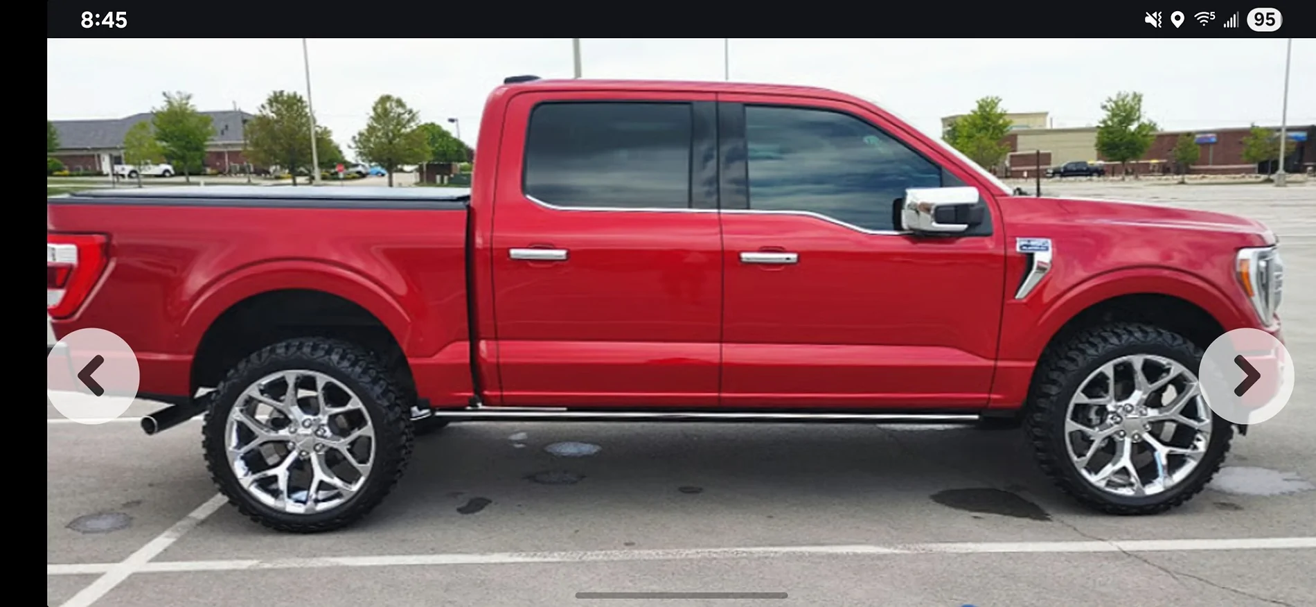

Ford F-150 35s on leveled f150? Screenshot_20250808_204530_Chrom
Level with 35 x 12.5 24's, Chevy snowflakes, 24×10 +24 offset, no rubbing, only had to trim the lower valance under the bumper and remove the black rock guard behind the front tire
