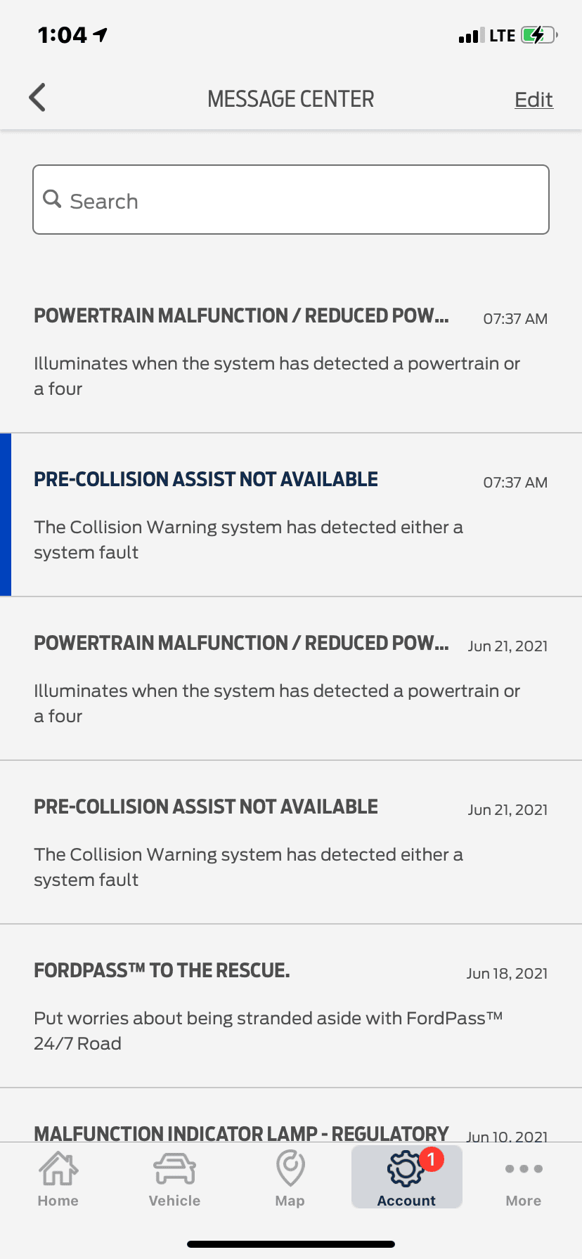

I’ve had three of these in a week. Truck will
Only go 15-20 mph. Brought to the Ford dealership each time. They’ve reset and can’t identify what the issue is.
Anyone experienced this issue ?

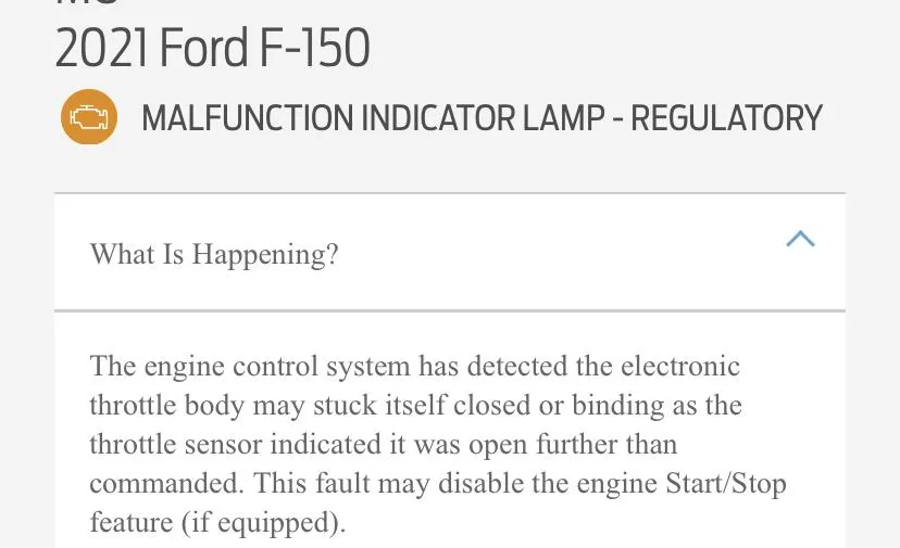

Here is a little more detail from the app. Ford dealership “thinks” it’s something to do with the throttle body.
