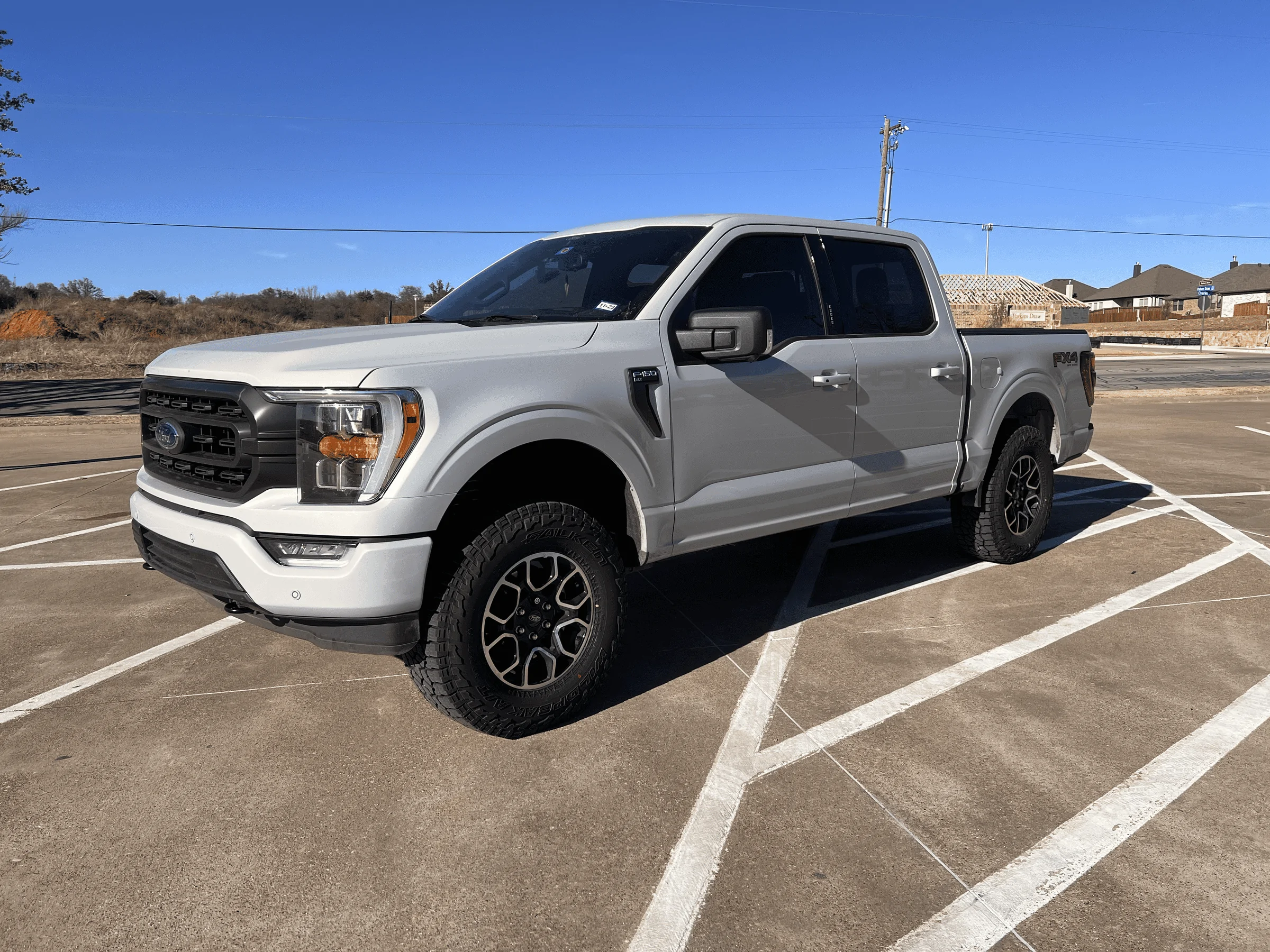

Here are 295/70R18 Nitto Ridge Grapplers on the stock 18" sport wheels. Fit perfect, no rubbing!

You'll feel the difference in acceleration since its more rotational mass you're taking on, but with the 10 speed I'm sure the acceleration wont be too bad since it can always down shift to a lower gear for more power. I'm sure you'll be fine, you just wont have the same take off as 3.73 gear trucks. If you don't want to lose too much performance just go with a less aggressive set up like a 2inch lift instead of 2.25 or 2.50, and slightly smaller tire like a 285/70/18 instead of 295/70/18.

That does look good!

I have a 5.0L with 3.31 gears and 295/70R18 tires. I'm pleased with how my truck rides and drives. Obviously a little slower than it was stock and fuel economy took a hit as well, but it was worth it to me to have the truck look and sit the way I wanted it to.
Like @Tizzzo said, you'll notice it most in city driving where it's a little more sluggish off the line than it was before, but it's not terrible. On the highway it's not really a noticeable difference.
Worst-case scenario if you do it and you don't like it then you could always opt to install lower gears. Hope this helps.
