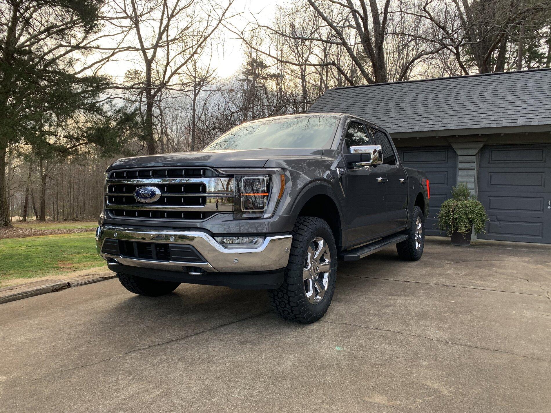

Leveled my lariat 502 fx4 this week. Rough country 2” billet spacers. 275/65/20 toyo open country at3’s. Still have exactly 1” rake which was what I was wanting. Ride is a bit stiffer as expected but still smooth. Mileage suffered a bit but hard to say how much as I only had a couple hundred on it prior. Speedometer is only off by 1 mph measured by gps.
Slick looking rig, amigo. I now know what level/tires I'll be going with when I can find some OEM 20s.
