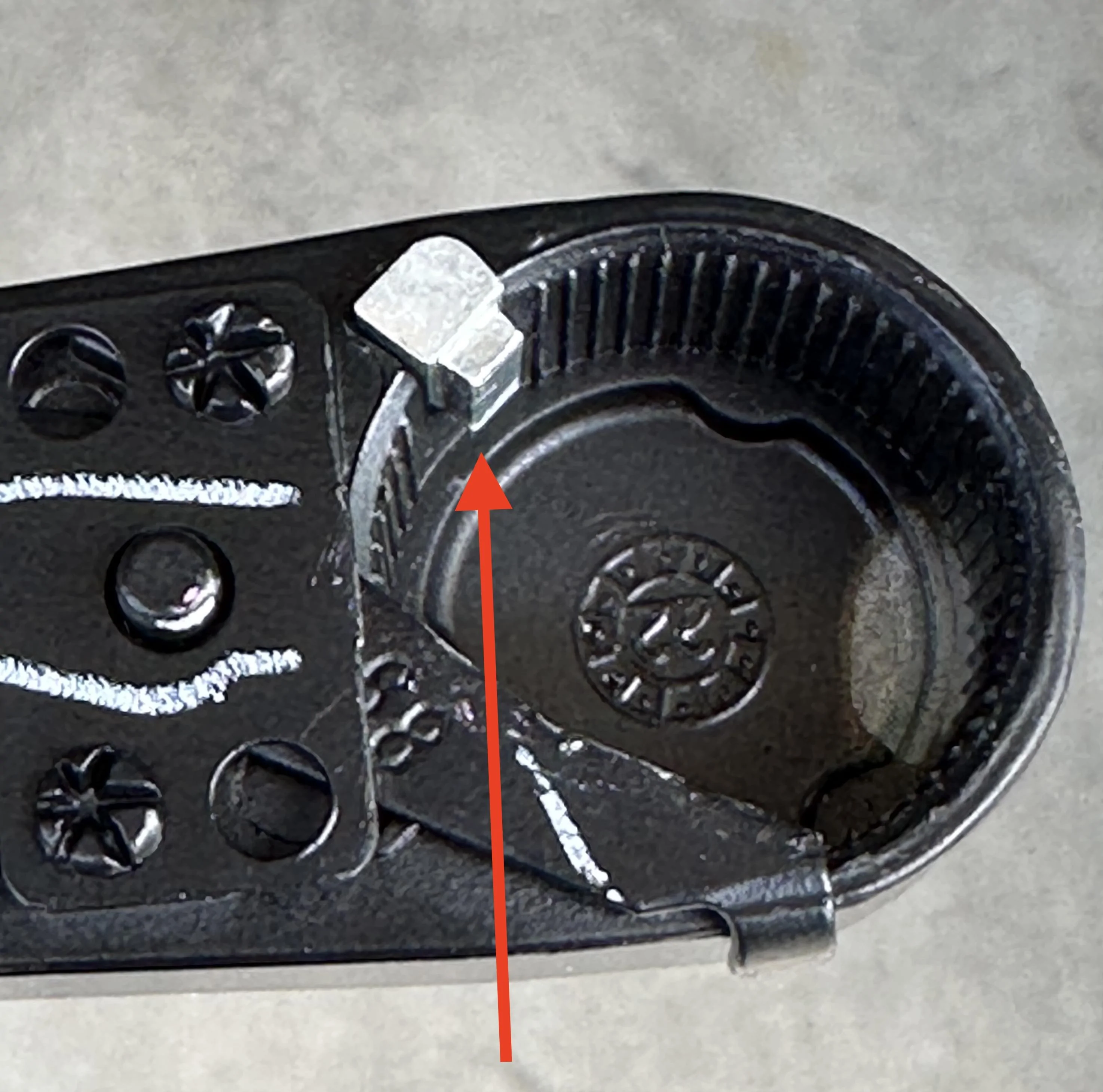

I appreciate the video. Mine was fairly easy to remove. However, the alignment cleat, pin, whatever you want to call it, will only let the wiper go one in a specific position. See pictures with arrows to notch on motor shaft as well as pin on wiper arm mount. NO WAY TO ADJUST.
These have been manufactured 5 deg. or more off where previous stock arms rest when mounted. Just shot these pics of my truck.
