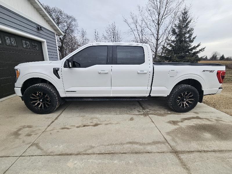

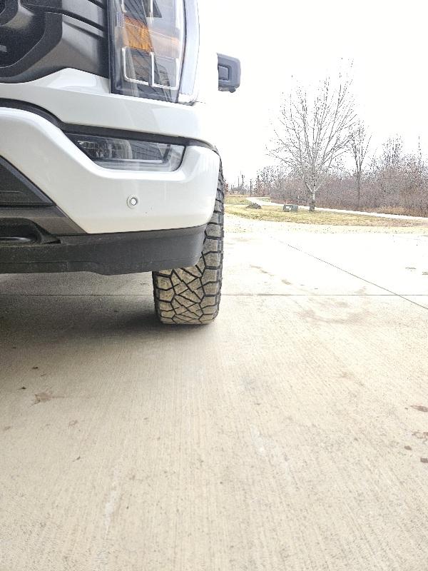

I have the 21 powerboost with the fox 2.o level. I've had it into the Ford dealer 3 times now to attempt to get the alignment corrected.
They say that when the truck is lifted it changes the geometry which results in a positive camber +.44 on both sides.
If he moves the lca out he tells me it will be impossible to align and will eat through tires.
I'm looking for some advice. Bring it somewhere else?
Buy adjustable uca?
Or just live with it?

What alignment issues are you having? I have that kit but adjusted to 1" of rake. I use the SPR forged upper control arms, which allows adjustments on the top pivot point. You might have some success with that as I've never had any issues.

Buy some spc camber bolts. Cheaper than a new uca

Or take it to a shop like 4 wheel
Parts that has experience with lifted trucks. Without those adjustable camber bolts, the dealership is the last place I’d go

I have the same shocks but with an aftermarket upper control arm. No alignment issues, but had it installed and aligned by a proper off road shop
The positive camber.
Caster is also slightly off.
The dealer never gave me the print off either.
You can see by my LCA the oblong hole is moved from factory inward.
Which I'm not really sure I understand why we can't just move it out a little without cause havoc on the geometry of the alignment.
Having said that. I'm perfectly fine buying some
That sounds like a good idea.
