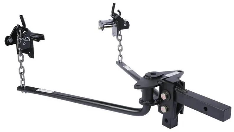

After looking into the types of weight dist hitches seems that there are a few options Any suggestions?
Some have chains and some have solid parts..
how about this one at hobo..
https://www.harborfreight.com/10000...MIn6O9hZjC9wIVQ-HICh2PgQEEEAQYASABEgKwJfD_BwE
I have this Husky one to tow our 23' - 3,900 lb travel trailer. It's good. Haven't tried any others so, can't comment if it's better or worse than most. Seems to work for me though...
Ford F-150 21 PB with leveling kit.. Considering removing 14-1027-2
https://www.rvupgradestore.com/Husky-Towing-Weight-Distribution-Hitch-12000-lbs-p/14-1027.htm
