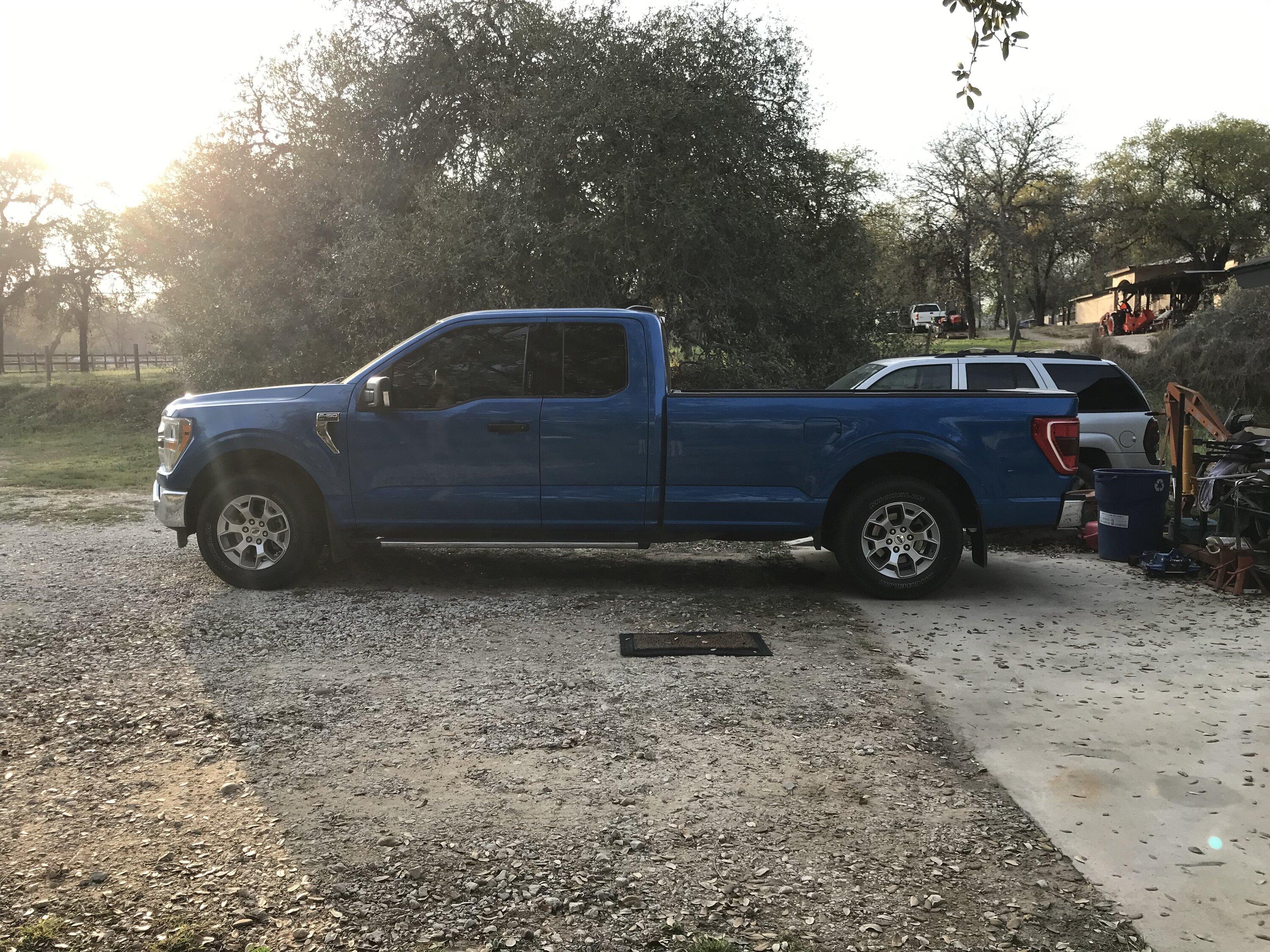

Okay.
I used the MaxTrax shackles.
they come pretty darn close to the box support.
The max Trax will go on a lot easier than the originals come off.
Lower the spare before you get underway, you may need the space for wrestling. (I’m over 60 so not nearly as limber as years ago.)
Shackles alone lowered the rear at the receiver 1-1/4”.
The following weekend, I removed the 4x4 blocks and that brought the rear down an additional 1-1/2 inches.
total of 2-3/4” down at the rear and up about 1/2 at the front.
I have an 8’ SuperCab 4x4 and it is sitting pretty close to level.
Feels a bit heavier in the rear as well, not so much chatter on washboard surfaces.
Also installed the 2wd rear bump stops as well, but I probably did not need to.

a buddy of mine used Maxtrac 2/4 on his RC, loved the ride. Not sure how low you want to go.
Ford F-150 21+ Lowering Shackles Question IMG_4434

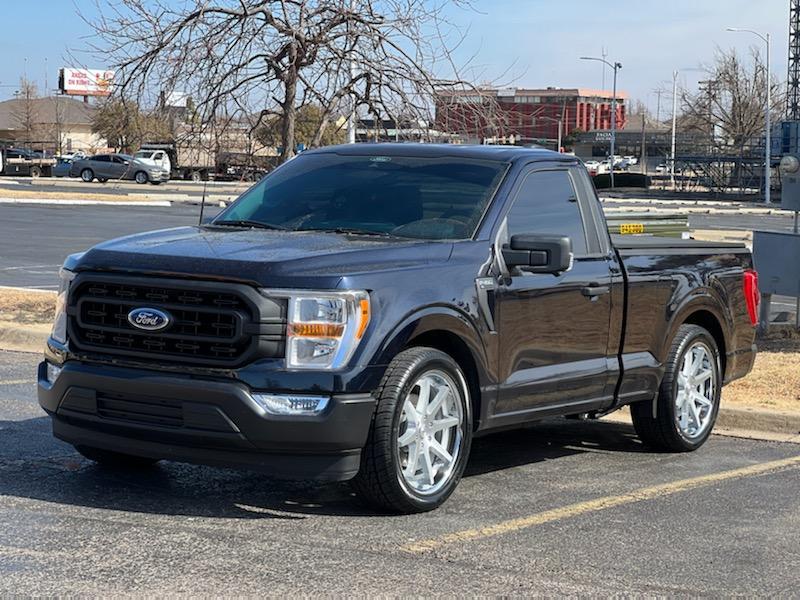

You would have to lower the front to use a flip kit. My drop is roughly a 2.5/5.5. I have a 4WD, so the drop numbers are different for a 2WD. I used the Belltech coil overs (15007) in the front with the SPC upper control arms (25685). I also added the SPC Alignment Kits (86252).
On the rear, I used the VAS flip kit, but after installation the pinion angle was way off. It was too much for shims in my opinion. The pinion yoke need to be raised by about 8 degrees, and that was with shims already installed under the 10R80 transmission mount. Without them, I would have been off by closer to 9 degrees. Honestly, I do not understand how these kits are manufactured without building in the proper amount of driveline angle correction. I ended up paying Victor at VAS $155 for a pair of custom axle saddles to replace the ones that came in the flip kit. The new ones were to be built to raise the pinion up 7.5 degrees and they would only take a couple of days (per Vic). It sounded like a perfect fix. Unfortunately, after waiting a month, the custom parts that arrived were built to only +6 degrees. Vic, who owns VAS, claims that +/- 1.5 degrees is as close as his CNC equipment can be expected to produce. (Yikes!) He stated multiple times that he could not produce the parts any closer and he would not try to remake them. This would make me avoid their products in the future. If the parts in their kits can be off by that much, I would suggest another vendor for the flip kit.
In the rear, I also installed a set of Fox shocks (#285-24-004). I also added a Ridetech Headlight Sensor Bracket Kit (12299501) to preserve the self-adjusting headlight function. I ended up using the custom axle saddles with some small axle shims to correct the driveline angle. I also ended up installing a set of MaxTrac Front Leafspring Hangers (3032RH) and the IHC Short Rear Shackles (F1520LS-1) to raise the rear up about 1.75 inches above the axle flip. I am also using a Belltech Rear Anti-Sway Bar (5561) and Belltech Axle Bump Stops (4922).
Here is a pic. Please excuse the dirt. I went on a long trip yesterday and did not have time to clean it up. :)
Ford F-150 21+ Lowering Shackles Question 20230619_101858

Looks sweet! Here is mine with the 413710 shackles. Is really is something what just 1" can do to tame the factory rake, but I am after a completely level stance. Right now I have roughly 2" difference between back and front. I will either be putting a 2" spacer lift on the front and calling it OR swapping to the 411420 shackles in the rear and then putting a small 1" or so spacer lift on the front if needed, a look that I think would be very nice and unique. Either method should get me the look I'm going for. I am just a bit worried about cutting the bed support. Do you know if that is a concern for the factory warranty??
Ford F-150 21+ Lowering Shackles Question 20230621_192932

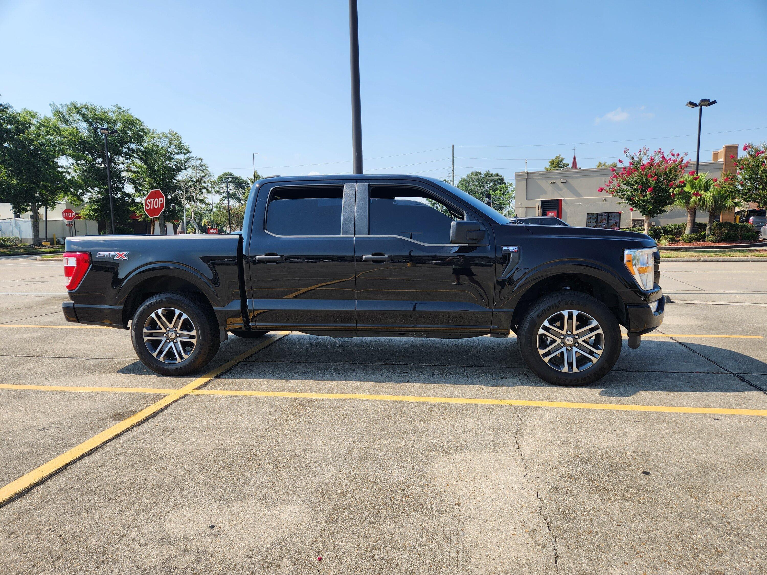

Rjp413
Mar 2, 2023
Louisiana
2022 F150 XL STX 2wd
Very good insight and I agree! I wont be doing any extensive or risky modification. That said, I did not go any lower in the rear, but it came out perfect for what I was going for with the parts I chose. This is the 2.3" leveling kit from Stage 3 installed WITH the Maxtrac 413710 that i already had on. I took measurements this morning on flat, level ground and it's 100% level to the t, measuring roughly 39-1/8" at all 4 wheel wells, so I couldn't be happier
Ford F-150 21+ Lowering Shackles Question 20230701_095211
