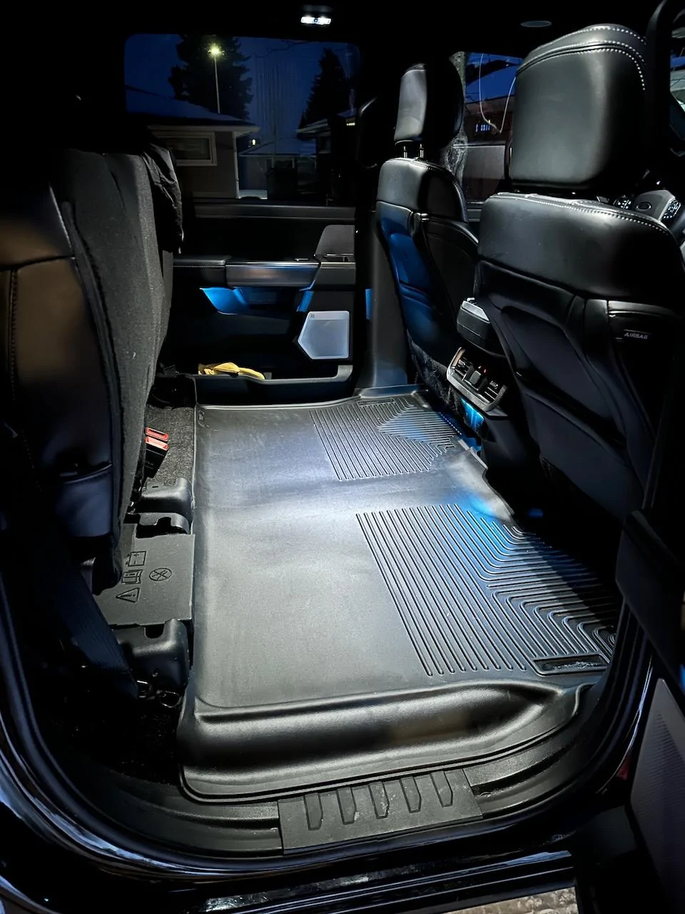

Hi everyone - I have a 2022 Platinum that came stock with the folding rear seat storage. I found I never used it and kept it folded in as the dog bed was there. For road trips our Yeti cooler kept falling over (1st world problem).
After some research I found it was very easy to remove and thought I would share. I am loving the extra space and the fully flat rear.
First I removed the actual unit, which is just 4 bolts to unscrew.
Ford F-150 21+ Folding Rear Seat Storage Delete - How to! 1710028812684
Ford F-150 21+ Folding Rear Seat Storage Delete - How to! 1710028831710
There are then 4 bolts sticking up which cannot be removed. They are not reverse threaded but bolted from the bottom of the vehicle. I used an angle grinder and trimmed them off. There are some divots in the floor and I used some foam strips to fill in the space. It's not the prettiest but it works fine. I purchased a Husky rear seat mat but I would recommend getting the weathertech. It is a much harder rubber so you won't feel any of the divots.
Ford F-150 21+ Folding Rear Seat Storage Delete - How to! 1710028980163
Ford F-150 21+ Folding Rear Seat Storage Delete - How to! 1710028987329

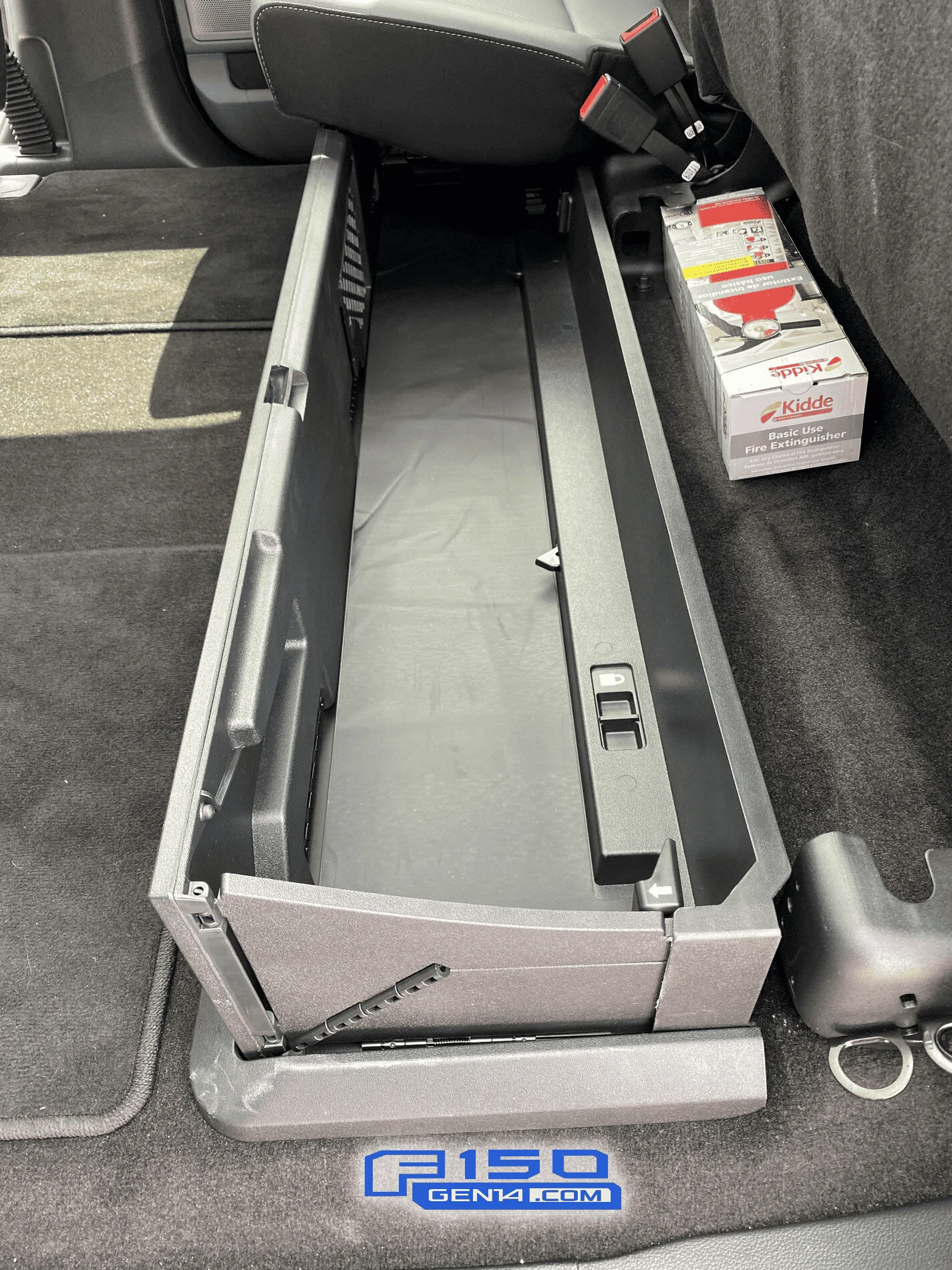

Before photo, stolen from the interweb.

There's a plastic piece to span that gap for the rear under seat storage on the driver side if desired. It's a handy cubby spot. I pulled mine out for a few months. I too dislike the hard plastic slide potential of it when it's closed. Plus fold-flat is a half truth as it's still not flush with the floor. Coolers / containers slide on it with just enough height difference to promote things tipping over into the center console w/ slight braking. They should have integrated a mat of sorts to provide a grip surface when down.
Has anyone w/out the storage unit checked to see if the threaded nuts are present for the studs that secure it? Would make rehoming it much easier.
