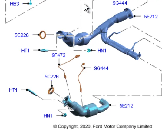

Take a deep dive into the parts book.
Find and compare the parts numbers. Its the only true way to determine if they are the same or different.

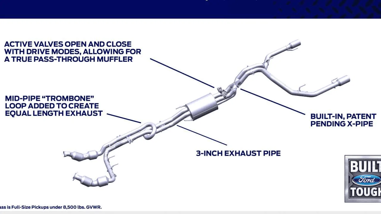

@superfordman I am a little torn on if it needs an X or an H. I know they have been around since fox body Mustangs, but ford didn't put an H in the Gen 3 Raptor, and it seems everyone's goal is to achieve the sound of that.
In my mind, if you put an X pipe in, does it defeat the purpose of the equal length? I mean if the gasses are merging together in an X pipe, why does it matter if the pipes are equal length before? I don't know. I may be wrong. I think the X and H setups were about flow and back pressure. I don't see that being an issue with a 3.5 breathing through good size dual pipes.
I think I may go with the Ford oem trombone with a small bullet style resonator in each pipe behind it, then into the factory muffler and see what I get.
Ahh, but they do have an X pipe on the factory gen3 setup, its right behind the muffler now along with the little third pipe adjustable exhaust valve that dumps into it. All the research I did, I was easily leaning towards X pipe as that is what the OEM and aftermarket offer. An X pipe keeps everything equal, but just helps to balance and equal out flow and sound. A question I had then is a gen2 system a true dual system then? Because there is no X pipe you can see, unless the gen2 muffler has an internal X pipe, which again I've always meant to check but never have, but will now that I think about it.

I can't verify for certain, but in the long thread on the Raptor forum about the SPD trombone, someone had mentioned the factory muffler not having a crossover like a Magnaflow.
That's good info On the Gen 3 setup. I have never seen an X pipe after the muffler before

Also looking at that diagram, it looks like Ford did bullet resonators right after the cats
I'm about 99% there is no X pipe muffler in the gen2 system, so that would make it a "true dual" then
Those are there on any gen14 turbo engine so nothing new there, more like a double cat system than a resonator.
