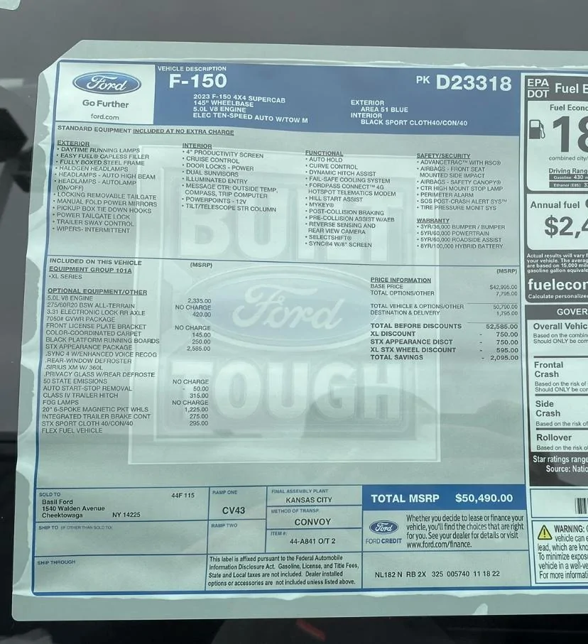

The 5.0L does have a pretty intense oil cooler and twin fan radiator setup. The transmission cooler is a coolant to trans fluid heat exchanger on the 10R80 no matter which package. With no factory hitch option the tow rating is 5,000 pounds, with only 53B (Class IV hitch) the tow rating is 7,000 pounds, with 53A (tow pack) it’s 9,300 pounds (I think), and with Max tow it’s 13,300 pounds for the 5.0. Here is my window sticker, mine was optioned with class IV receiver and integrated trailer brake controller. I have the Smart Connector 4/7 pins as well as the dynamic hitch assist, but no tow technology pack means no pro backup knob. Mine is the 7,000 lb rating. The tow ratings I posted here only apply to the 5.0 V8 and 3.5 TT for non tow tech pack trucks, other engines have lower ratings than the two premium engines. Refer to tow guide for 3.3/2.7.

Thanks for the additional info, I very much appreciate it.
