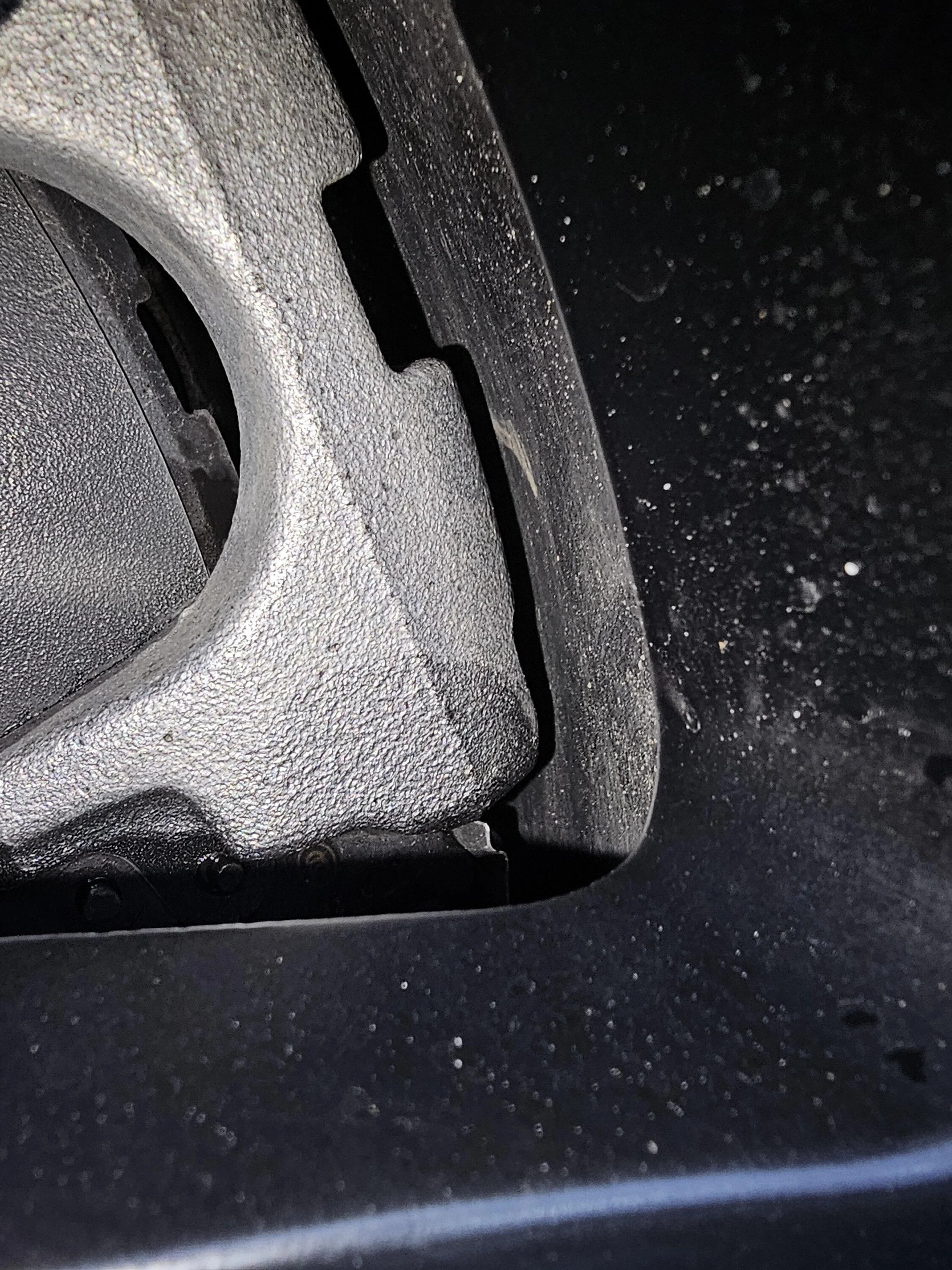

Thank you for capturing these! Looks tight but I went ahead and spoke with my local Discount Tire. They are getting a set of the 703's in 17's to the shop and I will stop in for a quick test fit. If all goes well then they'll mount up a set of 287/75 Wildpeaks and I'll be able to check tires and wheels off my todo list!
I did have them order the wheels with a +25mm offset (looking for a bit more tuck and plenty of clearance in the wheel well. Will see if the deeper offset breaks the fit with calipers and report back.

Method 703 Wheels - 17x8.5 0 offset
285-75R17 Toyo AT3
Coilover install was surprisingly easy. Was worried about passenger side access but it was a non issue. Wheels fit over the max tow package calipers, occasional rubbing at full lock in reverse but it's really minor. Couple MPG reduction in fuel economy but still average 19-20 mpg. Really happy with how it came out and ride quality. Waiting on a bed shell now, hopefully another couple of weeks.

Following up on my test fit of the same wheels in +25 for other members reference....didn't work with the max to rear calipers. The extra inch of offset was just enough to allow the caliper to make hard contact with the wheels inner diameter along the taper. Pivoting to an 18".
