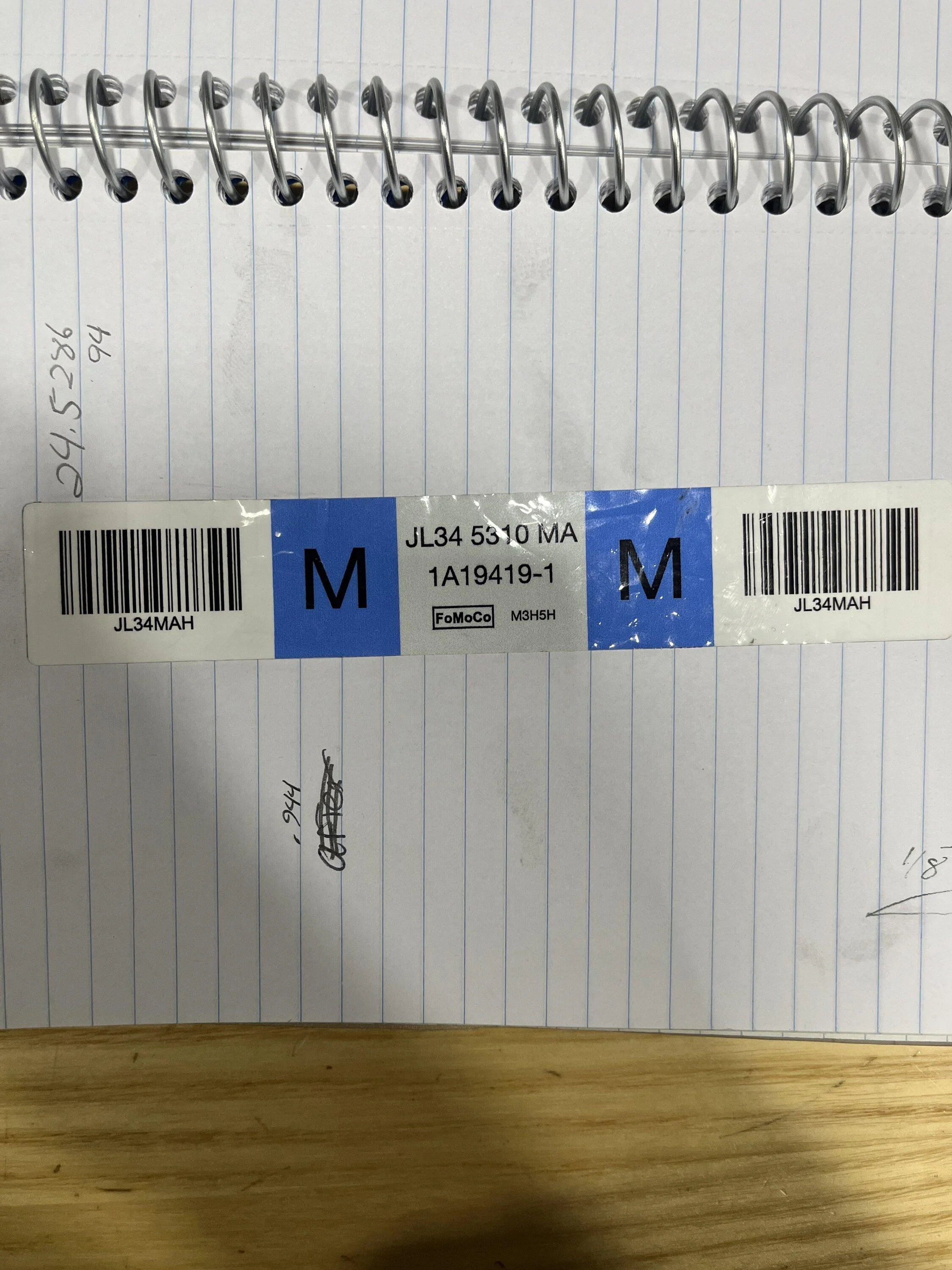

Truck looks great! Doing mine soon. Thanks for the info. I have a 2wd 5.0 rcsb 23 here’s the part #. Spring thickness is .635”
Ford F-150 2021 RCSB FX4 3" rear drop IMG_4495
