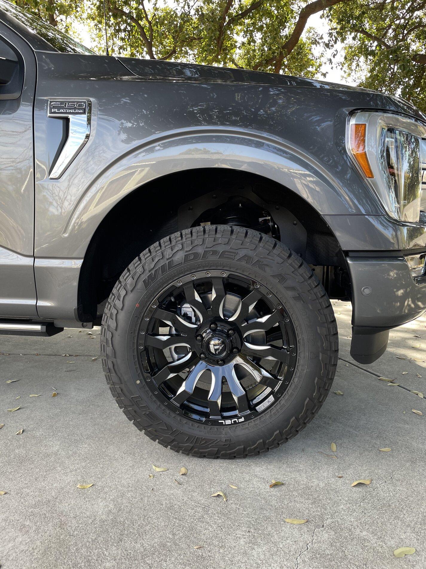

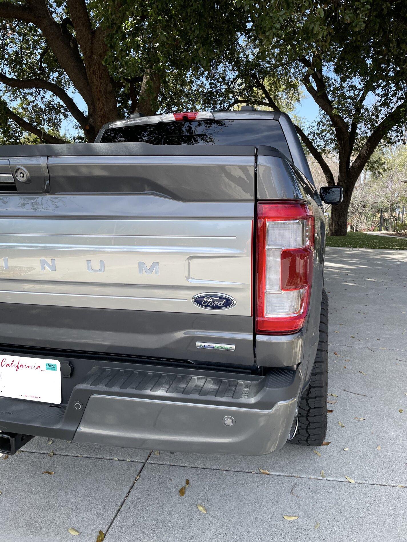

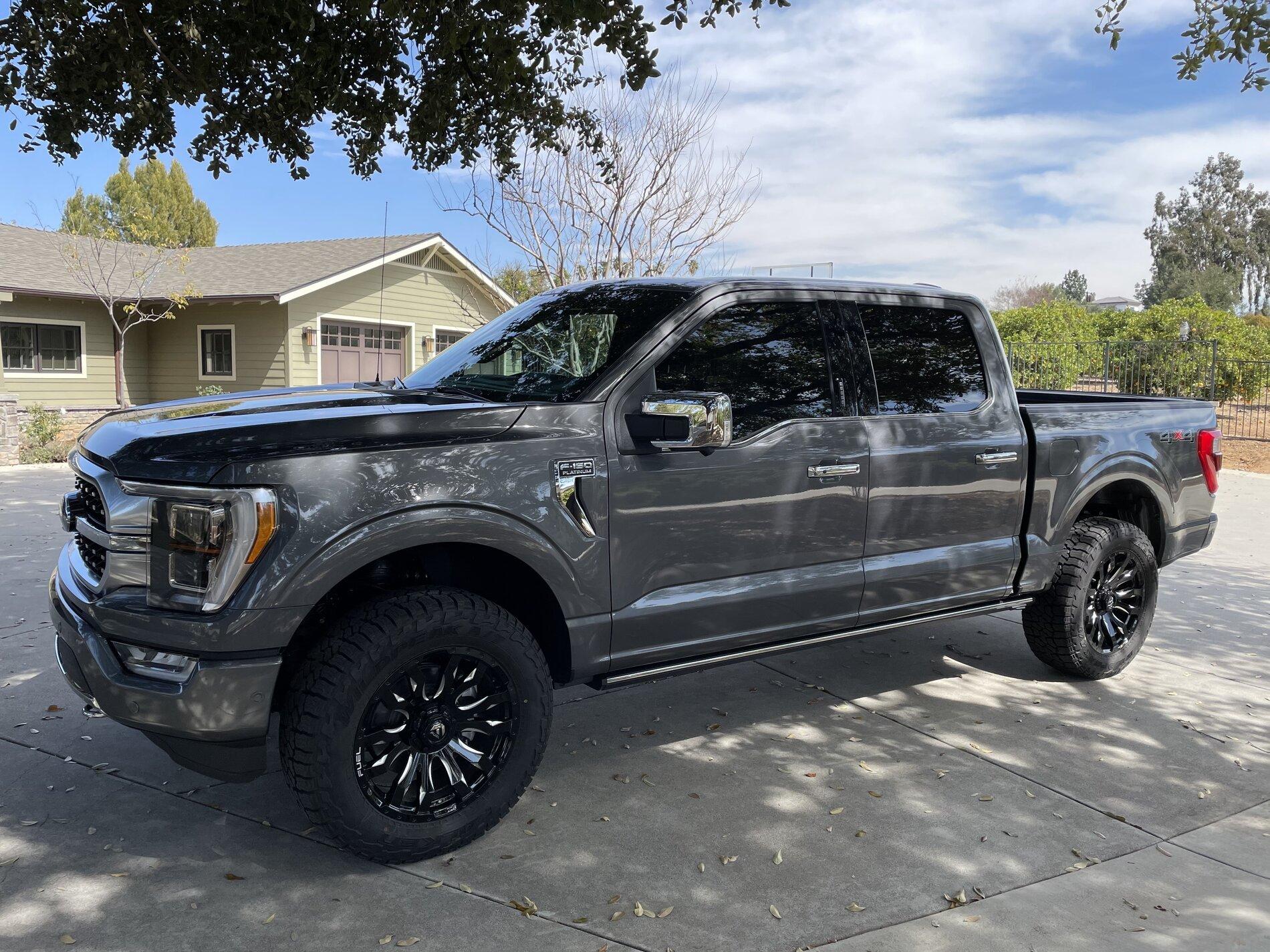

35% tint on all windows
2.25" Leveling Kit
20x9 Fuel Blitz wheels with a +20 offset
Falken Wildpeak tires (285/60R20)
No cutting or modifications of any type to the truck. Tires barely extend beyond the fender well and there is no rubbing, even at maximum steering input.
Very happy with the final product!
Truck looks great! I'm looking to level mine, too, but can't seem to find a manufacturer with one approved for the 2021s. Heard that If I use the Ford Performance Fox setup, will not affect insurance. What brand did you use?

ReadyLift

Where you at in calif. I am up at Clearlake area. Is the 35% tint legal on the front in calif. I have a hard time seeing at night from headlight glare. I was wondering if that would help me but also worried about it being to dark at night.
Was there a reason you went with 60 series tires instead of 65 series. I am wondering if 65’s would rub?
Do you have any rubbing turn to turn?

There is no rubbing on the turns. I'm not too sure what a 65 series tire would do.
Regarding the tint, in California, no tint is allowed on the front driver or passenger window. I went 35% all the way around, so it darkened up the back (since it was placed over the factory tinted glass) and the front is still light enough to see in, but it cuts down a tremendous amount of the heat and UV. I'm in Southern California where it gets nice and toasty in the summer!

65's will rub with a 20mm offset. You can go with 65's if you stick with stock wheels which are +44 offset. Several members are running 285/65R20's on their stock wheels and some don't have level kits.
