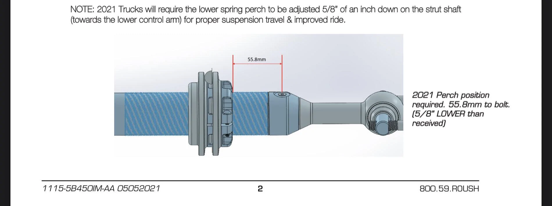

Do you know if the front coil overs were adjusted down 5/8” like the manual says to do for ‘21s?

I had it done at custom truck center , center of my rim to the bottom of the fender is 26"

I would check if they adjusted it still, if not it’s possible you got 2.5+ out of the front and could have ride issues from suspension travel. It does look like your front is pretty high. It looks great but just something to think about!

They took and did a front end alignment after they were finished. I like the ride now better than the floaty factory ride. 70 mph hands off straight down the highway...

Right, I’m just asking because fox specifically says if the adjustment isn’t done you could have issues with your truck. Has nothing to do with alignment or how it feels, it’s a matter of component failure if the instructions aren’t followed by the manufacture. Just trying to prevent future headaches for you.

2021 has suspension changes. If you don’t do the adjustment you’re stressing the front end and limiting travel which will lead to a harsher ride and pre mature failure (per fox). Many have installed without adjustment and went back to fix it. Just trying to help since others weren’t aware and were able to fix.
OP I would measure fender to ground front to back to see how much lift you actually got.

Roger will have it rechecked thanks....

Yes I did measure fender to ground and got 2.75” and after 3months it settled in at 2.50”.
Had it installed at a Ford shop, but I bought the parts. Thanks for the info. It will be a wait and watch for now.

I was worried about this when I had mine installed, I told the guy to make adjustment and he did. I know some shops might be like sure yeah whatever and slap it on. You didn’t add rear blocks did you? Curious what you’re measuring rear and front from ground to fender. I went for 275/70 tires so only gained an inch of height but I also added 2.25 rear blocks.

Thanks for the info checked it and it was installed correctly..
