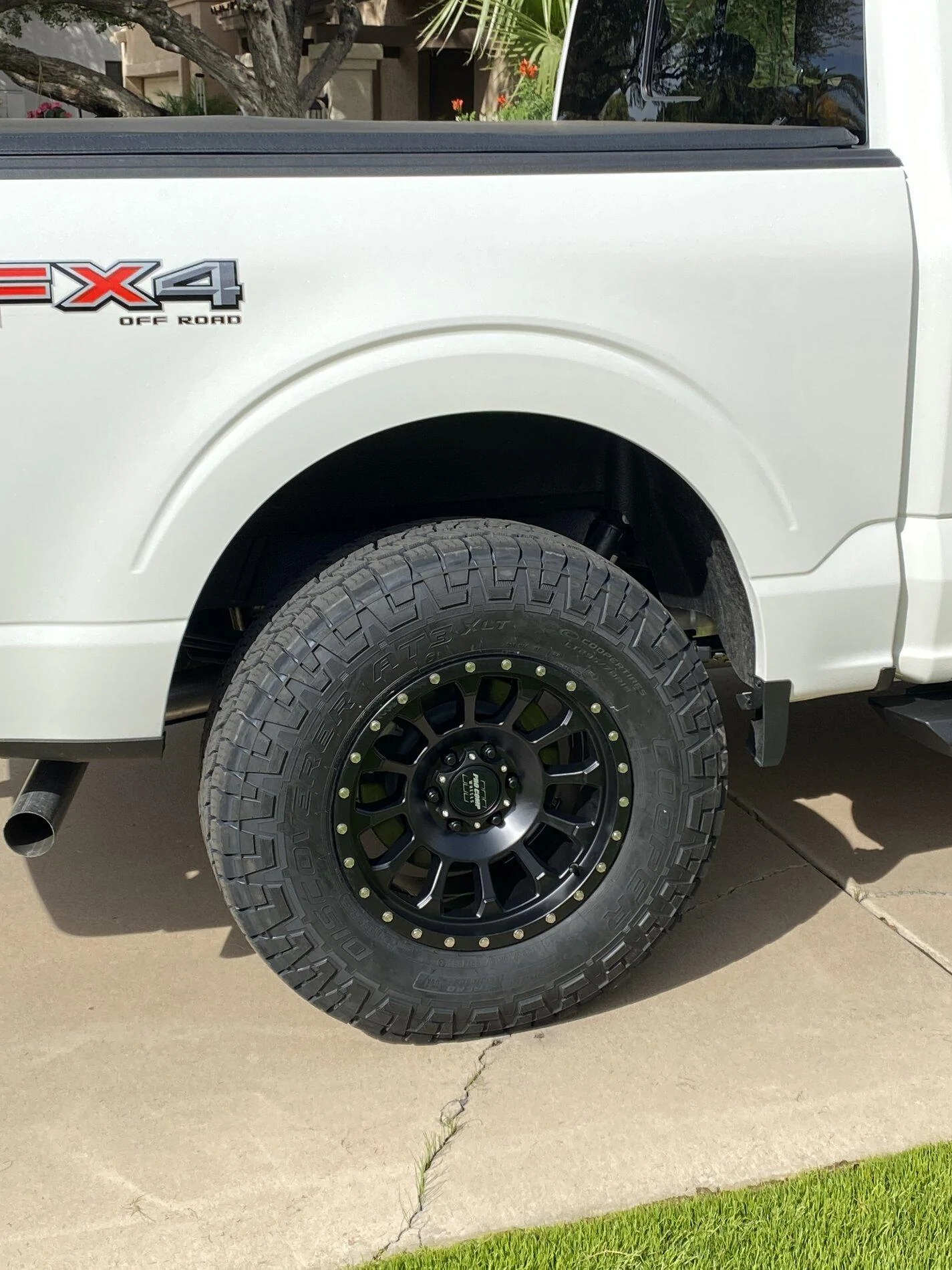

I installed 295/70-18 Cooper Discoverer XLT’s, they measure 34.25 and have been great so far. I have the same level as you.
Ford F-150 2021 Lariat 2.5” Leveled 50F8C826-FEA2-413C-9E19-EDF8CA10FF23
Ford F-150 2021 Lariat 2.5” Leveled 3103A32C-B93A-44BA-9360-9A8985840926
Ford F-150 2021 Lariat 2.5” Leveled A3CB6E30-BA46-4789-8D45-5FE1BFB57795

Those look great, you think we could clear 35’s?
Definitely clear 35’s since most are not a true 35”, I had a little trim work on the rubber/plastic front fairing but plenty of room otherwise. My rims are 0 offset so I went 295’s, but you could easily do 315’s
