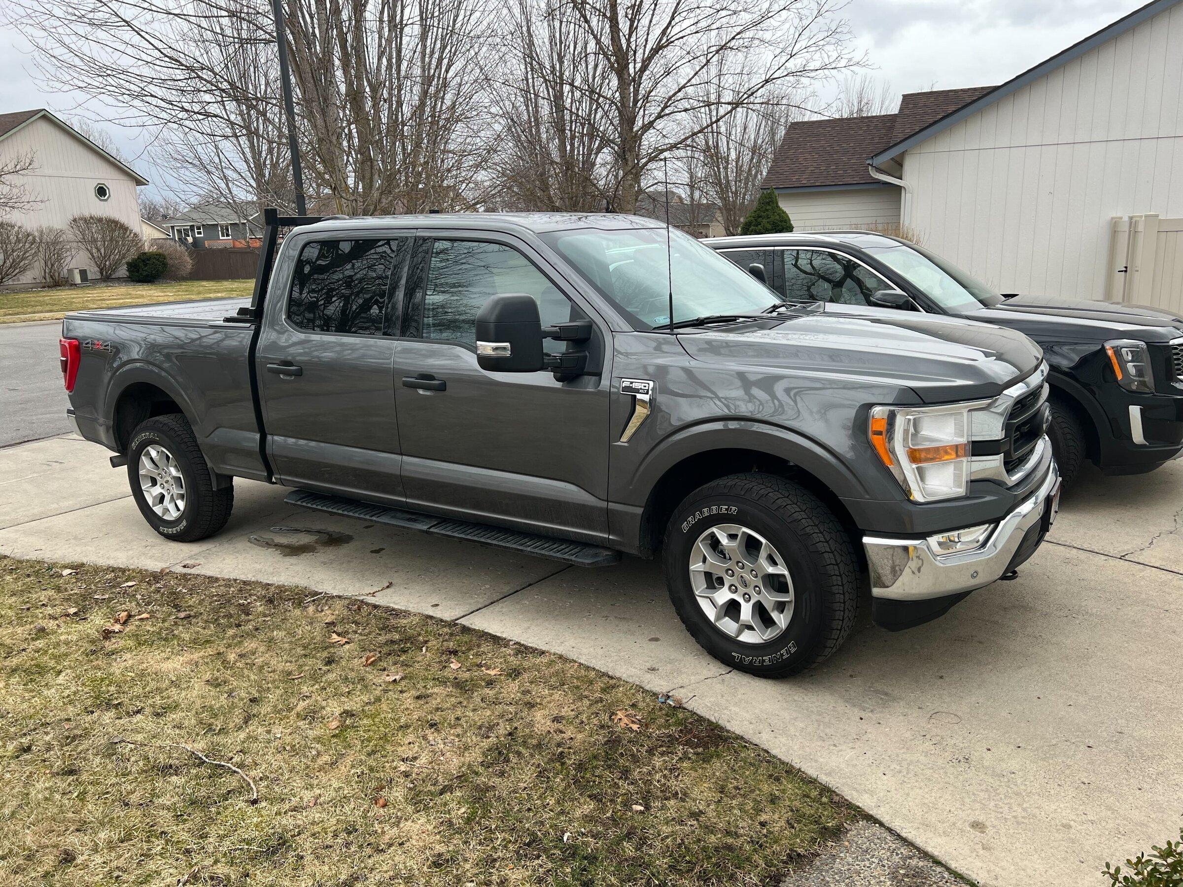

With me (fat guy), tonneau cover, headache rack, console safe, and car seats.
Ford F-150 2021 F-150 Payload Stickers Screen Shot 2022-04-20 at 2.31.33 PM
Glad I have some payload to spare for the trailer, family and camping gear!
