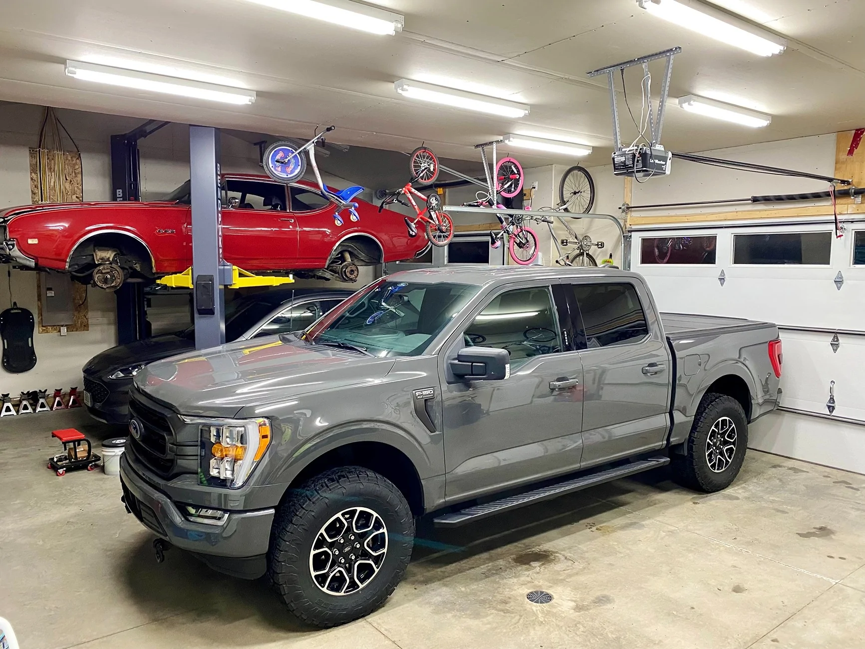

I ran 35x12.50R18 Toyo ATIII's on my stock 18" wheels on a 2.5" level with no spacers for an entire winter and had zero issues.
Ford F-150 2.5 Level with Ready Lift UCA's 51756392914_2901464112_o
