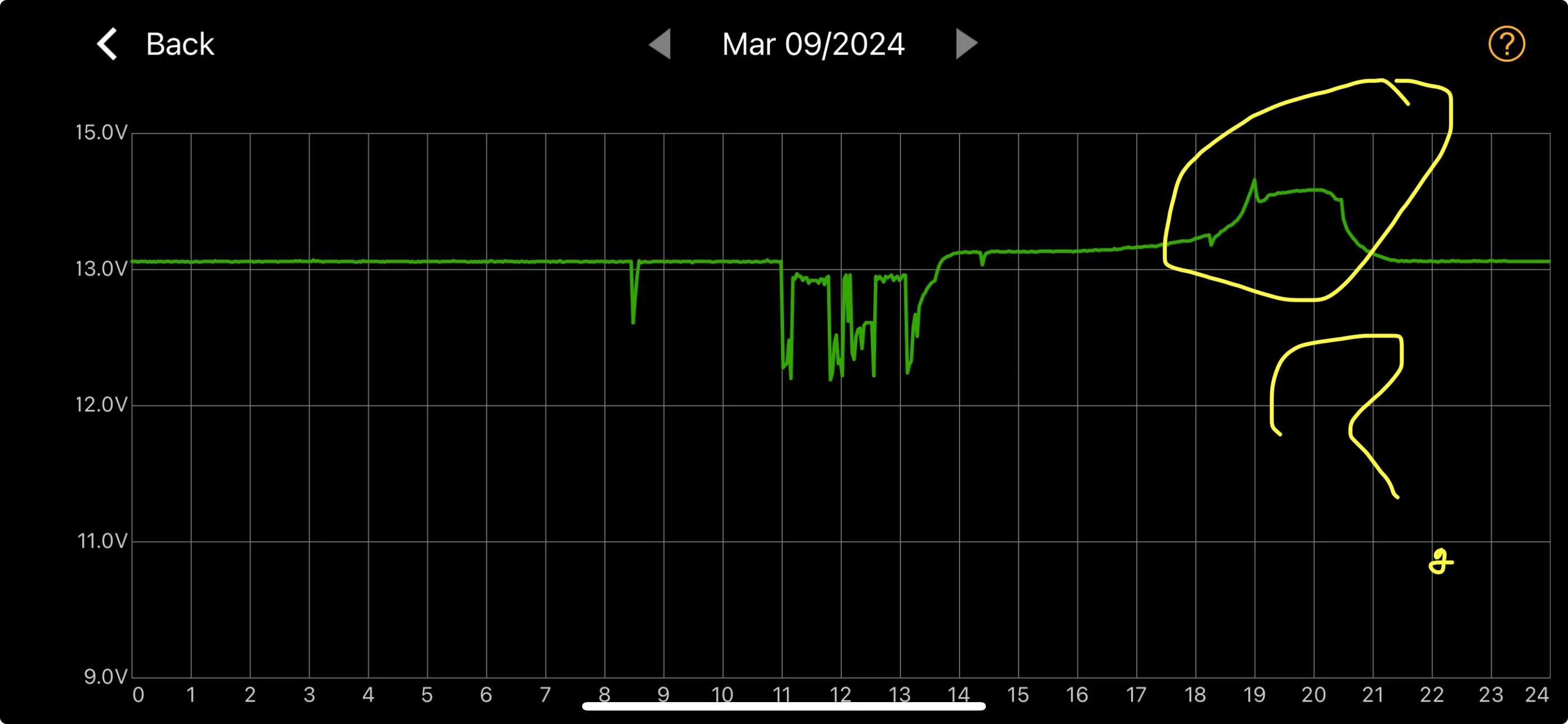

Captured this battery voltage vs time graph on my truck with a blue tooth battery monitor. On a jr. battery tender in the morning… activity from 11am to about 2pm I had it out doing errands. Back home parked and put back on the jr. tender. Not sure what is going on between 6 and 9pm… any ideas?

Updates?
