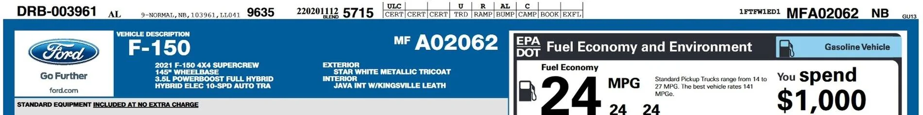

Ok, you ask for it so here it is. No the DRB # is not the order the trucks are built.
The blend number pool for P552 (the F150) goes to 10,000 and then rolls. This is not plant specific, so blend numbers are assigned out of the same bank for DTP as KCAP. As a vehicle (VIN) is assigned to the build schedule, a blend number/rotation number is assigned. It is THIS order that the vehicles are built. When the truck is built, then the blend number/rotation number goes back into the pool. When they reach 9999, they start reissuing the blend numbers from the start (0001) again.
So, in a nutshell, blend/rotation numbers are a pool of reusable numbers assigned to vehicles that are used to determine order of build because vehicles are not built in VIN order.
With this truck, it had a blend date of February 4, 2015 (20150204) and a blend number of 5104. The 5104 is the sequence number for this truck as it was built going down the line.
Now they reset don't forget when it get to 9999 and go back to 0001. So it doesn't mean they have only built 5,104 trucks so far. It does mean they have built at least 5,104 trucks. You have to know how many times it has reset.
Ford F-150 Window Stickers Explained 1605731764323
Now this is my window sticker. The date built Nov 12th and the sequence number was 5,715. So we know they have built at least 5,715 trucks. This counts KC and Dearborn.
Ford F-150 Window Stickers Explained 1605732058424
There, clear as mud??
A blend number is nothing more than bank of numbers assigned in numerical order to a vehicle when it's scheduled. For the F150, it's ~10K numbers from 0001 to 9999 The trucks are built in order of blend number. 3456 is after 3455 and before 3457.

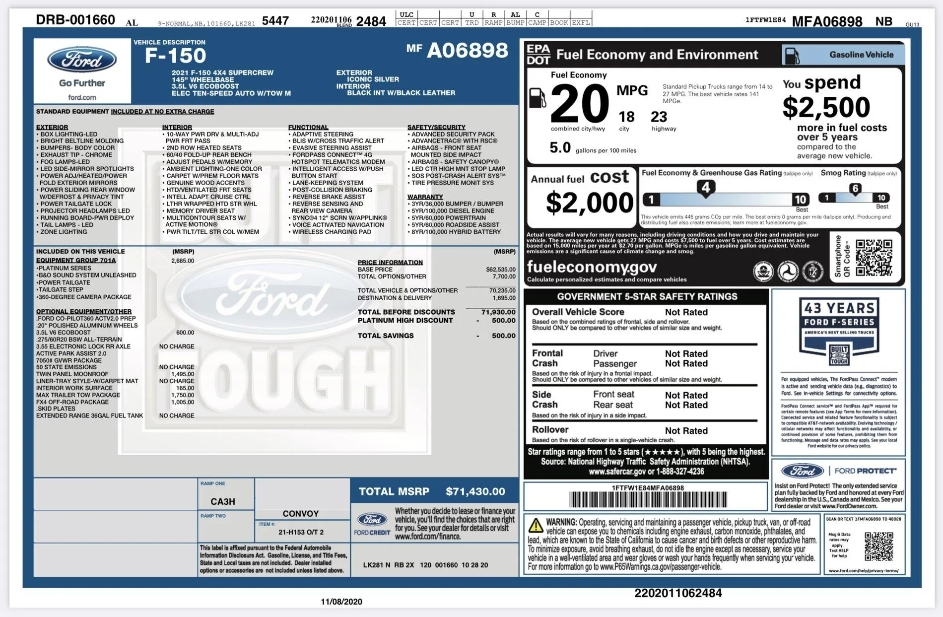

Just got this window sticker on my order. Can you tell me what the status of this truck is at?
Thanks/
Shows schedule to be built 26 May
