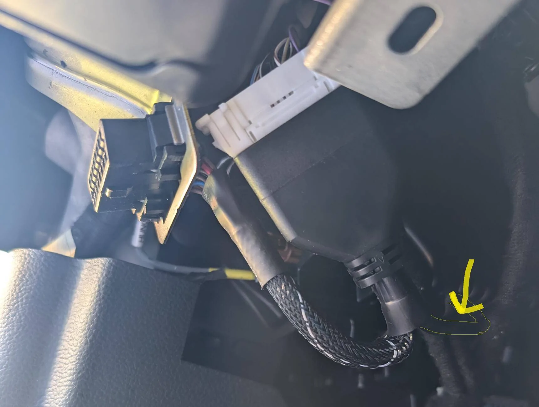

There is definitely something inline with the OBD-II port (I assume the white connector is the factory OBD-II connector)
Hard to see on the photo, I outlined it in yellow and the arrow points to it, but there is a cable going back under the dash, I can't seem to bend myself well enough to see exactly where, but I assume that's where the rest of the tracker is mounted
Ford F-150 Will PLAD tech GPS tracker run my battery down? PLADtech
I think I'd have to remove the panel to the left and under the steering wheel to gain full access to it, although I may try tugging on the wire and see if I can fish what's there, if it's not zipped tied to something.
I can probably find instructions on how to remove that trim panel, but isn't it close to where the airbag is mounted?
I can start by unplugging the black connector from the white one and mount the white one in the bracket. That should hopefully cut power to the tracker but maybe not, it might be powered separately. I will definitely make sure that there is no foreign device between FORscan and my laptop though.
I have downloaded the app for the tracker so I suppose it should be pretty easy to see it it registers when my truck moves.

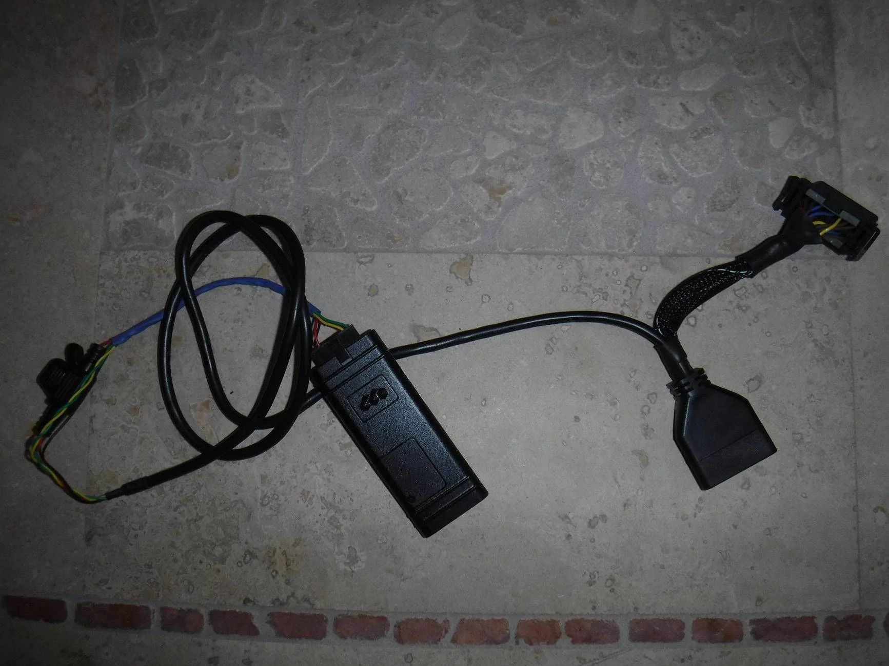

I found a picture of what I believe is the same tracker. Looks like no separate power, it draws power from the ODBD-II. I'm guessing the little thing on the left is a fuse?

I would unplug the black connector and remove that from the bracket. Reinstall the white, factory, OBD2 connector into the bracket. The side panel on the dash, I think, is only on with clips. A gentle steady pull should remove it. You could try following the smaller cable and see where it goes.

Side cutters work once you disconnect it from the white OEM connector.

once I disconnected it from the ODB-II port it became easier to tug on it and get the hardness out. The unit itself (the rectangular box) is zipped tied to something and I didn't want to risk snagging sone other cable, soi I unclipped the harness connector and left it in. Maybe I could have had some fun with the SIM card in it, but I'm going to leave it at that for now.
