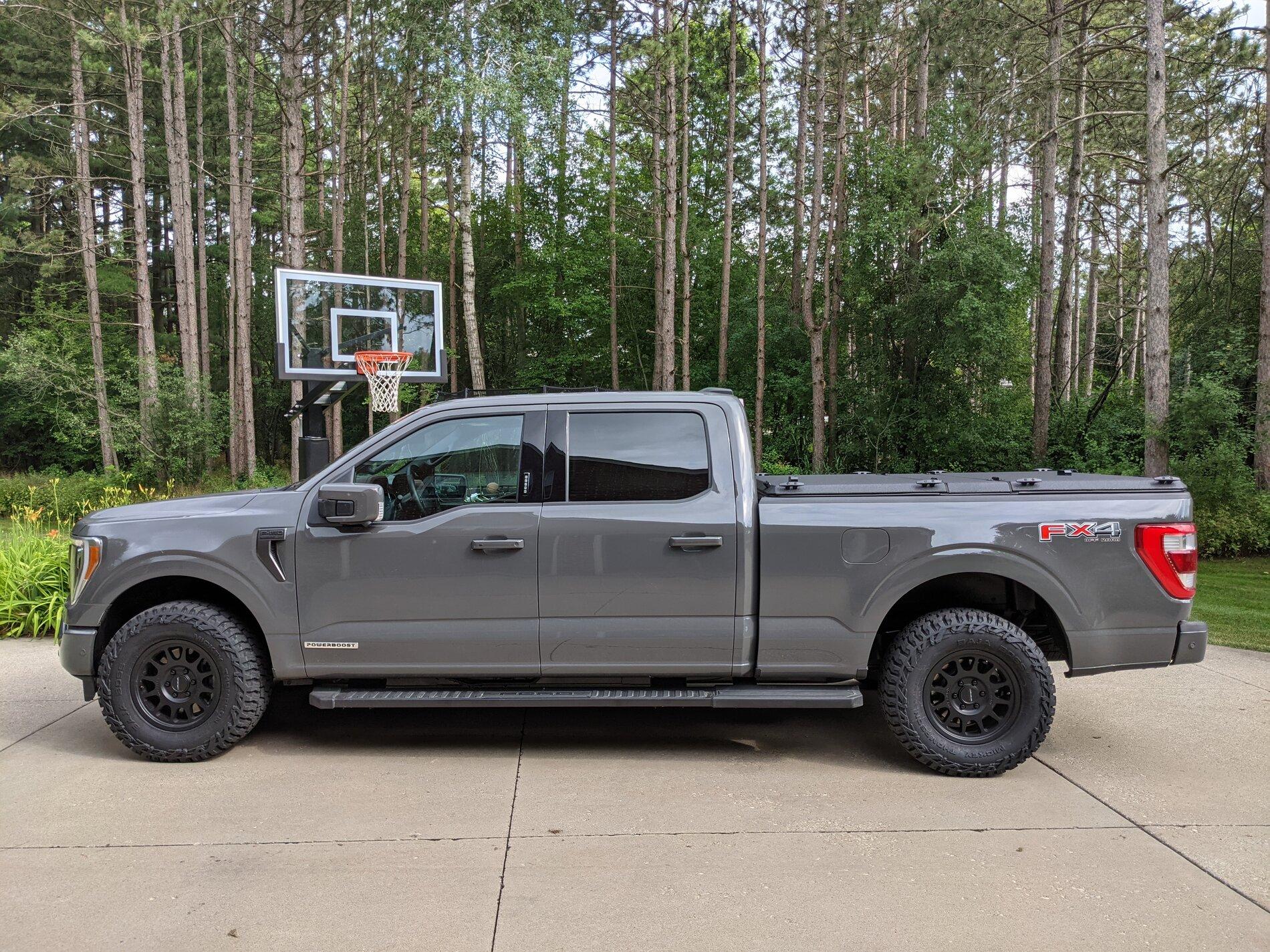

Don't know if this helps, but a 17x8.5 +25 wheel and 33x12.5R17 tires will fit with no level or lift.
Also, FYI, on my truck +25 offset and 12.5" tires stick out about an inch.
Ford F-150 Will it fit 20x9+1 w/ 33x12.50? PXL_20210625_213839492
Ford F-150 Will it fit 20x9+1 w/ 33x12.50? PXL_20210625_213846433
Ford F-150 Will it fit 20x9+1 w/ 33x12.50? PXL_20210625_213907390
Ford F-150 Will it fit 20x9+1 w/ 33x12.50? PXL_20210625_213950764
