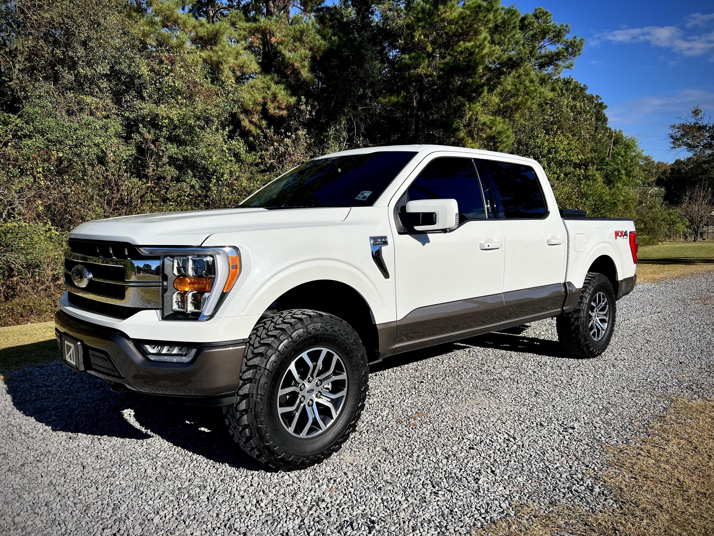

Easily, as long as they aren’t 12.5” wide (which still may be okay). I’ve run 35x11.5 on 3 gens of F150s now and this 2022 has the most room. No rubbing whatsoever in full lock either direction.
Ford F-150 Will 35s fit with 2.5 level ? 3EC12EC8-6DEE-44ED-9F12-D93C0EB1A855
