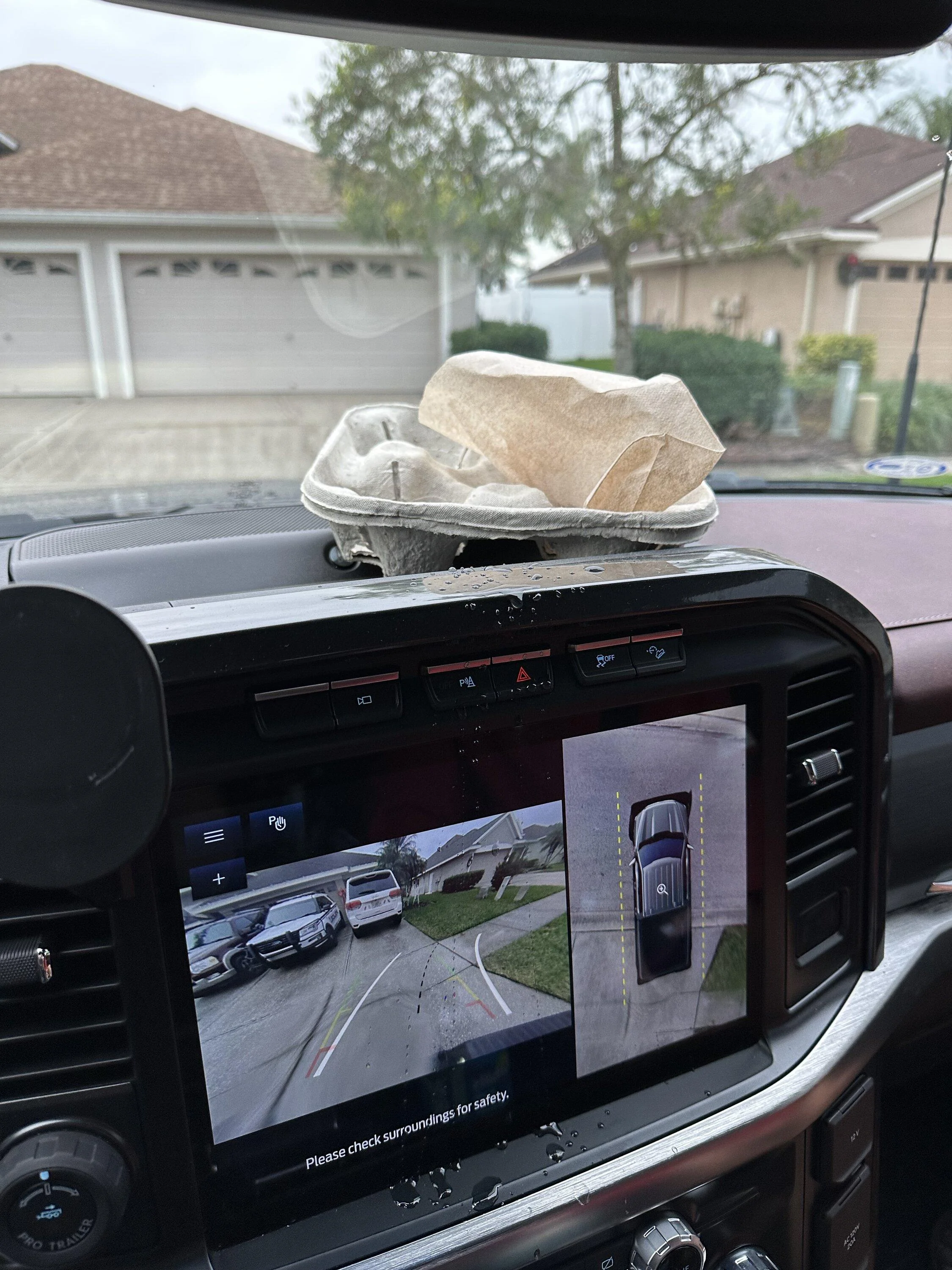

Had my truck parked in the driveway as level as possible with the factory rake and it rained pretty good. Went to leave later that night and saw some water dripping from the overhead console/rear view mirror.
I couldnt tell exactly where it was coming from but it initially thought the pano roof. However from other posts mainly on Facebook those leaks are near the a pillars and come out of the sides not the direct middle. I poured a lot of water in the open pano roof track at the front and the drain sucked it down to the ground without any hesitation or much buildup which was direct poured, not slipping though the seal of the window glass.
Others suggested from the windshield as there’s been issues. I haven’t found much information on a windshield issue. Don’t want to have a ruined $70k truck that can’t handle some rain as im FL and I’ll have to get rid of it before summer rolls around if that can’t be fixed.
If it is the front seal of the pano roof im not opposed to a new seal being put in that prevents opening. I mainly use it to roll the sunshade back that’s it, opened maybe one time in 6 months.
Ford F-150 Water dripping from overhead console F9C0E8ED-0181-44F8-9D41-C096EAB7E6C6
