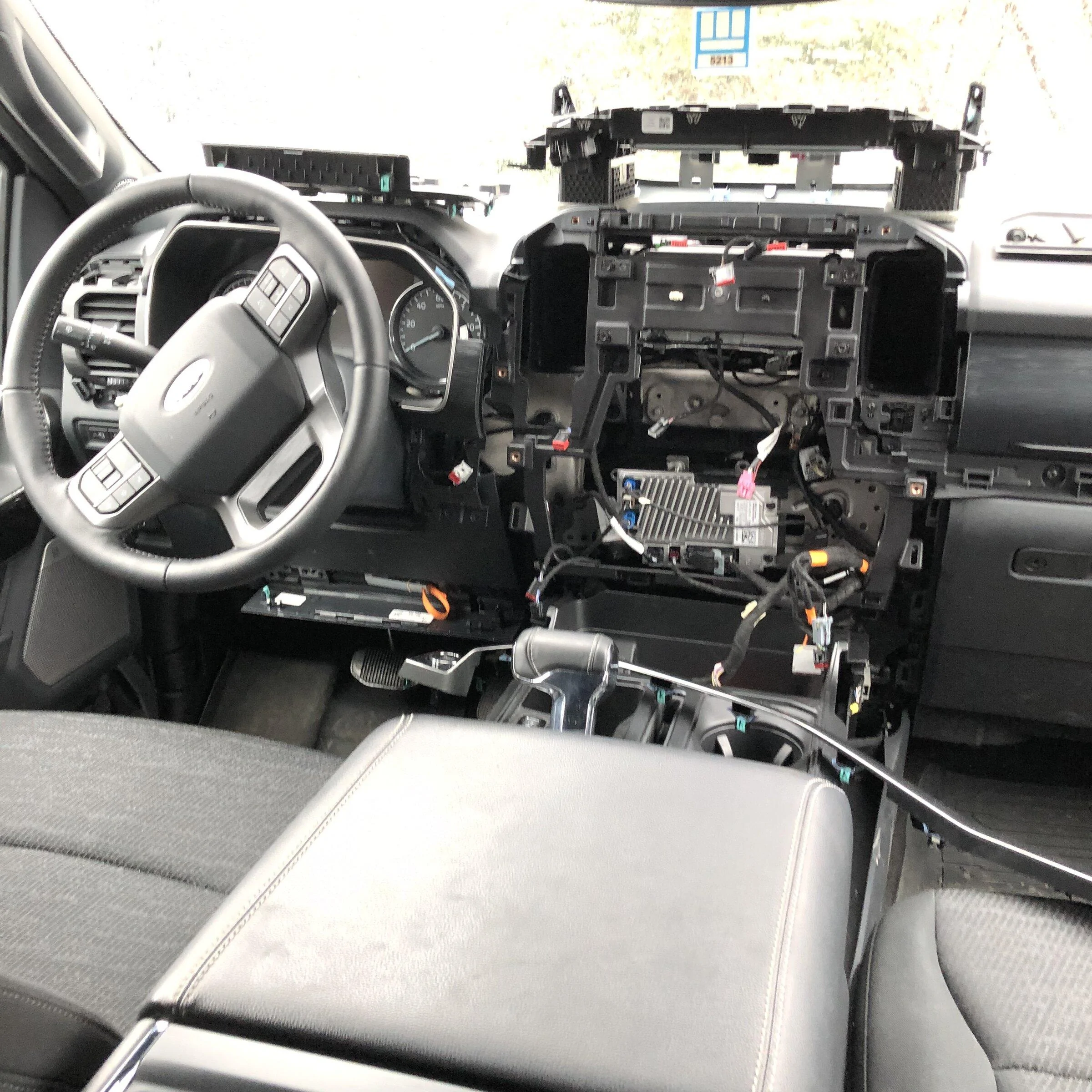

This sounds like the same problem I had. Dealer found a broken wire in the harness that connects the PCM. Attached is the notes from the technician.
That dealership better do whatever it takes to keep the technician who discovered the issue.
We're running out of troubleshooters like that and we are at the mercy of module replacement technicians and those who are waiting on Ford "to get back with them"
That guy would get a gift certificate for a local steak house from me.
