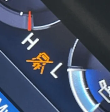

This symbol started popping up on my 2023 F150 and I haven't been able to find out what it means. Anybody know what it is?

Pre-collision Assist not available. Check all sensors and radar are clean / unblocked. If it persists, either read DTCs for more info or it's dealer time.

I'm having a hard time making out the symbol. But if I go by your IPC type, The light that sits in that location is the "Forward Collision Warning RTT Indicator"

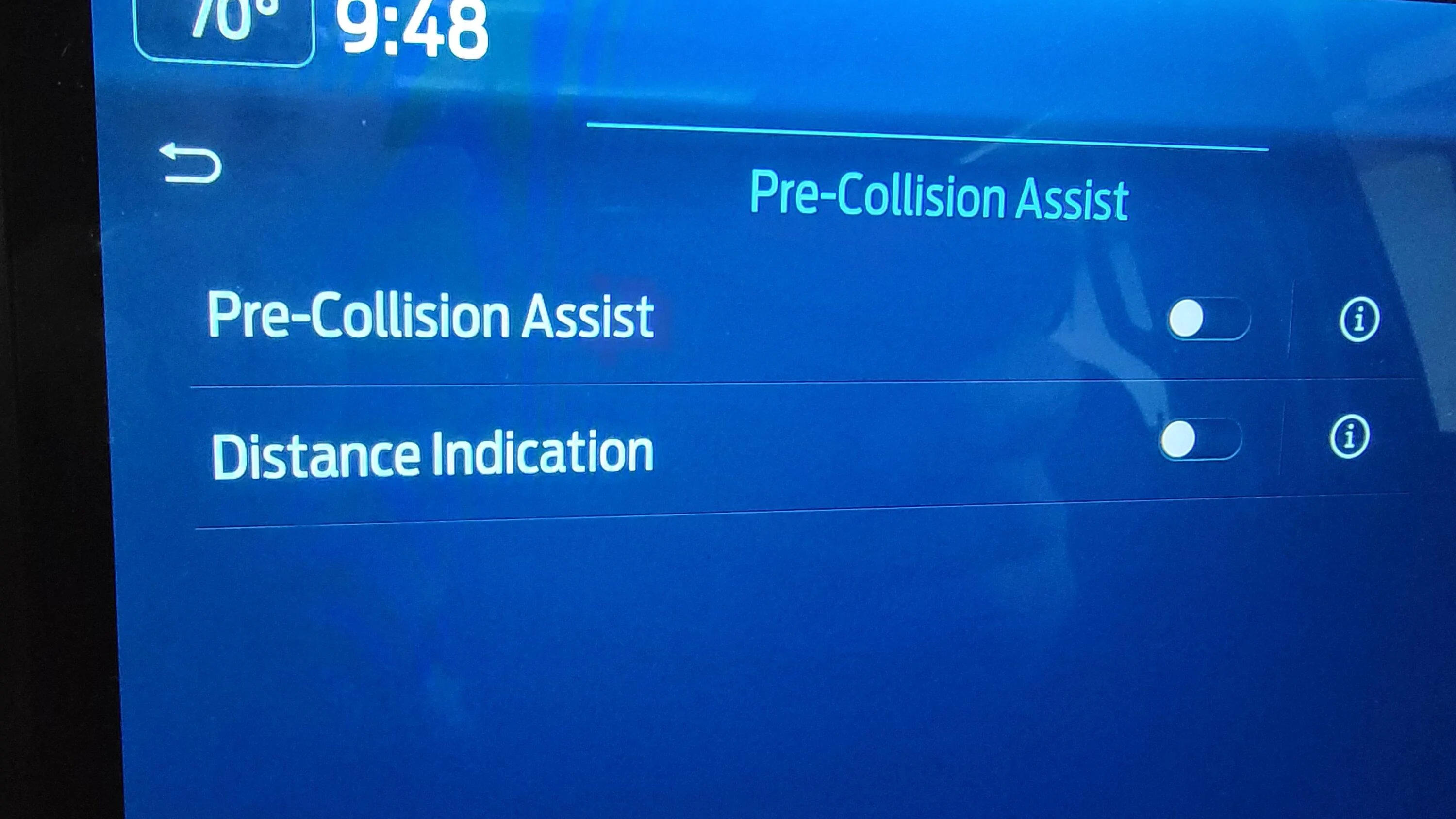

It is your pre-collision assist in the disabled mode. To re-enable it and have your symbol go away go to:
features>
driver assistance>
and turn the first one on and it will go away
I actually keep mine disabled

Thanks, I'll try it. I do have mine disabled and keep it disabled. I actually like to drive my truck rather than have the truck drive me. This is ajust another unnecseeary feature, I have built in Pre-Collison assisst called eyes and reflexes.
