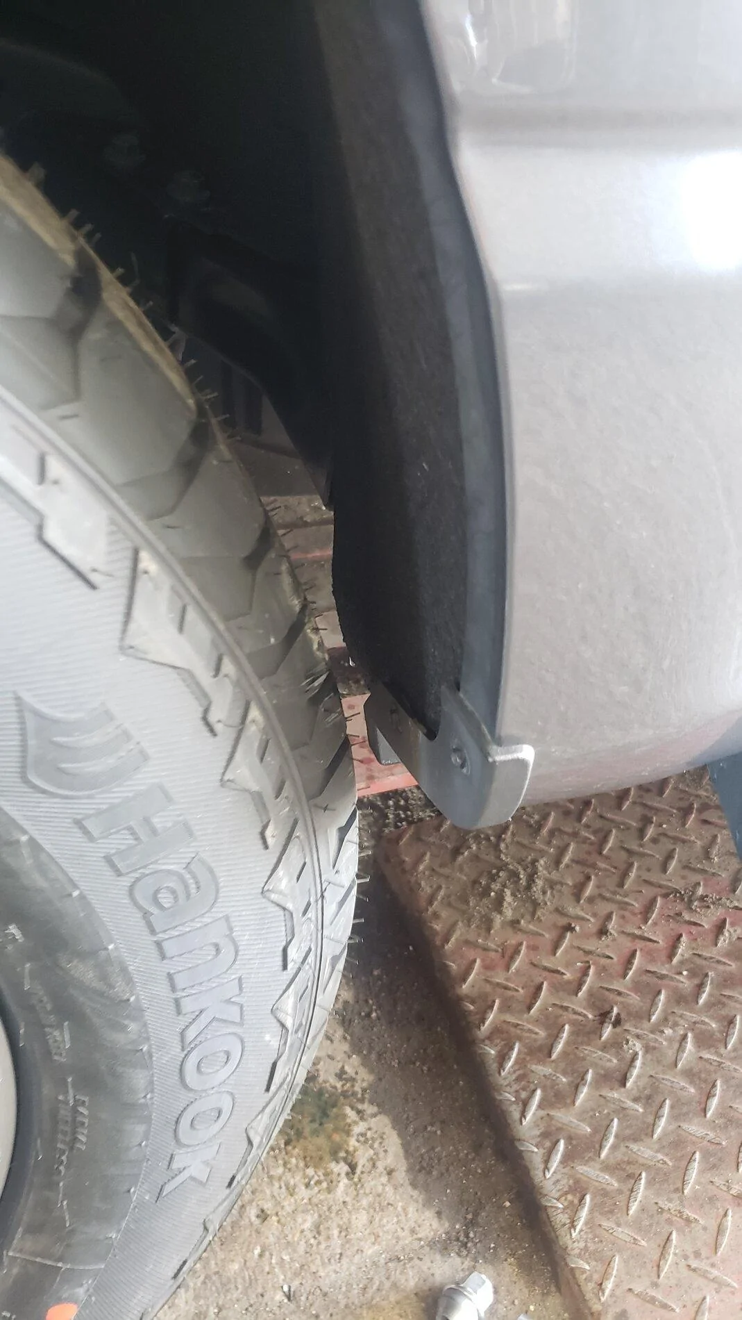

Tried 295/60/20 with 2" level..no luck

Tried the Hancock At2 with no luck, they rubbed the crash bars ?
Ford F-150 Tried 295/60/20 with 2" level..no luck 20210227_144356
Ford F-150 Tried 295/60/20 with 2" level..no luck 20210227_144406

Ford F-150 Tried 295/60/20 with 2" level..no luck 20210227_144352

Which leveling kit and what size wheel and offset did you go with? Are those Fuel Rebels?

Ready lift 2" , blitz wheels with +1 off set. 20x9 Yes, the same wheel tireguy has. I think the offset will limit my choices.
Bummer cause it looked good....for 2 minutes

Yes, looked good! I was considering that size wheel (Fuel Sledge) and that size BFG KO2 (or maybe a 285/65/20). I'll probably go with the Falcon tow/haul kit, which is a 2.25. I wonder if the 1/4 inch will be enough. Maybe I'll have to stick to the stock wheel.

I think its the offset that is the biggest problem. If you go 2.25 the distance doesn't change much from the Inner fender to the front bumper/valance. If it set out more then it would change a bunch of things. I know some guys take the crash bars off, I personally like safety features but when I was a bit younger I wouldn't think twice about it.

I decided to get the wheels and keep the factory tires for a bit. Probably going 285/60/20
Ford F-150 Tried 295/60/20 with 2" level..no luck 20210227_170959
