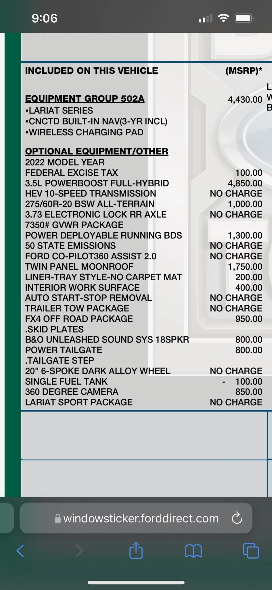

Totally agree, I happen to have a high tolerance for risk and low tolerance for BS. Also of note check out these Canadian trucks, of course built in the US. Tow Tech is not an option on a 701a. You either get Trailer Tow for no charge or you can upgrade to Max Tow. Also included a 502a sticker. Seems to make alot more sense in line with Ford's own literature and hard to believe they would be splitting hairs on any components that would upgrade the towing capacity 4k lbs from one country to the next.....Again next time I order a high trim F150 will not get trailer tow and if I find myself in the spot that I need it will get max tow or an F250.

I can't argue with you, except to say that you really aren't raising anything new that hasn't been covered pretty extensively in other threads. But I'm glad we have choices. I have a low tolerance for risk and consider the $1095 I paid for the trailer tow package to be cheap insurance, even if it otherwise has no practical value. When shopping in a depleted market last year, I passed up on several trucks with only the tow tech package. If faced with the decision again, I'd make the same one, for the reasons I articulated in another thread. But, again, that's me.
