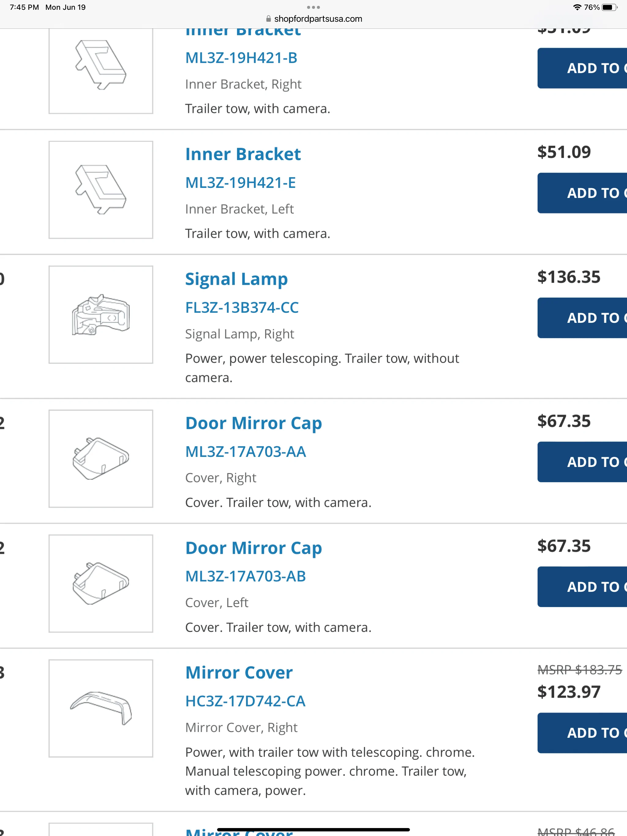

I looked that part up it’s readily available from Ford. But it was 70.00 with 16.00 shipping. I figured that the cover shouldn’t just fall off so let Ford pay for it.

Does anyone happen to know what the part number is for this price of plastic camera cover. Apparently mine were borrowed from my hotel parking lot. Looks stupid without them. I have looked on the parts lists as well as contacted Ford and so far I am bien told that I have to pay for new mirrors as the caps are not available separately.
Any help is greatly appreciated.

I was able to get it separately since mine fell off. I’ll check to see if I can find part number.

That would be greatly appreciated, thank you

This should be a good starting point. I ended up supplying the part number. Used a flexible proxy to glue the new cap on.
