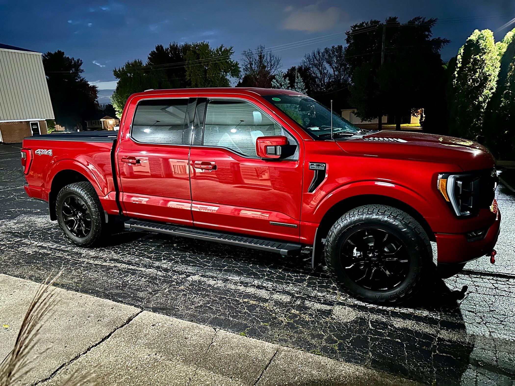

285/65-20`. Not sure if they will fit without a level though. They are taller than my stock raptor wheels that I run in the winter.

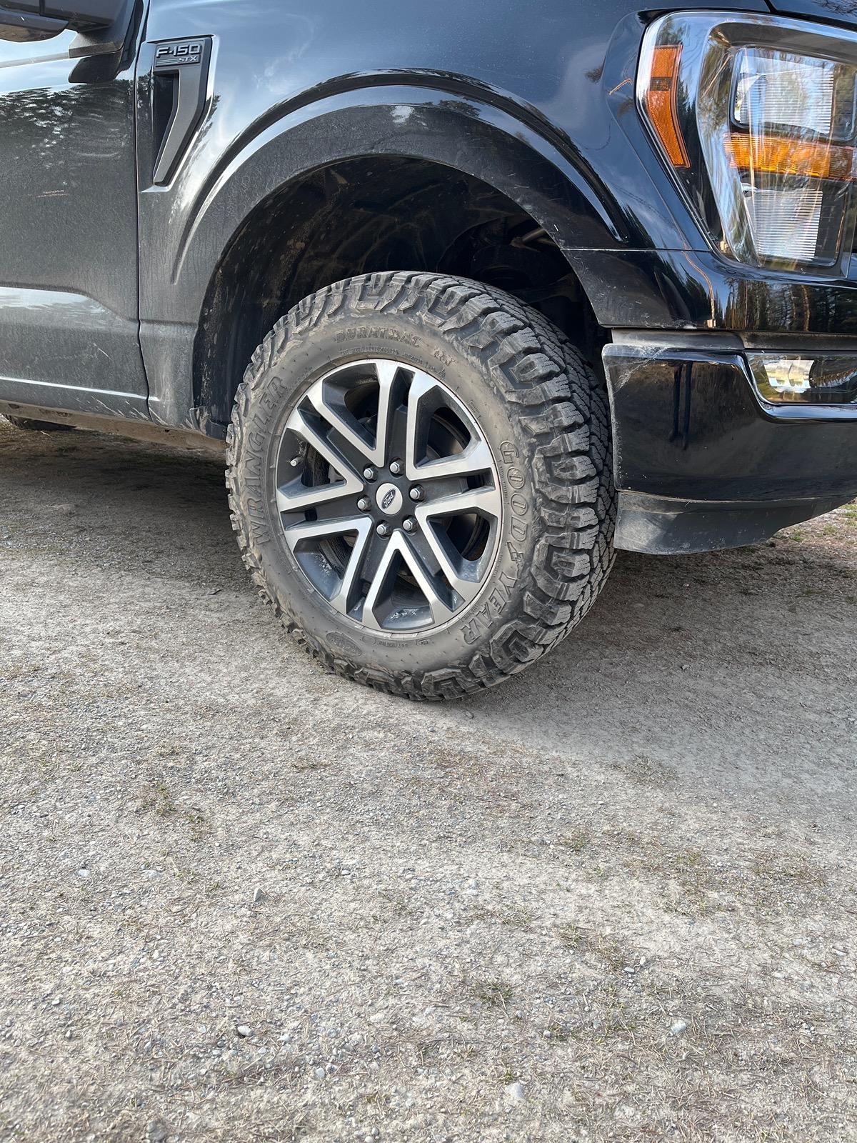

275/65R20 with Ford Performance leveling kit although I think you would be ok without it. Plenty of room.
Ford F-150 Tire size for more sidewall? image

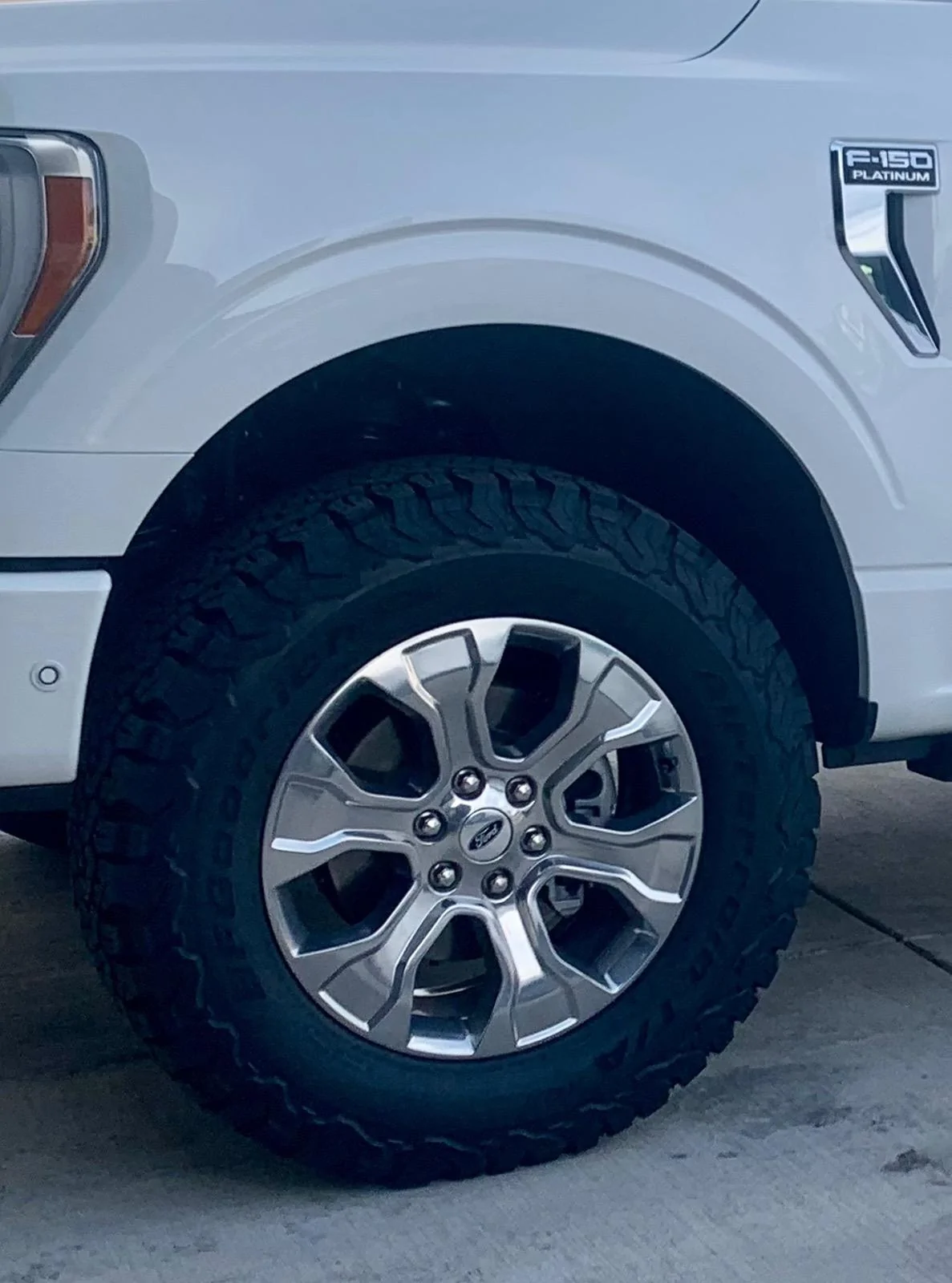

You can run a 275/65/20 without a level or lift and it won't rub. I run this setup, it's a 34" tire and Im completely stock on the suspension/wheels.
You are pretty limited on options in this size. Going wider means a level kit, though some people run 285/65/20 without one. YMMV on this setup.

275/65/20 Nitto Recon Grapplers. Stock suspension- no rubbing:
Ford F-150 Tire size for more sidewall? IMG_4641
Ford F-150 Tire size for more sidewall? IMG_3559
Ford F-150 Tire size for more sidewall? IMG_3567
