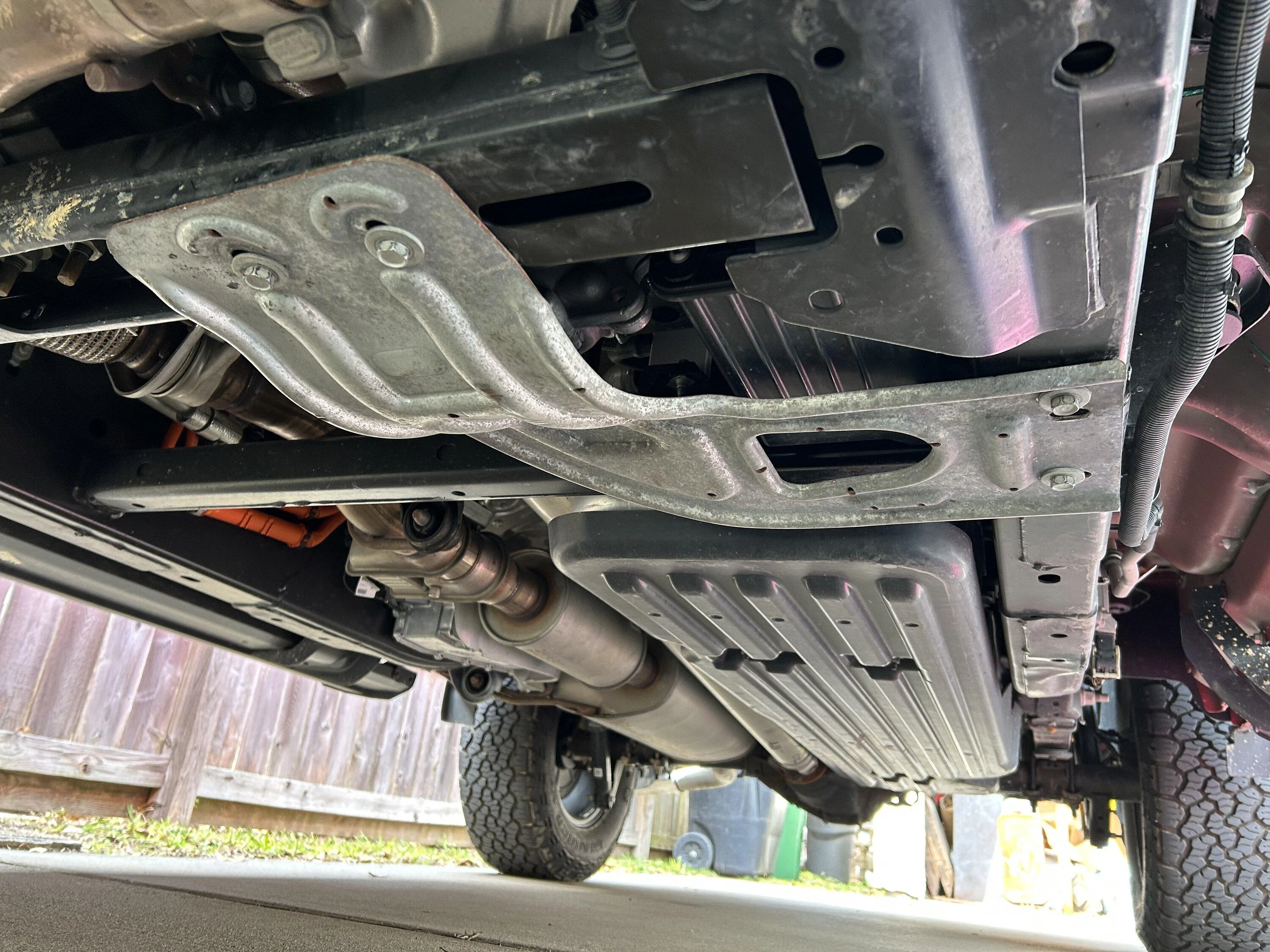

No luck trying to find and compare part numbers. So will the stock metal FX-4 skid plate and transfer skid plate from a Supercrew Ecoboost or 5.0 fit a Powerboost? Thinking a cheap take off set may provide slightly better protection than what’s on there now.

I have the FX4 Powerboost and will be taking my stock ones off soon. They are used and scratched and dinged but still line up and bolt on no issues. Would let them go cheap if interested

Since yours is a powerboost we know that they would fit! Still wondering if other FX4’s would fit. If nothing turns up locally, I will reach out. Thanks.

Found a local set of 2021 FX4 skids off a 3.5 and can confirm that after removing the mini skid plate and fiber shield, the front skid bolts right up to a 2022 powerboost using existing hardware. The transfer case skid was not a direct bolt up though. It looks like the transmission crossmember is 1-2 inches further back on the powerboost. If you use the front two bolts, slide the transfer case skid all the way forward and turn it a little counter clockwise the rear bolt hole to the frame rail will just line up. Drilled a new hole in the skid for the forward bolt to the frame rail and it is secure.
And for what it’s worth the fiber pan under the transmission off the 3.5 is identical to the 2022 powerboost.
