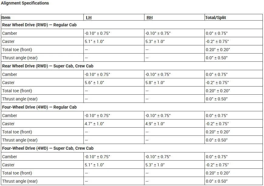

Depending on where you go they may not have the specs for 2021+ F150s loaded into their alignment computer yet and they are very different from the 2015-2020 F150s. I've attached the 2021+ specs in case you need them. When possible, it's always better to set caster to the high side of the allowable range and I like to run roughly -0.8° of camber on both sides.
Ford F-150 Steering Stabilizer on leveled trucks? 2021 F150 Alignment Specs

Thanks. I go to a reputable 4x4 shop and actually asked about the Gen 14 alignment specs when they aligned it a year ago. They said they have them loaded into their computer but I don't think they set the caster near that high. Makes sense. Feels like shopping cart wheels when you hit a big bump at 70 mph.
