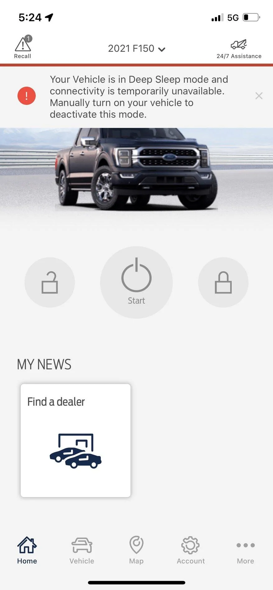

I was traveling for a week. I noticed in FordPass while I was away the truck went into deep sleep mode after only about 2-3 days of not being driven. When I returned and started the truck this morning, I got an error on the main dash cluster that said "State of charge 12v battery low." The truck drove fine, but when I stopped it the large screen showed the following message (below). That issue eventually went away. I obviously shouldn't have this problem after only a week. I already received the OTA upgrade that addressed phantom drain, so I'm wondering if that damaged the battery before it was fixed.
Is anyone else still having these problems? Any thoughts are appreciated.

So I am getting a truck in Deep Sleep mode after I haven’t touched the tuck for 3+ days. It’s happened 2x now when I come back from a trip. I see this message in the app, but never see anything on the screen.

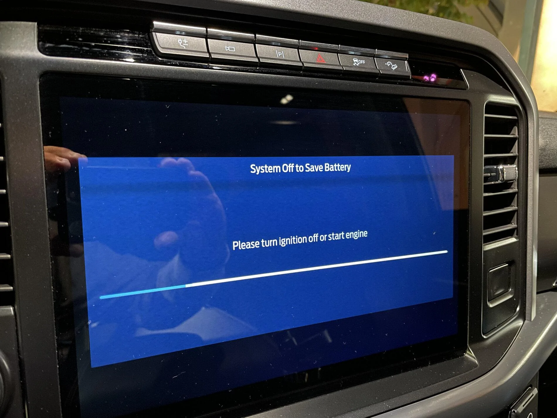

Listen to stereo and about every 25 min, this shows up on my 8” display.
turn key off, turn key back on and I’m good for another 25 min.

I purchased my truck 12/18/2020..
I keep getting the Deep Sleep Mode message on Ford pass.
Says start manually to clear message.
That never works.
I've uninstalled app.
I've removed vehicle from app and added it back.
I've started the truck a number of times.
Nothing gets rid of it.
I'm guessing early build it's a bad battery, any ideas??
