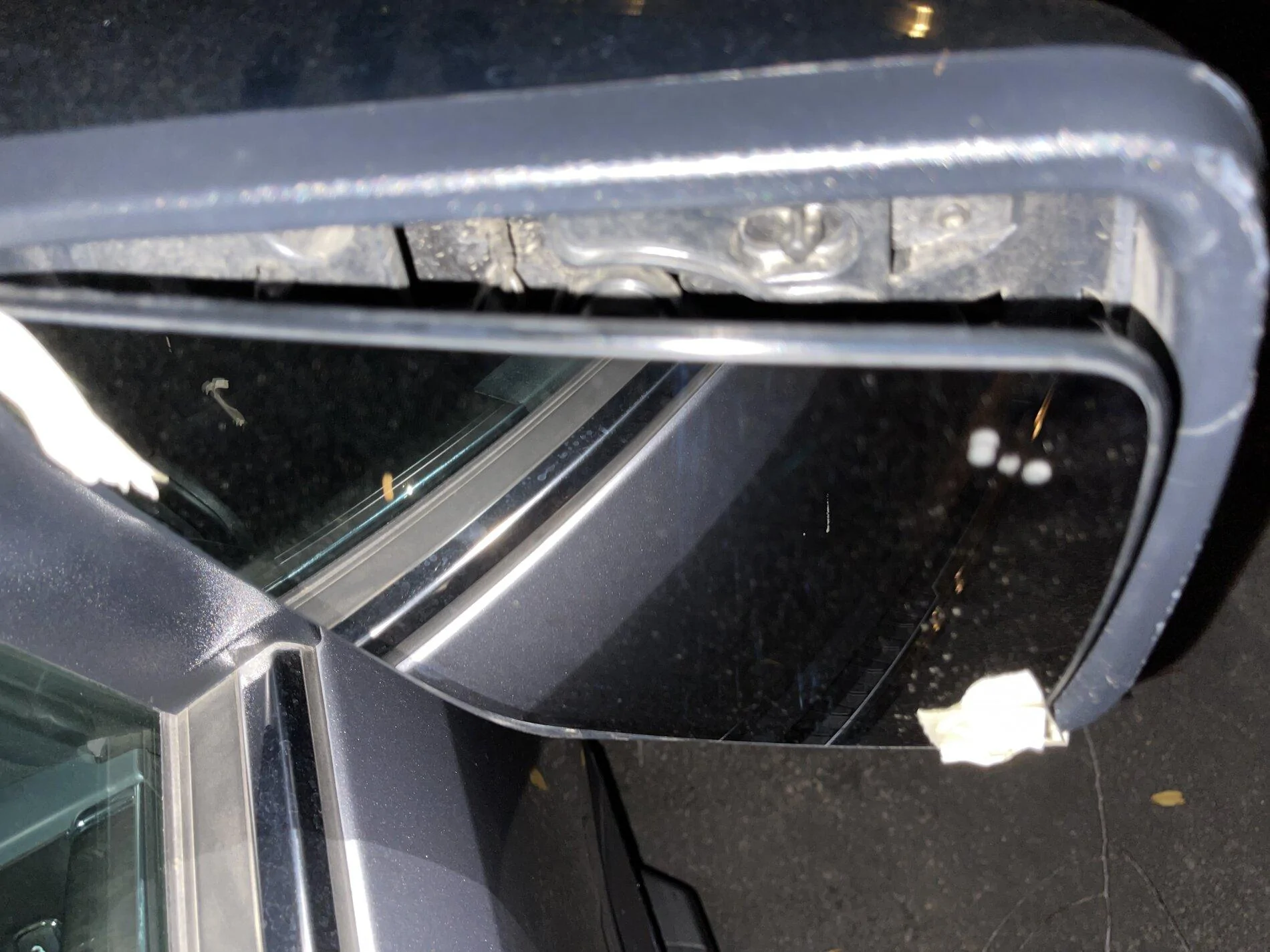

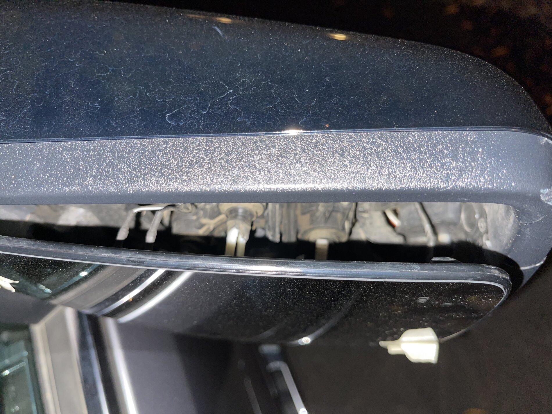

So my F250 psgr side mirror had a close encounter with a parking garage post. The external housing is fine; the mirror itself is barely hanging from a couple of pieces of plastic used to change the mirror angle. Body shop says I need to replace the entire mirror housing for $1250 + labor. Seems like overkill to me; just need to re-attach the mirror to the plastic mounts and (possibly) replace the plastic mounts.
Thoughts? Is there a reasonable way to go about this w/o replacing the entire thing?

The mirrors have 4 bolts?? and a connector to remove. It is all located under the sortof triangular cover on inside of door that pops off. You can order a new mirror and change it yourself in 15 minutes for way less than the money they are quoting. In fact some people have changed out their stock mirrors for trailer mirrors and only spent a few hundred bucks for a new pair. Maybe someone will have a good mirror to sell you. Don't let that body shop screw you! Price out a new one at Ford parts counter but make sure you are clear what options are on it like blindspot display, heated, puddle lights, etc as there are a few different mirrors that go on these trucks. Might be Ebay mirrors available cheap that are import copies. Good luck!!!

Dumb question - can you just pop it back in and have it hold? I caught another mirror with mine and the glass popped out and was left hanging by the cables. I just lined it up and pressed it back in and it held, but none of the fasteners were broken on mine - the mirror just came unclipped.
