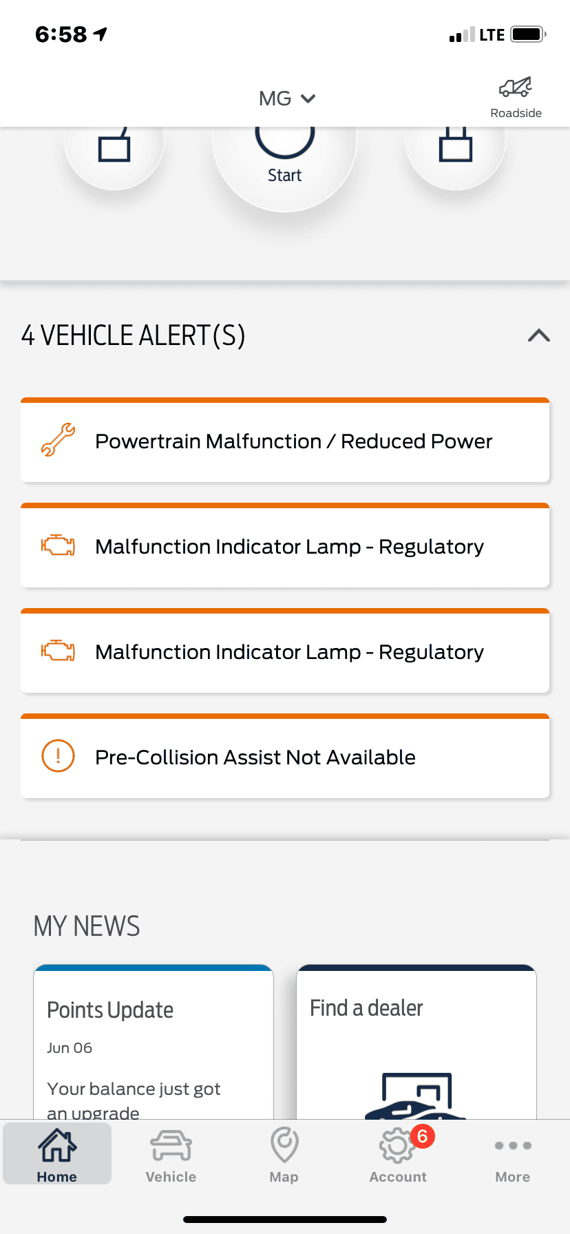

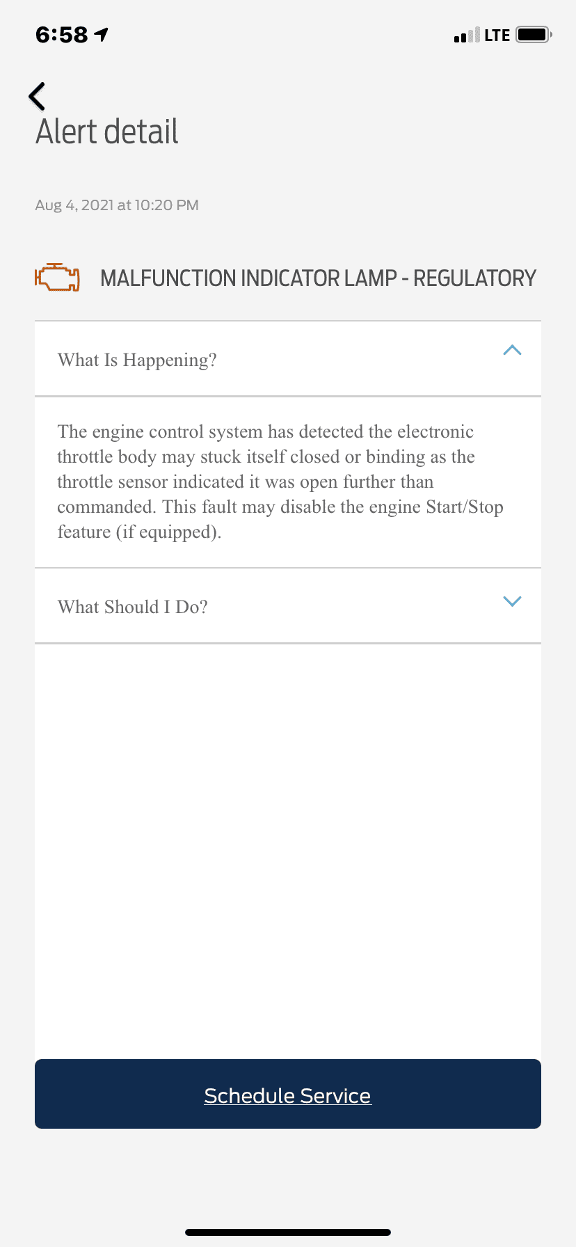

I bought my 21 F150 Lariat on 5/15/21. Loaded down truck that I love. 4x4 5.0L power train
My last F150 I bought was in 1998. Still going strong.
About 1,000 into owning the truck I started getting all kinds of errors and low power modes on the truck. I could pull over and power down and back up and it would drive at full power again.
Showing throttle body sticking issue. Brought to the dealer of 4 times so far. Throttle bodies are on a nationwide back order. Now almost two months later no resolution. I’ve escalated it to Ford with a case number. Really no help. Dealership doesn’t have any loaner vehicles, so now I’ve got a $60k plus truck that runs sometimes and sometimes not.
how can I escalate this higher with Ford. I’m to the point now, just give me my money back. Seeking advice
codes thrown pics Attached
