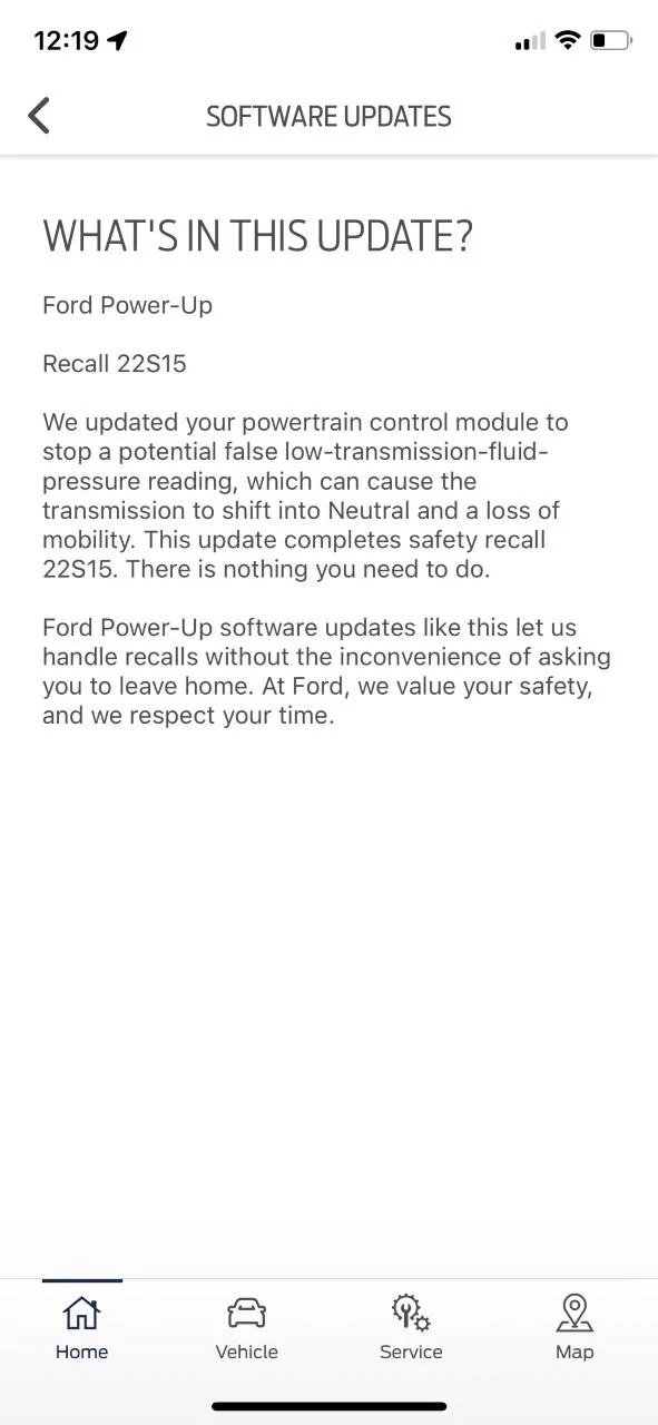

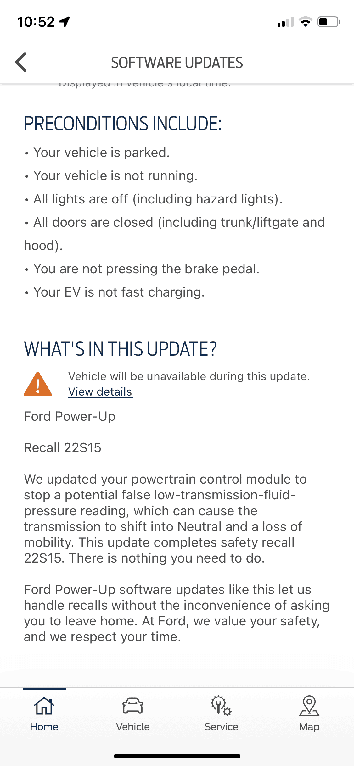

So I just received this update via Ford Power-up update and I have a 2.7 WITH auto start-stop on my vehicle. I also want to note that I never received any notice of this update prior to this morning before it updated
