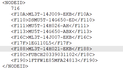

I fixed it this morning. Seems FDRS uploads and modifies your As-Built after your initial Network Scan. It uploads changes made to module configurations as well as SW revisions of your modules. In my case, the GWM SW revision got corrupted during scan (or upload):
Ford F-150 (RESOLVED) FordPass - SecuriAlert, OTA Updates dissappeared 1642468975157
All I needed was to launch FDRS and re-run network scan and that corrected my As-Built SW revision info for GWM:
Ford F-150 (RESOLVED) FordPass - SecuriAlert, OTA Updates dissappeared 1642469071450
And voila! OTA and SecuriAlert is back in business!

Great you got it working. Where did you pull those config files from on your PC?
You can pull your As-Built either from PTS (if you have access to it) or motorcraft website here. I managed to save a copy before GWM update so I had data to compare against. Took me a good while to figure this out...

i think this was an isolated case caused perhaps by network disturbance (by weak wifi signal to my laptop) or a bug in FDRS software. Don’t know for sure. Should you get such issue as described in OP, a simple network scan would fix it
So if I download that as built file how do I upload it into FDRS?
You can’t! FDRS submits all HW/SW revision info automatically at the end of network scan
