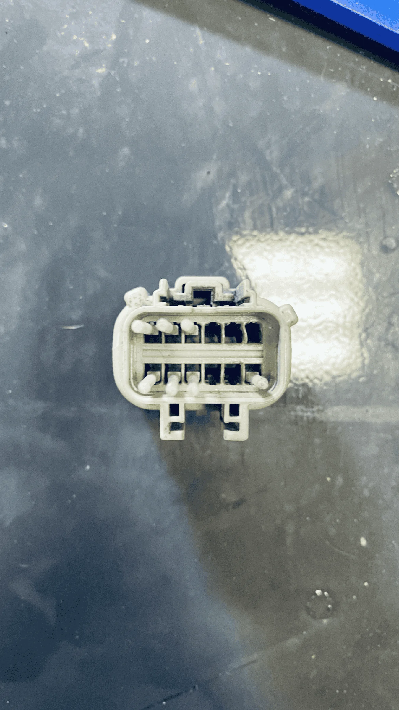

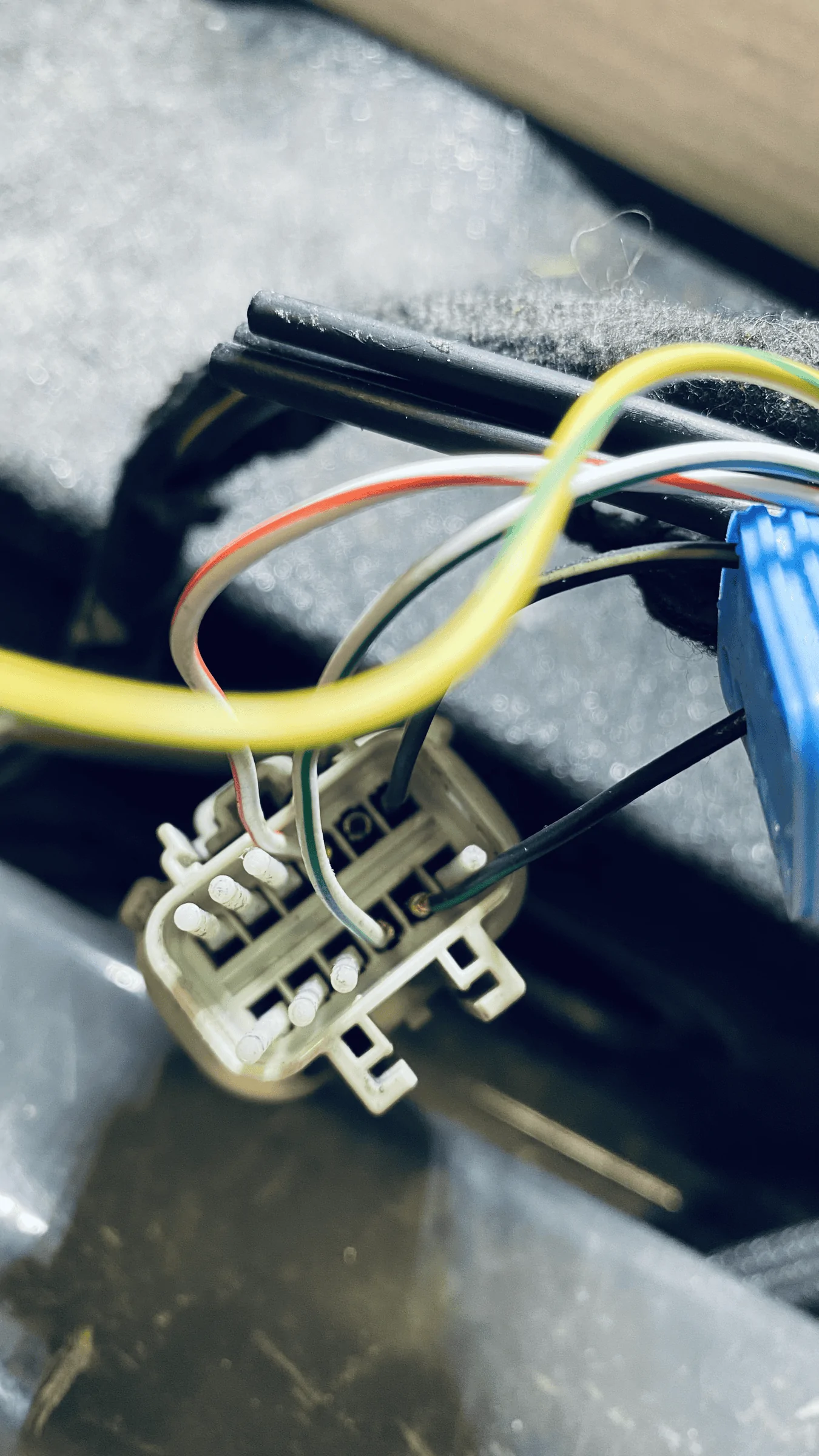

Hi all,
Had an incident with my tailgate coming off recently, pulled the wires out of the 12 pin harness connecting my rear tailgate locks. The 2 other plug harnesses are fine, only function I have lost is the auto lock feature.
Anyone have a link to the wiring diagram for the 12 pin?I have searched for the past few hours, no luck. I have 2 out of the 5 wires in the correct place.
Trucks trimmed XLT 302A High
Thanks in advance, some photos below for reference.
