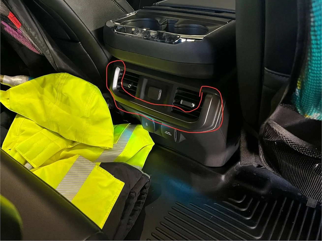

Hoping someone can help me. I am trying to remove the circled trim in the attached photo. Even if I can just get it out with the vents attached it would be great. Any help would be appreciated.

To get that apart is a pain in the ass, I did it to steal power from the rear power plug.
There are screws under the rubber cup holder,, and screws in side the console storage, then you have to pull the cup holder up it is in with clips, not easy to do. That showed where more screws are. When that is all done the rear panel where the vents are is held in with clips.from there I assume you can remove the vents but that is not something I did. Good luck.

Ah ok so basically work down from the cupholders? I was hoping it would be less involved but is what it is i suppose.
