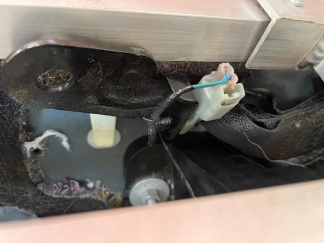

Hoping someone may have run into this issue and has a fix. I removed the rear seat from my 21' crew cab to make more room for our two Huskies when we go camping. Now I'm getting a "The restraints control module has detected a fault with the second-row center seatbelt buckle sensor" error.
Any suggestions on how to resolve this fault short of reinstalling the rear seat?
You must detach the seatbelt receptacle from the center seat and plug it in.
PS: I left the single seat in on the passenger side.
