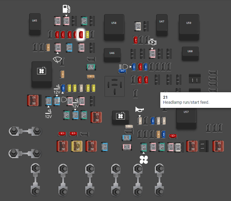

I purchased 4 grill lights and would like to make the power connection in the fuse box in the engine compartment. What would be the best fuse # to tap into to have the lights come on when the power is turned on? I don't want to tap into the wiring harness because warranty issues since the trunk is only 3 months old.

F21 is a good option. It is on when engine is on...only downside is it will not turn off with the headlight switch. The only way to turn it off is to turn the engine off...Its the row of 10A fuses, and 1 20amp fuse, its the one right next to the 20A fuse.
https://www.startmycar.com/us/ford/f-150/info/fusebox/2021
