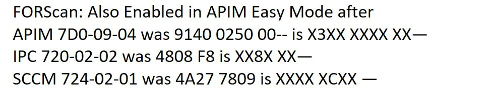

Check FORScan and also see if its enabled in Easy Mode and on Sync.
Here is mine for MY2023 302A from Rain Sensing Wiper Upgrade | F150gen14 -- 2021+ Ford F-150, Tremor, Raptor Forum (14th Gen) | News, Owners, Community, Discussions
Ford F-150 Rain Sensing Wipers 1721525559325-wz
