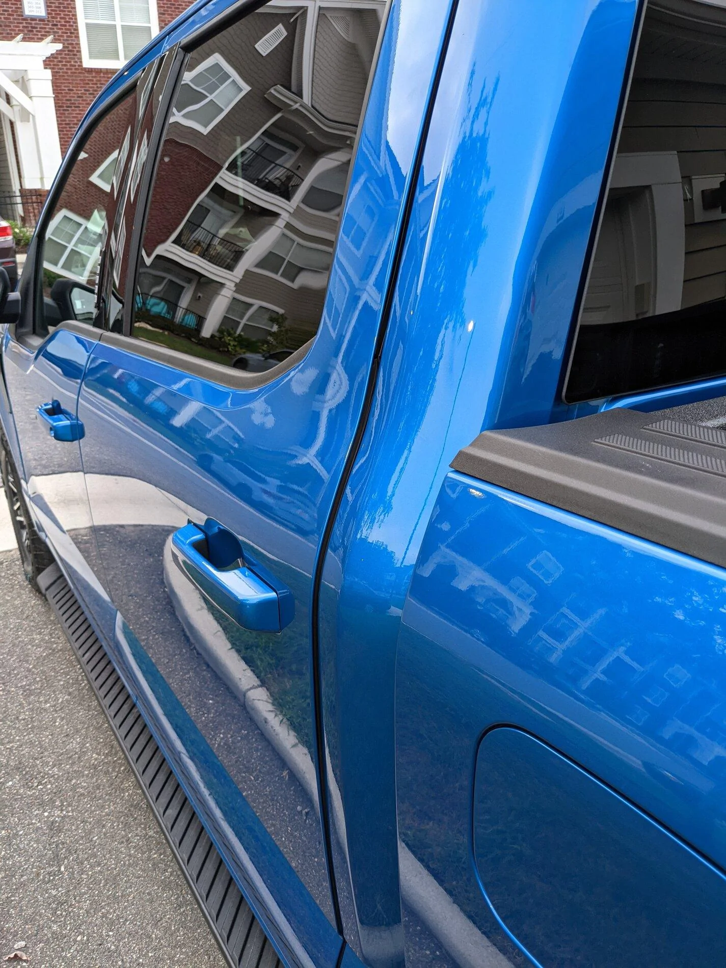

Dent/scratch on passenger front door

Dent on black trim on passenger door

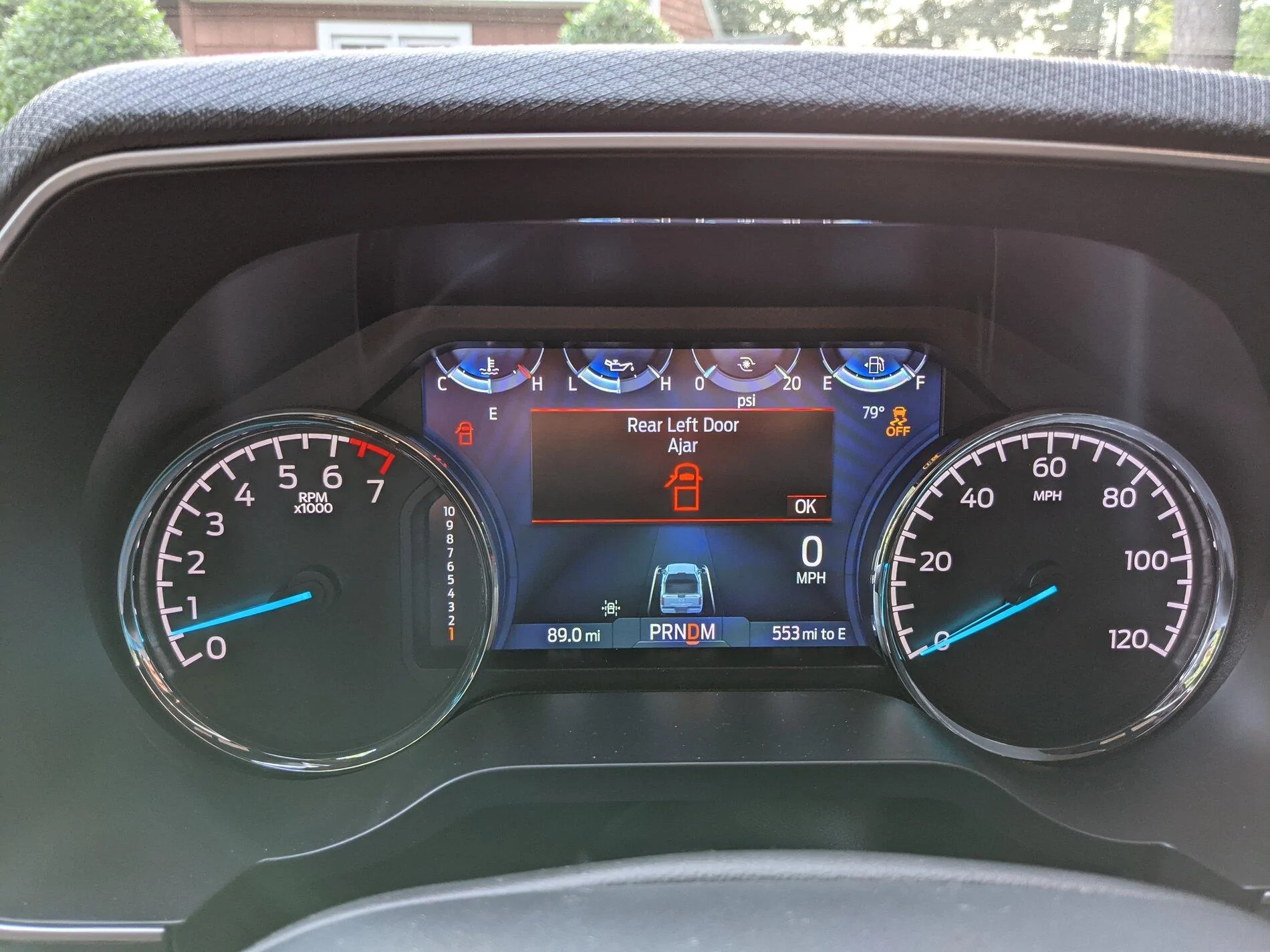

Driver’s side rear door is hard to close and “door ajar” light on often

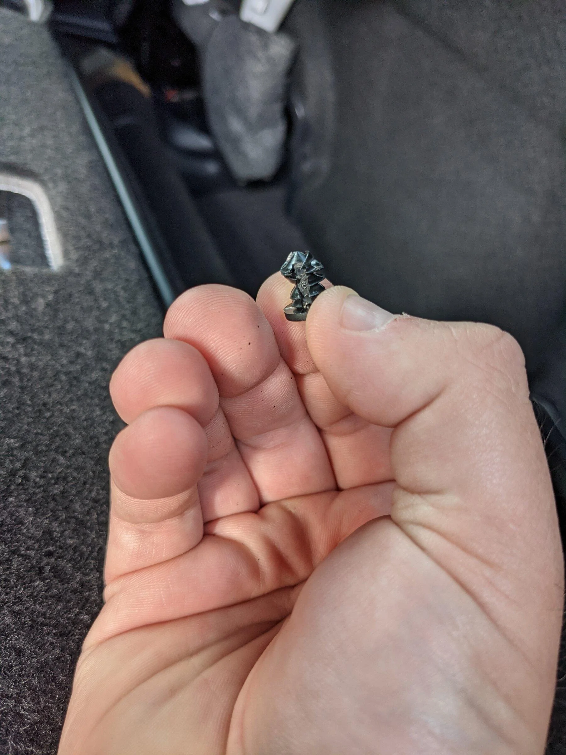

Seatbelt brackets not aligned properly and plastic push rivet not in position
